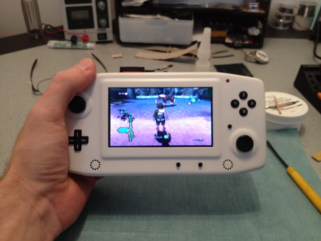

Its actually a little bit larger length and width wise than it needs to be, the reason for that will be revealed in the next model.
GameCube Fusion Rev. 3
Yea, I know I'm supposed to be working on my Wii laptop, which I am.
However its been too cold here lately for me to be out in my garage doing bucket loads of sanding to the case. So what better to do than have a few projects going at once. Here's a sneak peak of the work I've got done on the Revision 3 Fusion. Its the size length and width wise of a PS Vita and will be 1 and 1/8th inch thick. 5400mah batteries. Yea.

Re: GameCube Fusion Rev 3. (Sneak Peak)
Fantasic work dude
The length and width of a PSV?
Wow.
I didn't know the PSV was such a monstrosity!
Very nice work. Looks mass produced.
Wow.
looks incredible..
makes my revision 1 fusion look so dated now
nice case design...
another one. you're killing me
damn it.. i want to build a portable, too.. but i suck at case-modding/-construction xD
And i have no screen either ^^
But f*** great work! I love it
Ashen, you should buy a better camera. The picture quality does not justify the incredible awesomeness I've just seen.
