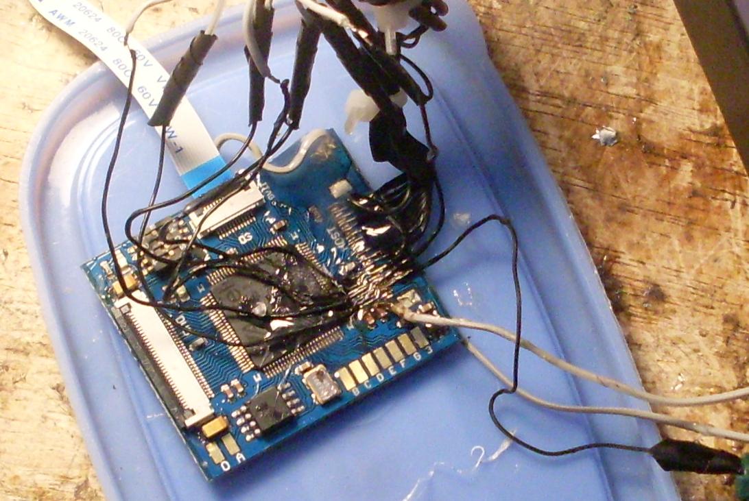

Post by zhou9562 » Wed Oct 03, 2012 1:47 am
Panasonic Q GC DVD connector pads
must Welding to ffc board

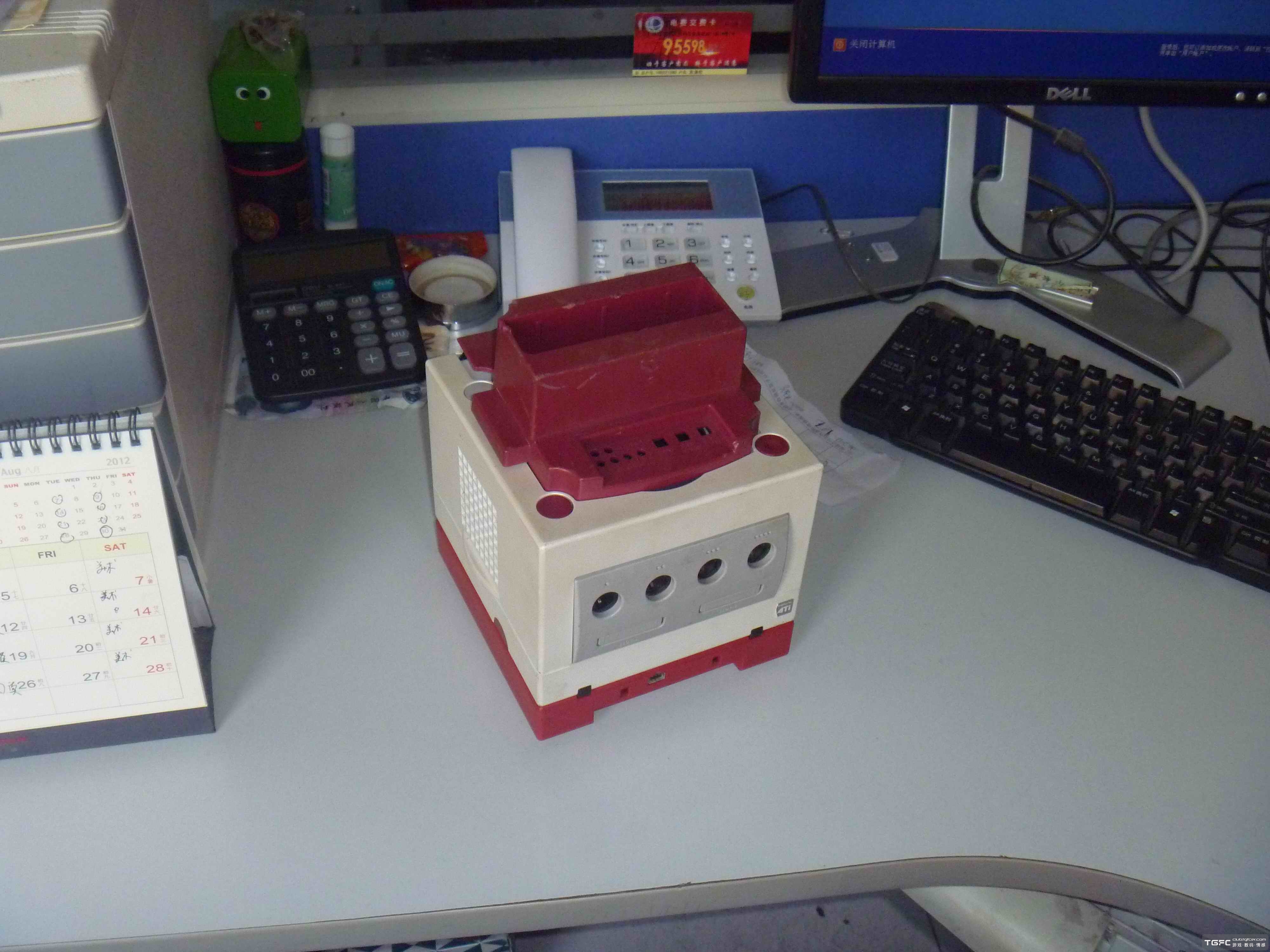

bearteam
Posts: 152
Post by bearteam » Fri Oct 12, 2012 1:09 am
The red switch is a self locking switch.
IPL1.0, NTSC-J.

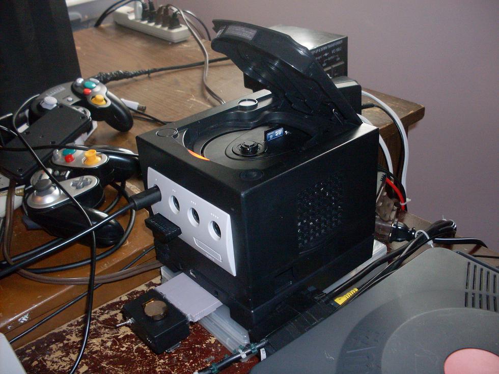

Post by Gamerlolwind » Wed Oct 24, 2012 6:55 pm
my GCP in it's current state: (near completion)
19/10/12
HISTORY!
well, why you say?
i received my commissioned modded gc from Ashen, whom i had sent my stuff to him to mod for me, as i cannot do such stuff successfully,
list of my gc's features (credit goes to Ashen for the awesome modding):
1) Wiikey fusion wired to GC
2) Bottom Ports Removed (space saver!!!)
3) Slot A removed/ Slot B extended with wires
4) Memory card 1 (1028 blocks with some of my saves) wired to Slot A.
5) trimmed gc motherboard, Minimalist GC cut (huge space saver!!!)
6) extended controller port 2
7) Cut/Modded controller for Player 1.
8) SDPT switch for the gc disk lid switch for Multi Disk games
9) Added an Eject switch type needed for wiikey fusion.
10) Replaced Original powerboard with a custom regulator of 7.4v and wired to system's Heatsink
11) Replaced stock GC fan with a PS2 fan & wired it's cables to system.
12) Added wires for Shockslayer LM368 Audio amp (GND/+5v/L audio/R audio) for easy wiring to the amp.
13) Kept AV's Yellow plug for connecting to screen's yellow plug for video.
14) extended the Output port for external (out) for AV or RGB to TV.
15) Replaced GC control stick with the control stick of the super pad 64
16) used Digital tact switch mod for L/R buttons
17) Added Gamecube Bios battery holder for easy +3v Lithium battery input.
which he did a FANTASTIC job, may i say
im SO happy, my portable is like to 95% now.

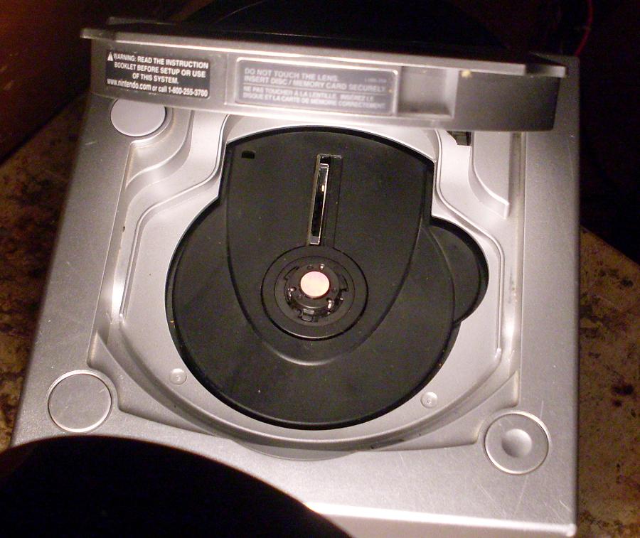

Post by Duhasst0 » Tue Apr 16, 2013 7:30 am
WIP for sure. I am just waiting to build a programmer for my xenogc to make my wiikey fusion gc into a xenofusion gc. Give her a paint job or go out for a full size dvd case. Haven't decided yet. I would use the xeno flash utility but its been a whike since I really worked with anything I don't think it woukd turn out.
Got a suggestion on what to do from here let me know, I am definitely adding leds for the xeno and wkf. Just having brain farts on what to do.
