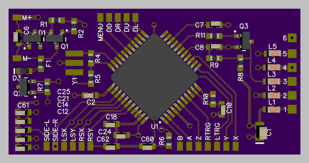

Finally finished up the core work of this mini Wired GameCube controller board. It's only a new PCB for the parts on the existing wired GC controller.
3D render of the prototype board.

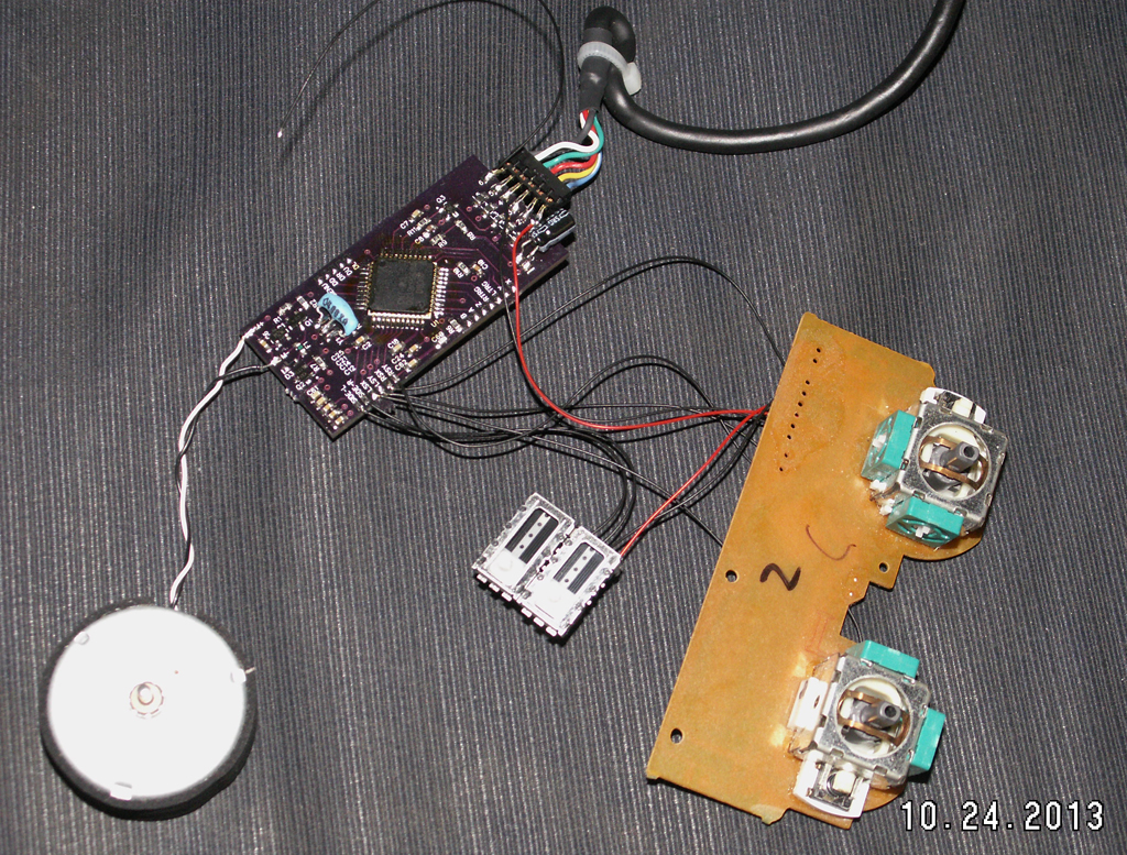

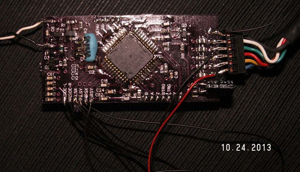

Then after it was made and most of the parts swapped over from a donor controller.
The prototype there is missing quite a few things, mostly decoupling caps, but also a couple of solder pads for the Analog voltage power and ground, couple for the Ground for the button pads and it needed a footprint change for Q3. They weren't necessary for a first run, and I was interested in getting the prototype done quickly for testing, but they have all been placed on the final revision of the PCB. The prototype there also has the larger Resonator and C1, which will be swapped out for the smaller SMT versions. Some of the wired GC controllers already have the SMT Resonator, but this one didn't.
Some Sticks, Trigger sliders and the motor wired up for testing.
Everything works like it's supposed to. The PCB is 25mm x 50mm, so it's not quite as small as the miniDS2, but not a heck of a lot bigger either. All of the parts were kept on one side so the PCB also.

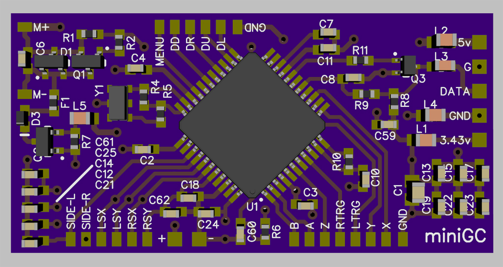

3D render of the final PCB for the miniGC with the decoupling caps and Analog power spots added.

Just an idea: Why not add a spot for a SMD resistor on the L & R trigger? It would eliminate the need to poke with a external resistor, if using the double tact switch method. If the buyer wants to use the original slider pots, just bridge these spots.

Installing a Resistor inline like that wouldn't work right.
Since the Left Trigger and Right Trigger go Hi when pressed, if the Resistors were installed from the LT and RT lines to Ground, then
they could just be left in there all the time. Then wiring a Tact switch form LT to AN+ could be used for Digital, or a 10k POT if they wanted Analog.
The reason I didn't do anything like that initially is because I've no idea how someone might want to use it. The 360 controllers work the same way, only with 10k POTs
instead of 35k, but I also left those alone so they could be done however.
It's not really a big enough change to warrant a new run of PCBs, plus the added cost and time involved, but if you want to pay for the new run of PCBs and
wait another month for them to get here, I can surely make the change and get some made up that way. ;)

I think you're looking at the wrong lines, LTRG and RTRG are already digital buttons. The sliders are presumably connected to SIDE-L and SIDE-R.

@ tueidj - Correct, SIDE-L and SIDE-R are the Analog lines that would need to be done, not LTRG and RTRG. I had 360 controllers on the brain there with the LT and RT lingo.
@ public-pervert - Now that I'm looking at this thing some more, if you're really wanting them Digital, you can just replace C21 and C24 with a 10k 0603 and there you go, or better still
solder them on top of them in parallel so they Caps stay in there. Then just wire up your Tacts to SIDE-L and AN+ for Left, then SIDE-R and AN+ for Right.
Correction for an Analog setup also. Anyone wanting to keep them Analog should not install a 10k at C21 and C24, as with the Resistors installed and a 10k POT then used, it
will never release all the way. If Analog Slides are needed just wire the POT to GND, SIDE-x, AN+ for them. If they work backwards, then swap the AN+ and GND lines on the
POT.
