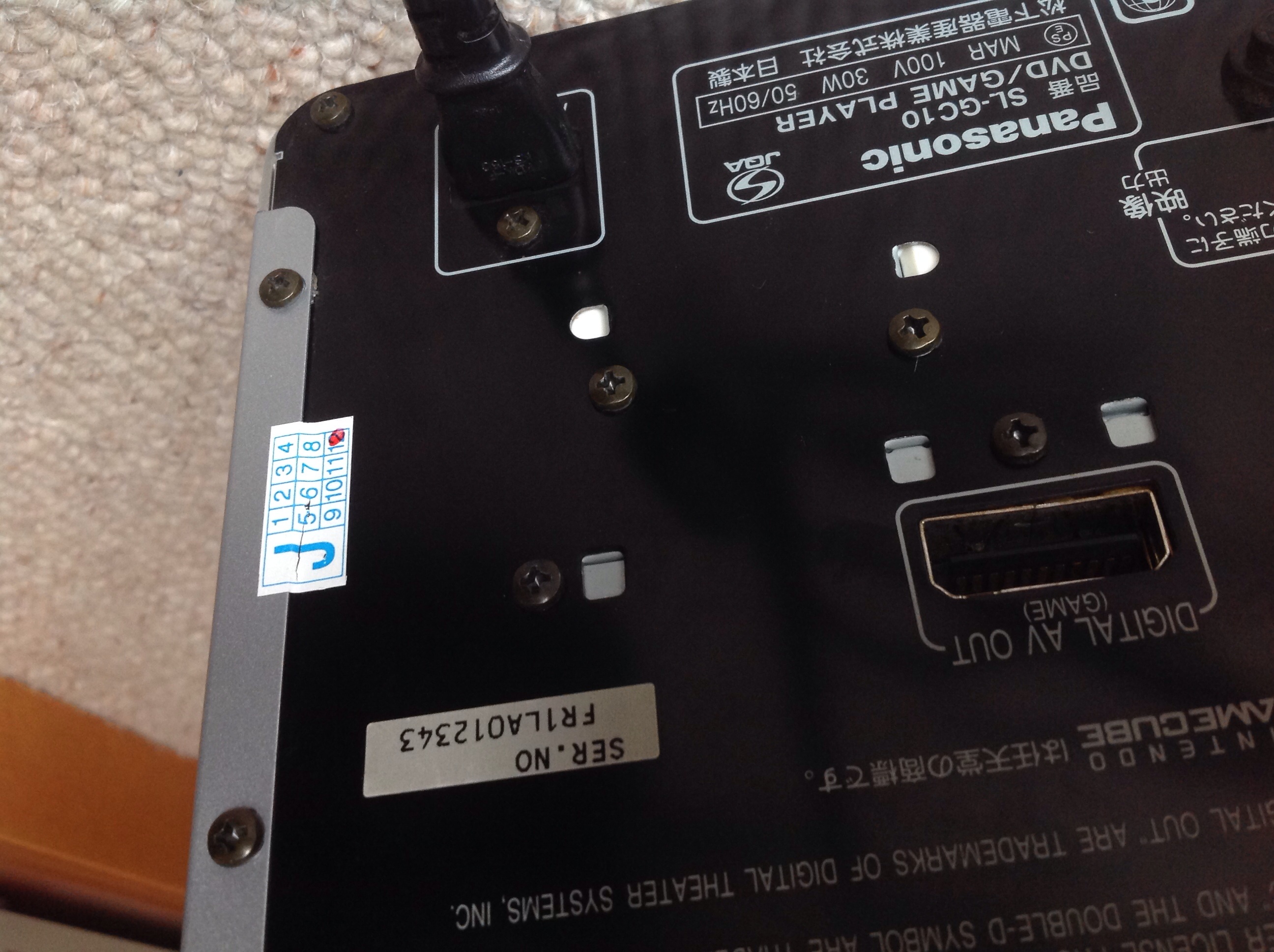

There is also this sticker on the back which I haven't seen before on other GQs (see enclosed photo) I wasn't sure if it was a panasonic factory build date sticker or possibly someting LIk sang put on if the case was indeed opened prior to export to fit a mod chip.

with that sticker on there, it looks like it was never opened...
if it has not been opened, then chances are it is not modded to play out of region titles..
you can either attempt to install a region switch mod, install a modchip, or maybe just purchase a pre-modded gamecube?

that sticker isn't on unopened Panasonic Q's, looks like it was added after.
The region free on Panasonic Q's is done via a PIC chip to avoid a ugly switch and will toggle between the USA and JAP IPL via a button press, but I forgot what triggers it, maybe it's the reset button?
