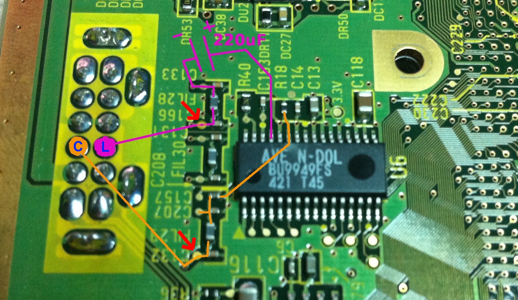

All of this has been done on a DOL-CPU-50 board. I know for sure DOL-CPU-60 Rev C's exist and that there is possibly a DOL-CPU-70 revision. I don't have a CPU-60/70 to test this on so do this at your own risk on those boards.
Here is where you can cut to:
Needless to say, this cut removes all of the built in on-board regulator stuff. So you'll need to build a custom regulator to power it. DO NOT cut ANY further than I've shown, there are some critical tiny stuffs RIGHT next to the lines I've drawn, if you cut any further you'll kill the board.

Audio/Video Relocation:
