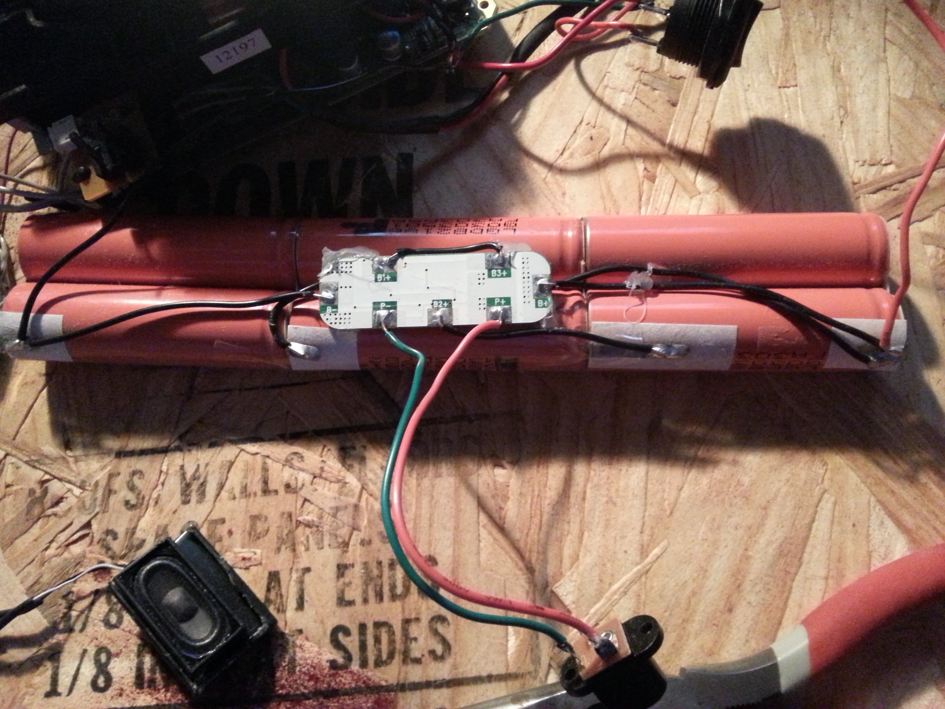

I am relatively new to this whole portable scene and would appreciate some input. I have my portable up and running however I am having a problem with recharging the batteries. Charger works fine since it also provides dc power to the unit. Batteries do work when charged. I have a pcb board set up and would like some input since my batteries will not charge. Thanks!

See in the back my battery pack and PCB?
I would suggest taking a look at that and notice how I have them grouped. Try doing simmering like similar.

If the batteries are connected in series end to end
-1+,-2+,-3+
+4-,+5-,+6-
then to charge them you only need to supply the power to 3+ and 6- providing -1 and +4
are linked together, what I suspect you've done is
-1+,-2+,-3+
-4+,-5+,-6+
-1+,-2+,-3+
+4-,+5-,+6-
-1+,-2+,-3+
-4+,-5+,-6+

Correct I am running them in series and parallel so your second diagram is how they are connected. I feel like according to the pcb that I have wired them correctly. It is hard to see in the picture that Duhasst0 has provided and I am using 3 sets of 2 batteries run in parallel, where he is using 2. I'm at a loss... Im including a picture of the packaging to make sure i am even able to run these sets in parallel. And maybe I have to knock down to just 3 batteries in series. I just want to be careful so my batteries dont explode and burn down my house haha.

Sorry, basically there way I have my pack soldered is both packs are together in parallel. Then with my PCB it just sees them as a 2 cell pack. So there positive of pack A goes to the positive pad, then the negative from pack A and positive from pack B connect to the same common pad, then there negative from pack B goes to the negative pad.
So basically what you need to do is split then into separate packs, so 3 packs of 2 cells. Then pack 1 positive goes to the B+ then the negative from pack 1 and positive of pack 3 to B1... So on and so forth.

Brilliant! But wiring them to the system would still need to be the same correct? or would they be wired from the P- and P+?
Edit: Or will the B+ and B- be used for the power?
Re: Need help with GC portable battery charging
B is for the batteries and P is for the output power.
Also, insulating the batteries will allow you to stack them the way you want, like in the picture you posted.

Sounds ok to me, basically just connecting all the - and + points together to create the two power rails
which also allows you to charge each battery independantly..

Its amazing what can be accomplished when you read the instructions... I had all the terminals connected to the batteries and apparently I didnt need one. Charge testing now.

And it works, thanks all for the advice much appreciated!
