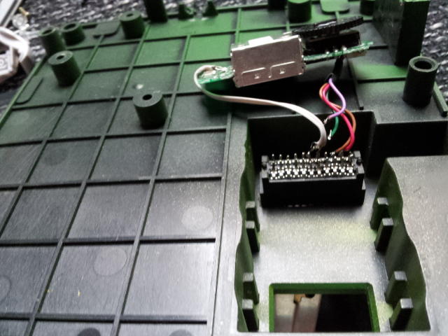

Hey guys i´m almost done with my 4x Wavebird internal mod.
What i want to do:
-Put 4x Wavebird reciver into the Gameboy Adapter of the Gamecube, (Almost done)
-build a 22 Pin Connector into the GC and the Gameboy Adapter to connect the GC with the Recivers (Done)
What my Problem is..:
The reciver needs 4 wires to connect with the GC to make it work, but i want to use the LED of the Reciver so i need 2 wires more.
So i need 6 pins/each reciver (24) but i got only 22 Pins on my connector.
My question :
Sorry if this is a totally retarded question for people who are experianced in electronics...
Can i connect the purple wire from the reciver (Ground, goes actually to one of the 4 big Pins at the PCB) anywhere into the Gameboy adapter?
So can i use "Ground" of the Gameboy adapter??

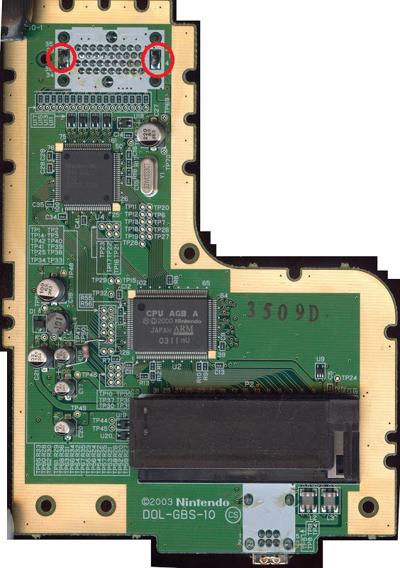

Oh man good news.. the following question for me is:
Where is "Ground" on the Gameboy Player?
Is it a special Pin or the metalshield ?
Do i connect the 4 Cables to those Pins on the Pic?
(178.27 KiB) Not downloaded yet

Post by Diminuendo » Mon Apr 13, 2015 3:21 pm
see all that unmasked copper at the edge?

Post by Crosz » Mon Apr 13, 2015 3:37 pm
yes i do see it :/ so that is the ground i guess

Re: Internal wavebrid / need help in Basic Electronics
Post by Benni » Mon Apr 13, 2015 7:02 pm
Yes, that´s ground... ;-)
