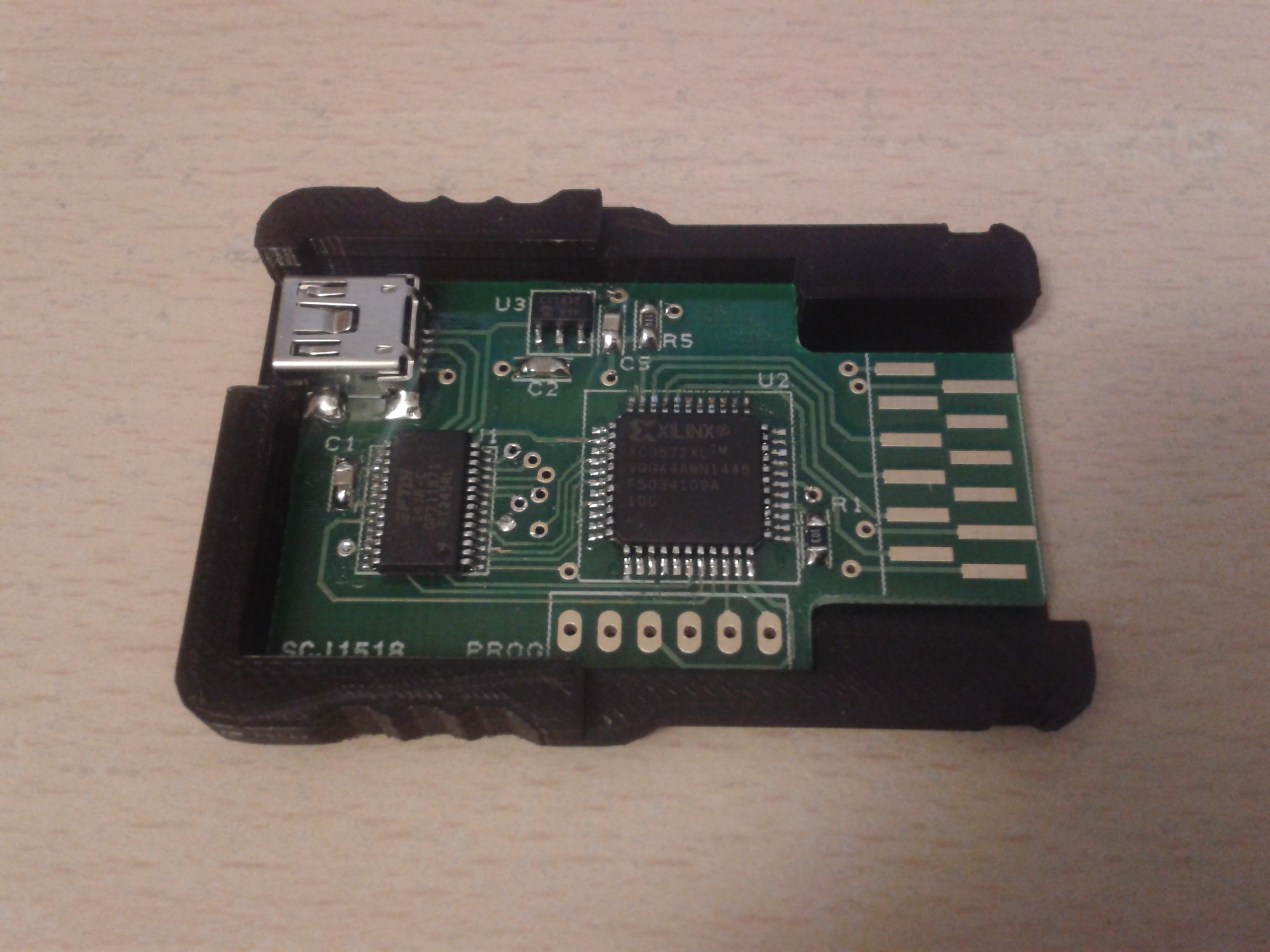

The shuriken V1 can't use most (ANY) of these programs but the V2 is perfect and everything works. Give me some time I will add more. If you were one of the unlucky few who bought the V1 (Me also) I'm sorry to break it to you but your going to have a lot of problems. When you use the V1 on the wii (which is your only way to use it) the only program I got to work is the custom made GeckoDotNet and for the most part it does work minus screenshots. But if your trying to push a cheat over to a game and it has more then 5 lines of code the game will freeze and not recover. 1-4 lines of code will work most of the time but sometimes it doesn't. It's very hit and miss for the V1 I'm not going to say it was a epic fail I will say it was a "oops" and Happy_Bunny made the V2 to fix all the Problems that the V1 had. What's the problem with it? The FTDI FT245BL chip is the problem and is the reason for the data loss. The USB gecko is supposed to have a FTDI FT245RL which you would think wouldn't be a big deal to replace the V1 with the right chip but after comparing the V1 to V2 I do think it would be impossible to solder the right chip on because the BL chip is square and the RL chip is rectangle. Also ID string the original USB gecko SE, FT245RL chip used a device ID string of "GECKUSB0", however the Shuriken USB V1 unit uses a standard USB to serial device ID string. This may cause issues depending upon how the PC software access the unit. If it uses the units serial port number instead of the devices ID string then the software will just work and it will be a 1:1 clone of the USB gecko SE. However if it uses the device's ID string to access the unit this will result in a device not connected message

I thought the FT245BL and FT245RL where basically the same minus the eeprom and I had some FT245BL so I designed the PCB with them in mind and they worked for me. However they are clearly not the same as the weirdness with the screen shot stuff shows, this is nothing to do the software and is directly related to the difference between FT245BL and FT245RL.I'm not going to say it was a epic fail I will say it was a "oops" and Happy_Bunny made the V2 to fix all the Problems that the V1 had

I'm not flaming you or anything like that I just stating why the V1 has problems. The V2 is great and I have not had any problem so far. The data loss with screenshot isn't the only problem. The data loss also affects code dumping and poking code as well and is the reason I think the swiss server freezes up because I have tested swiss server with the V2 and now that problem is gone too.happy_bunny wrote:I thought the FT245BL and FT245RL where basically the same minus the eeprom and I had some FT245BL so I designed the PCB with them in mind and they worked for me. However they are clearly not the same as the weirdness with the screen shot stuff shows, this is nothing to do the software and is directly related to the difference between FT245BL and FT245RL.I'm not going to say it was a epic fail I will say it was a "oops" and Happy_Bunny made the V2 to fix all the Problems that the V1 had

Nearly did another batch of v1 because the ft245bl is easier to solder but the screen shoot stuff was bugging me. I tried all sorts of software hacks to try and get the dam thing to display properly in the end i decided it was the chip and the only way to prove it was to change it hence v2 was created.

V1 worked for you, but which programs did you test to validate your work?happy_bunny wrote:I thought the FT245BL and FT245RL where basically the same minus the eeprom and I had some FT245BL so I designed the PCB with them in mind and they worked for me.
obviously not all programs were tested else you would have found the flaw in your component selection...
also, didnt you realize something was not right when you had to compile custom programs to work with your design??
Re: Shuriken USB V1+V2 support
The reason for recompiling was because of the device ID (which programs don't even care about if they're written sensibly), using a device that doesn't support a custom ID would obviously require changes.
Possibly the programs that don't work correctly are driving the EXI slot at a higher frequency than what the gecko was designed for, which just happens to work (most of the time) with the 245RL. Basically if it works with wiiload+HBC it should work with any other program, unless that program is doing something it shouldn't.
