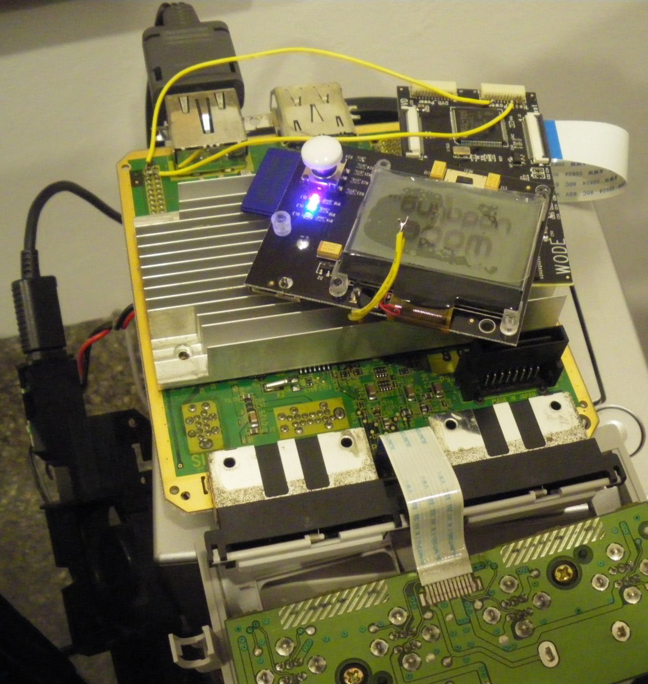

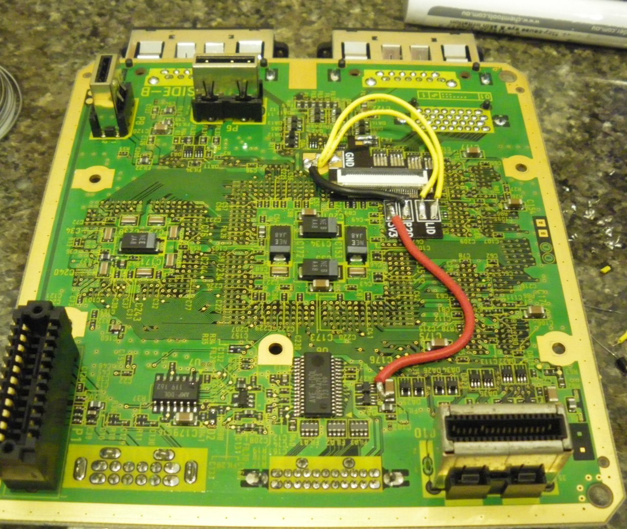

Here's some pictures I took of my WODE + V6 I put into a NTSC-J 1.0 recently. The V6 is a pain without proper tools :)
Pictures:
Wired up, with lid wires pointlessly going to the top (through the hole) in case I decide to use a switch

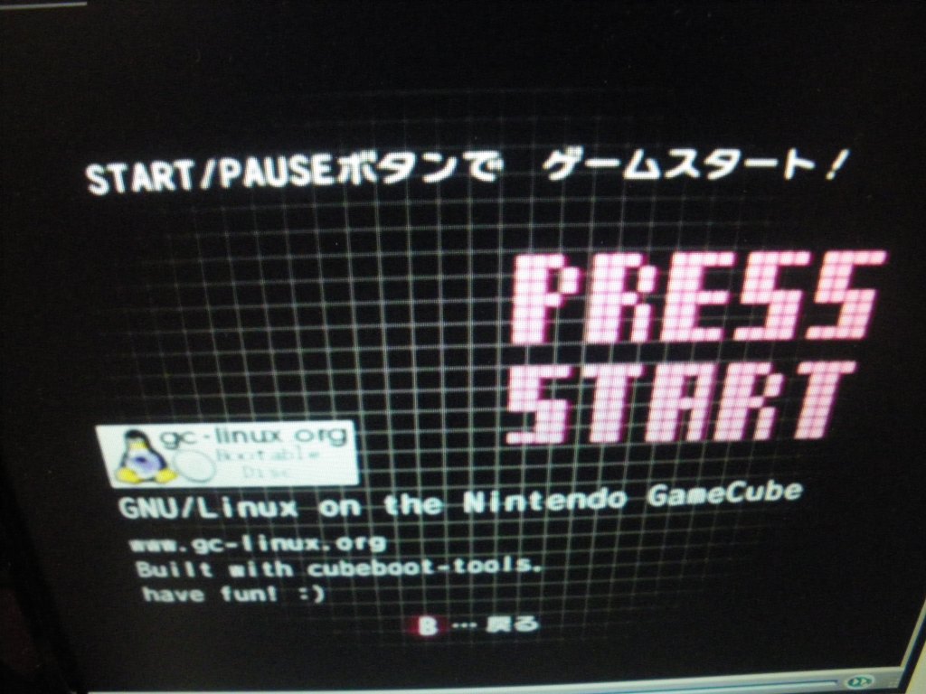

It works!

Config loaded, case re-assembled mostly...

Config in the IPL :)
