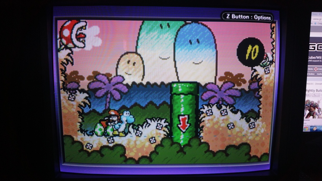

Post by XC-3730C » Tue Oct 06, 2015 8:59 pm
I finally performed the HDMI mod on my GC. Here is GBI on my 50" plasma (GBI loaded off of my Max Drive Pro) zoomed at 2.5X:

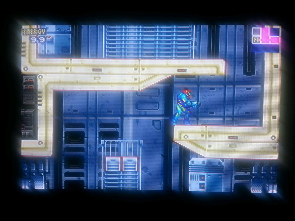

Post by XC-3730C » Thu Oct 22, 2015 12:03 am
240p is much better than 480i/p. Look at the Startup Disc running at 240P via Swiss 240p option and see what I mean:

XC-3730C wrote:240p is much better than 480i/p. Look at the Startup Disc running at 240P via Swiss 240p option and see what I mean:
There is no need for scanlines in the 240p version on a CRT as real scanlines will be displayed by the CRT, like your screenshot shows.
If you are using an LCD screen 480p/480i with scanlines settings turned on through Swiss is your best option not 240p.
