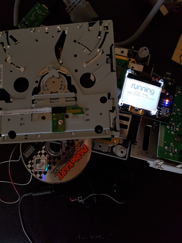

I have a WODE and a couple of questions regarding using it with my Gamecube...
I installed it and can boot the WODE menu and run discs with a Wii DVD drive, but haven't managed to boot an iso. I have a folder named "iso" in the root of the USB drive and have placed one iso (tried both .iso and .gcm extensions) inside that folder, but I can't see anything appear on the selection screen. The only external drive I have is an NTFS-formatted 64GB USB 3.0 flash drive, so I don't know if there are limitations on the drive that can be used.
I also managed to put the WODE into "flat mode" and can't get back out again :oops: Apparently, the way to exit is to double press eject on the Wii or press Wii eject and the Wode joystick at the same, but as it is connected to a Gamecube, I obviously can't do that... Any guesses as to how I can get it out of flat mode?

OK, so I did a bit more reading and wired up an eject button for the Wii DVD drive which works fine for ejecting DVDs, but it still won't let me exit flat mode when I press eject and the WODE joystick at the same time. I updated the WODE firmware in the hope that it might reset the settings, but no luck :cry:
I've connected my momentary switch to an alternate point I found on the Wii DVD drive for pin 29 and have connected GND and 1.9V at the power regulator connection on the Gamecube motherboard - are there more suitable places to solder the switch which might help me out?

I got a Wii in order to get it out of flat mode, so that's that issue out of the way for now, although I would like to find a proper long-term solution.
