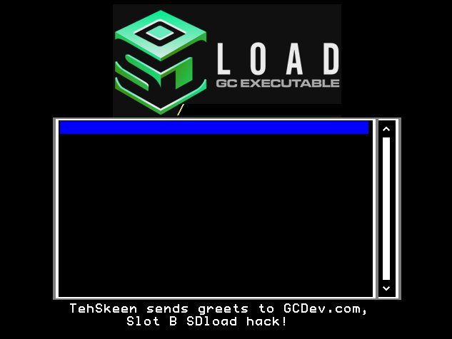

Post by emu_kidid » Sat Feb 12, 2011 1:04 am
SDLoad for Gamecube by Costis.
Custom Slot A & B version by unknown ;)
Also attached is the Cobra Plugin and Cobra 2.1 with SDLoad as a plugin (even for normal Viper GC)
Instructions: HOLD the A button down when booting to activate Slot B mode.

I have a homemade "SD Adapter" , but the "SDLoad" dont work , i dont know , if because i run it trought GCOM2.4 or Swiss01r62 Swiss 02r94 , Swiss02r124 but the thing is , when i try to load
Ok the SDLoad , load , but i the SDA are inserted , or if i Inserted , the is the same thing , nothing in the list , passed 35 segs , i can move 1 to up or 1 to down or press a button , when i press a button, i see a "Red Screen" with "Hexadecimals Address" , and if i press "A" button , i see , just 1 line of that address , are change , and well i should press "start" to "restart" the gamecube
Someone can explainme if this are "normal" ???
Posts: 4966
Re: SDLoad (Slot A and B)
Post by emu_kidid » Sat Apr 14, 2012 8:07 am
inukaze,
As I'm telling you everywhere else, please make a SINGLE thread to ask all of your questions as you seem to have difficulty learning things on your own or via the search button.
P.S. does the SD adapter work anywhere else? Maybe confirm it works first. Second, use 2GB or LESS card with SDLoad then swap to a bigger card in Swiss.

Post by Ikthias » Mon Feb 17, 2014 8:08 pm
Hi i flashed this to my Qoob Pro and when i launch it, holding down A for slot B, it doesn't show anything except some weird jumbled symbol, and i cant do anything. Anyone know how to fix this problem?
Posts: 4966
Post by emu_kidid » Mon Feb 17, 2014 9:40 pm
Has your GameCube successfully read a SD card via SDGecko before? (non SDHC).
Ikthias
Posts: 18
Joined: Fri Mar 08, 2013 8:42 am
Post by Ikthias » Mon Feb 17, 2014 10:47 pm
Many times, at least through Swiss
Edit: upon reformatting the SD card to FAT instead of FAT 32 i am now able to boot DOL files from SDLoad that is flashed to my Qoob Pro
Posts: 4966
Post by emu_kidid » Mon Feb 17, 2014 11:23 pm
Yes, SDLoad doesn't support FAT32.
