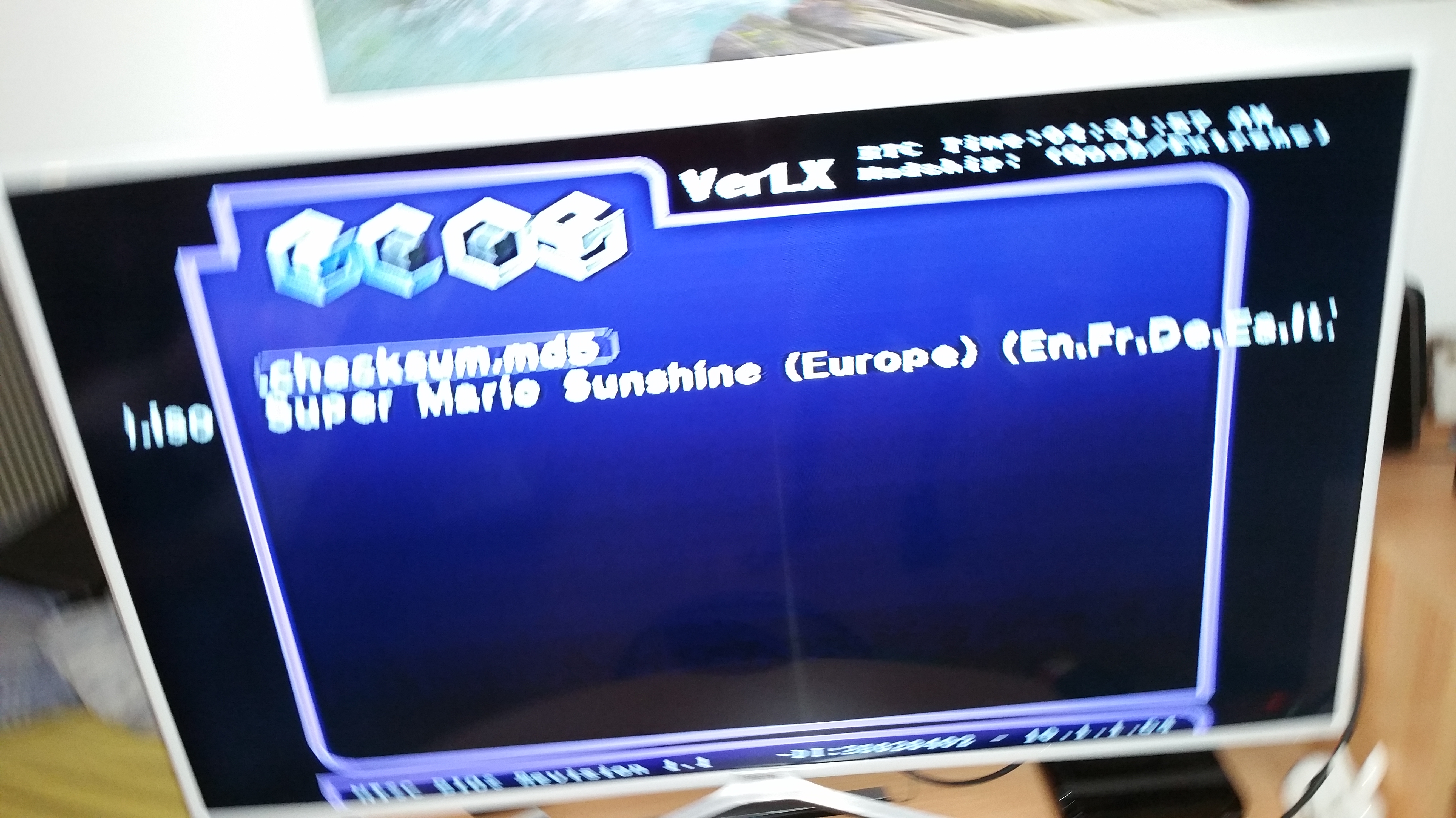

I just did want to load a backup of Mario Sunshine on my gamecube via DVD-R. If I load the game with swiss the screen goes black. If I load it with gcos the following text message appears. (Look at the pictures!)
Hopefully someone could help me!
Thank you for answers!

If you have a modchip, the game should play automatically when booting the system without the need for homebrew.
Barring laser or media issues.

Don't use gcos. If you have a Qoob pro or a viper, flash iplboot to it then use the latest Swiss from GitHub.

You've burnt the ISO as a file on the disk, that's not going to work with GCOS or Swiss. Burn the ISO as an image using ImgBurn or something.kai2018new wrote:Hello,
