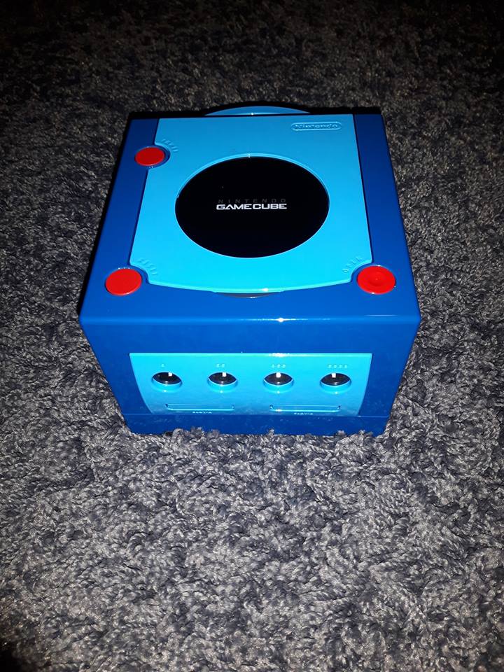

so i have 2 gc one has the region mod switch and the other doesnt. so tried 3 different tv, worked only on one perfectly didnt matter what the region was set at. the other gc still only will boot non backups in color but backups are black and white
