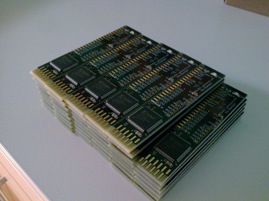

Post by emu_kidid » Fri May 10, 2013 1:47 am
These were good times :)
(93.76 KiB) Not downloaded yet
kel01
Posts: 149
Re: IDE-EXI Gerbers, Design Files, BOM, PDF and Program File
Post by kel01 » Fri May 10, 2013 11:40 am
Wow. It must have taken a while for you to solder all those 40 pin IDE headers on.
Posts: 4966
Post by emu_kidid » Sat May 11, 2013 12:11 am
I had a little fan going for air extraction, but I really felt like a chinese factory worker for a little while :(

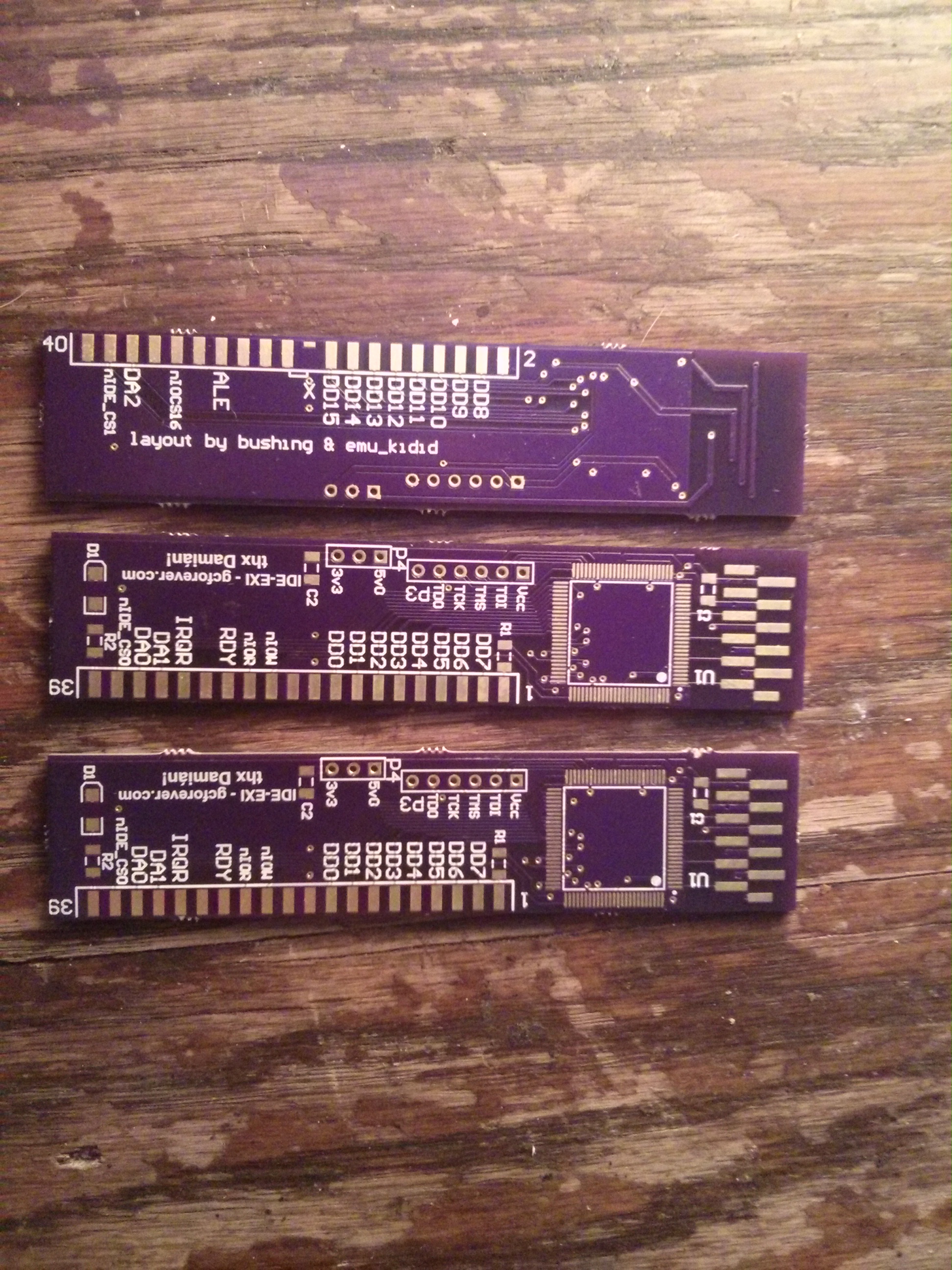

Post by andre104623 » Thu Aug 28, 2014 9:56 pm
I want to thank emu-kidid for this:
(1.69 MiB) Not downloaded yet
Posts: 4966
Post by emu_kidid » Thu Aug 28, 2014 10:52 pm
Nice, I don't think there is much demand these days though sadly.

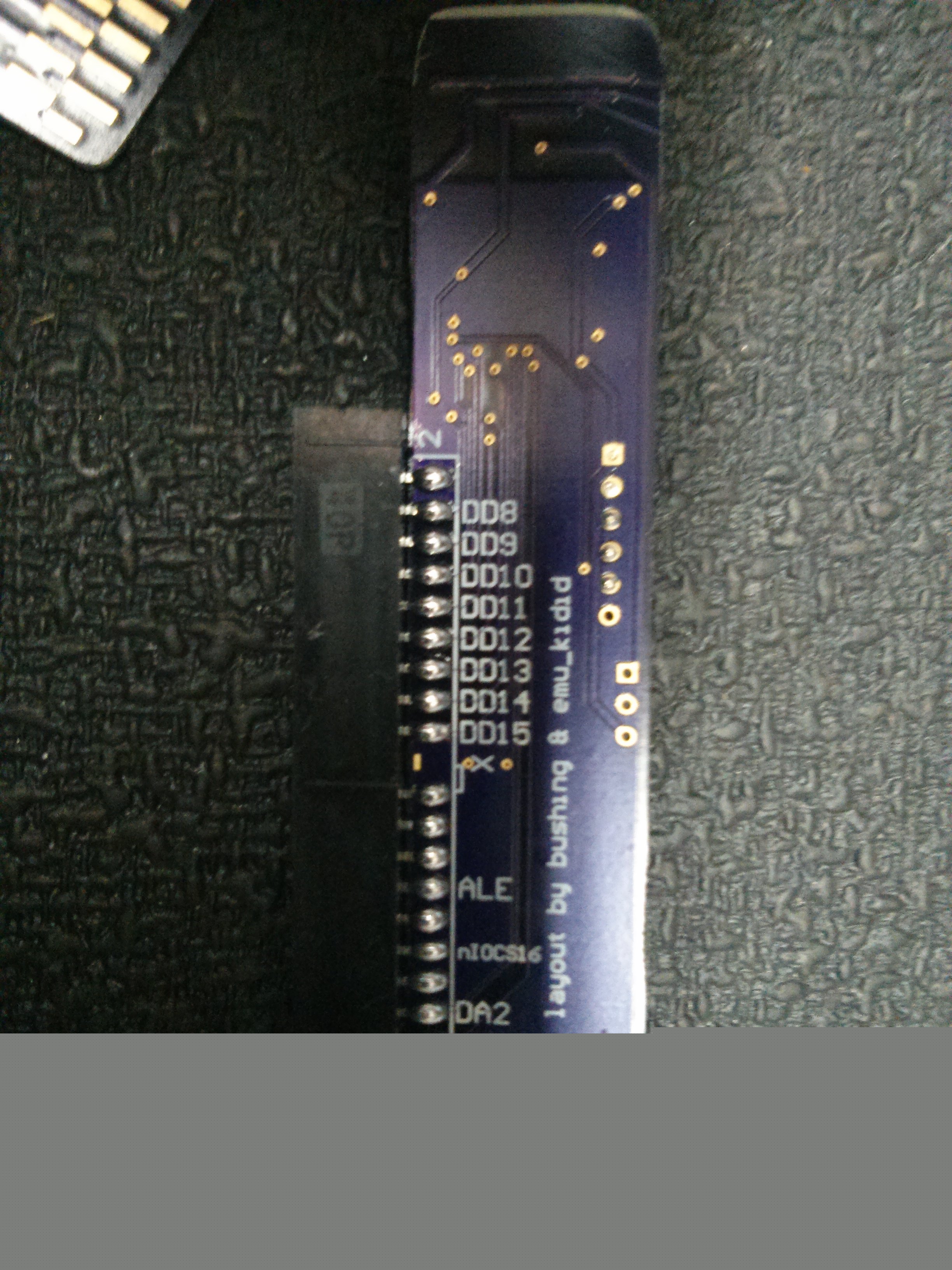

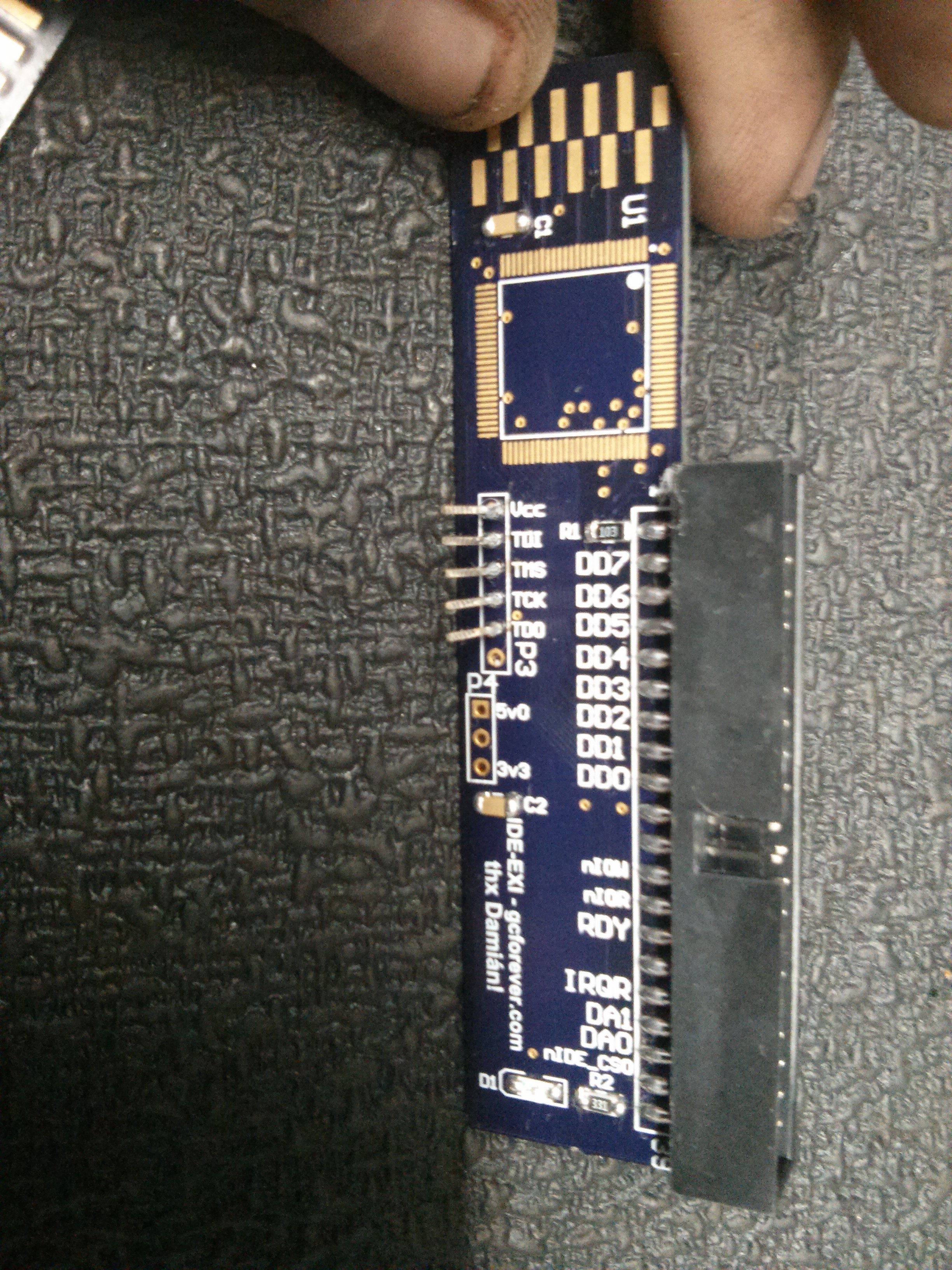

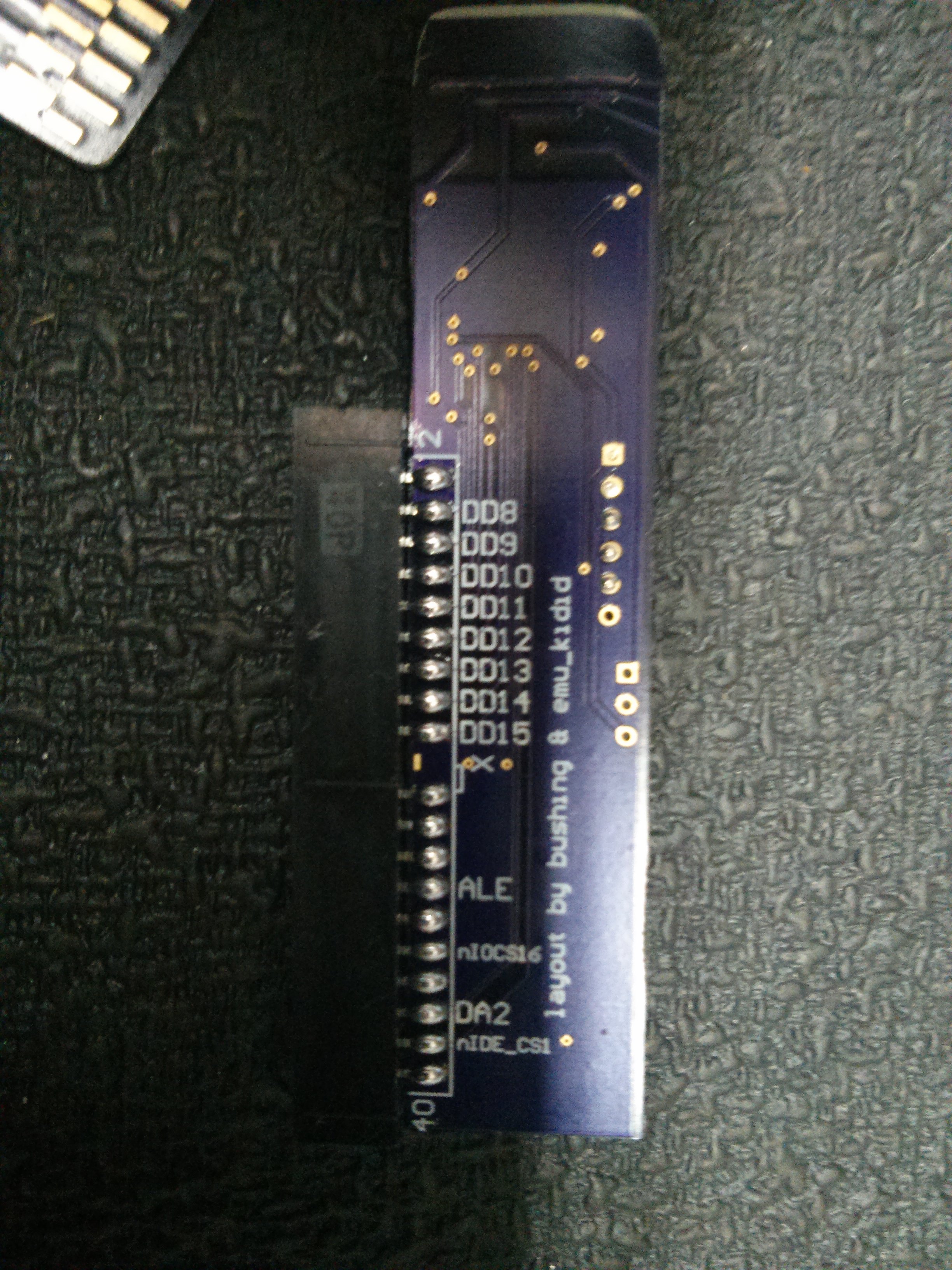

Post by andre104623 » Thu Sep 18, 2014 8:05 pm
(1.29 MiB) Not downloaded yet
(1.38 MiB) Not downloaded yet
(1.59 MiB) Not downloaded yet
These are about 75% complete. I have completed 3 now I have 3 left to do. Tonight hotair reflow xilinx chips and flash then test. Thats it after that on to bigger and better things (GC video!!). This was a fun project and it will be missed thanks everyone
Post by megalomaniac » Thu Sep 18, 2014 8:26 pm
You might want to get rid of C1 if you run into problems removing the PCB from the card slot
andre104623
Posts: 694
Post by andre104623 » Thu Sep 18, 2014 8:39 pm
megalomaniac wrote:You might want to get rid of C1 if you run into problems removing the PCB from the card slot
I thought it was for flashing the chip only then it could be removed. yeah I noticed I got stuck under the memory card slot :lol:

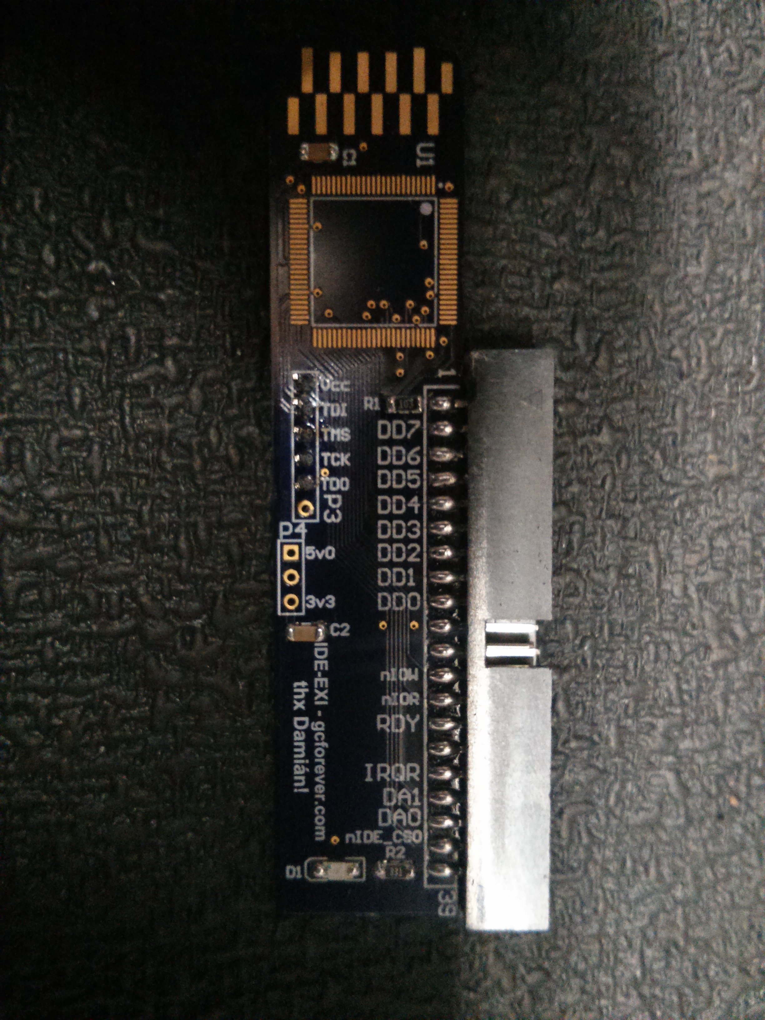

Post by andre104623 » Sat Sep 20, 2014 12:47 am

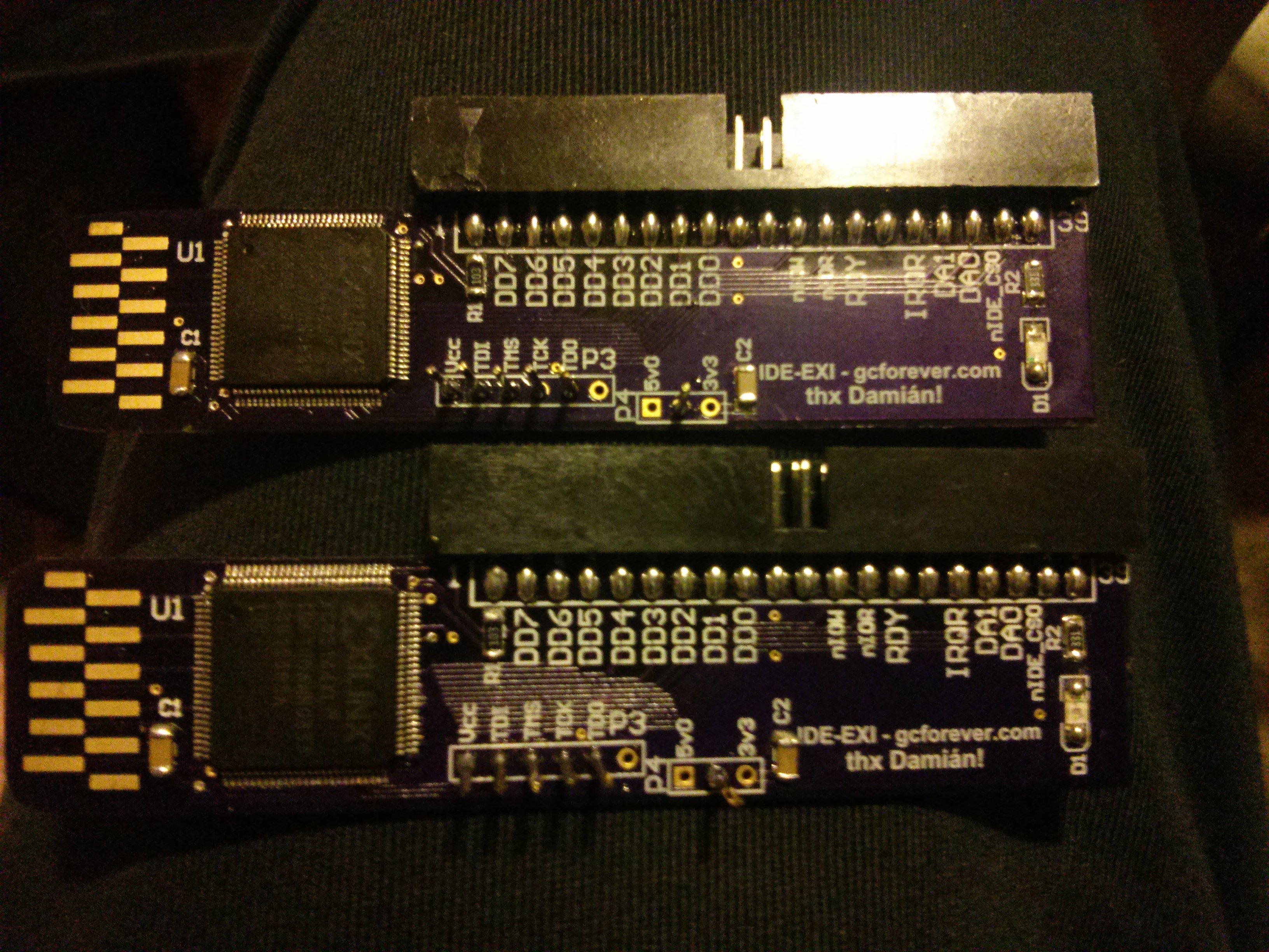

Here are two done and flashed now for testing and remove the JTAG pins. Hot air reflow is so easy for these small chips total build time 45 min to 1 hour each PCB
(1.35 MiB) Not downloaded yet
Posts: 4966
Post by emu_kidid » Sun Sep 21, 2014 1:28 pm
You don't need to solder pins in for jtag, just use a header on your programmer and hold it there whilst programming.
andre104623
Posts: 694
Post by andre104623 » Sun Sep 21, 2014 9:00 pm
emu_kidid wrote:You don't need to solder pins in for jtag, just use a header on your programmer and hold it there whilst programming.
Oh well its a little late for that but I'll remember that when I'm doing the GCvideo project. I have a xilinx usb programmer I should know this but I'll be fine flashing the GC video with this programmer correct
