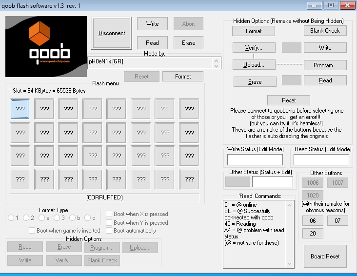

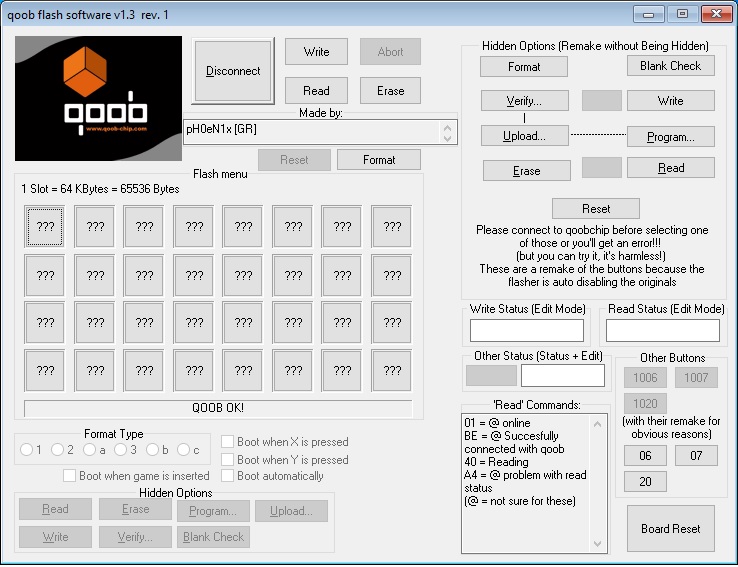

Hello I bought a qoob pro but it has corrupted banks for saving anyway to reset board with what settings or format with what options ??
When it loads it says its okay when I select a bank it's corrupted !!!!!!
- (133.14 KiB) Not downloaded yet
- (137.16 KiB) Not downloaded yet

Corrupted just means their software can't identify the contents of the banks, just try to write the qoob bios to it and see if it comes good? If it doesn't then I'd see if you can maybe swap the flash after trying those hidden options
