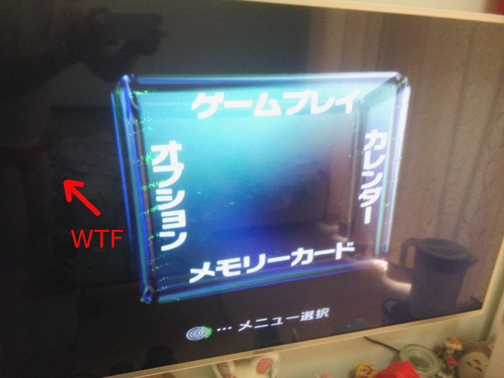

0.3 half works, it has some green noise pixels on screen, here are some photos taken from my TV:happy_bunny wrote:Oh thats a bit weird does version 0.3 work on your tv
Indeed it seems that 0.3 has fried my FPGA. I don't think it could Handle it after 1 hour of gameplay its dead. Going to have to order more pcbs and build again i sold my other 2HyperIris wrote:0.3 half works, it has some green noise pixels on screen, here are some photos taken from my TV:happy_bunny wrote:Oh thats a bit weird does version 0.3 work on your tv

I think its noise with only the video stuff only ond DCM block was used running at 54Mhz with audio you have two clock circuits running. I think the ground plane is jumping / noisy due to the clocks can you try this please (dam it didnt let me attach the vhdl) its from gcdv_decoder.vhd

This code works, it looks nice now. and I'll try 0.4 again now.happy_bunny wrote: @HyperIris
