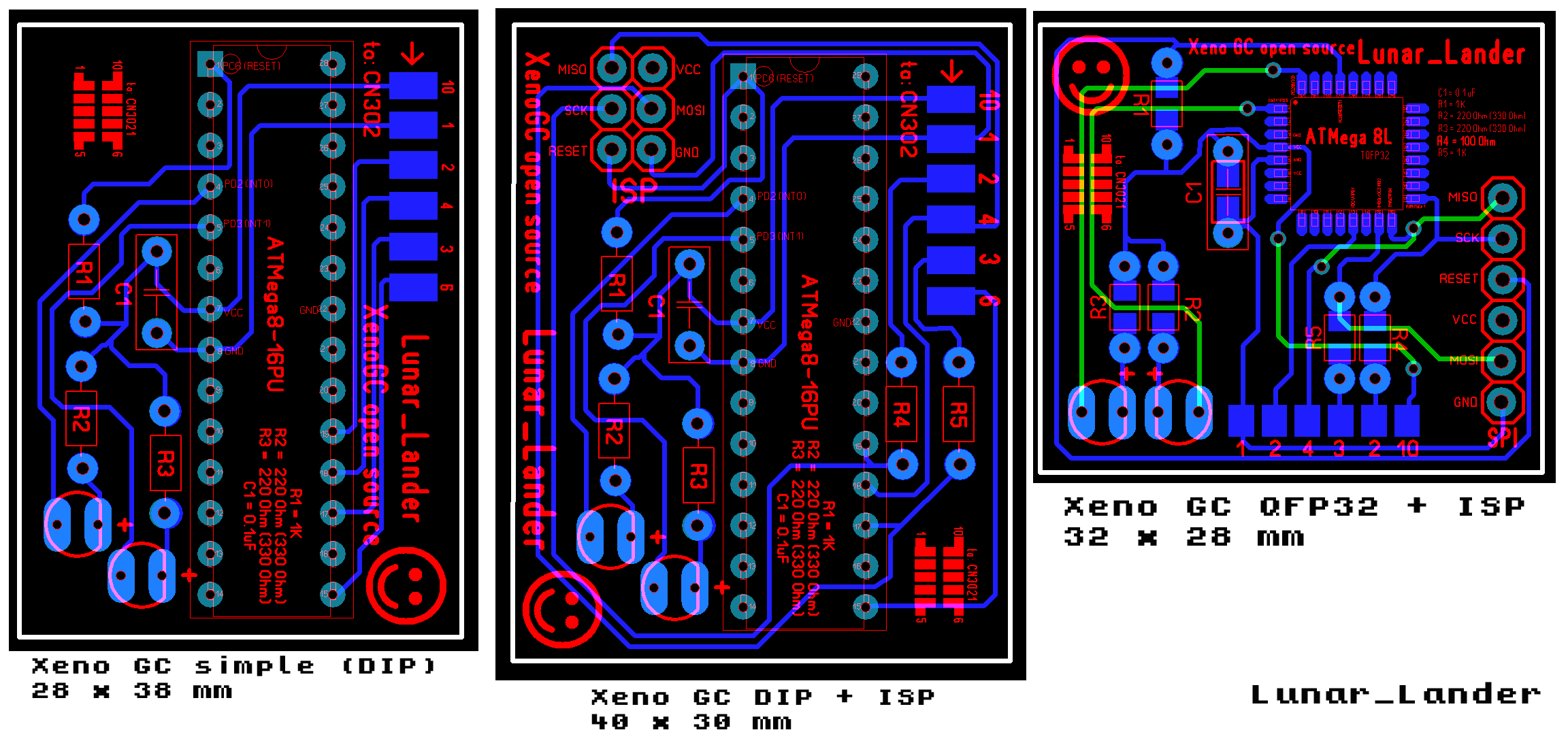

I would share with you my design for the boards.
There are made with Sprint Layout (a nice software for designing PCB) and the files can surely be sent to manufacturing in their format (.lay).
If you found the software you can export gerber + drilling files and such from it.
So here they are:
ps: I've made a file for each of the three combinaison: DIP / DIP + ISP / QFP + ISP
And the simplest one (the DIP) is only a single face PCB.
And the QFP one has its resistors mades to be able to put some throughole reisitors or SMD one.
And all the componments & values are noted on the PCB, as well as th connection points on the motherboard !
I've uploaded a picture with the three design side by side if you want to see... ("modèles côte à côte.png")
Enjoy" (as well as I enjoy" this release ! ^^)
, Lunar_Lander
(95.61 KiB) Not downloaded yet
puce Xeno GC open source layouts.rar
(95.49 KiB) Downloaded 2069 times

Post by megalomaniac » Tue Jul 10, 2012 1:19 am
Nice layout...Looks good
