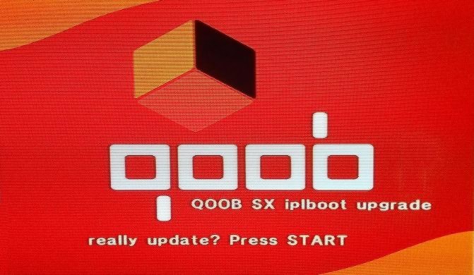

I hope you don't mind, I have just made a little change to your ELF! Now it shows the text "QOOB SX iplboot upgrade" instead of "QOOB SX upgrade to 1.3c" which it not true!
(90.82 KiB) Not downloaded yet
I also build an ISO everyone can burn on DVD and upgrade:

Post by novenary » Thu Jun 14, 2018 7:33 am
That's a good idea, I'll include it in the build script.

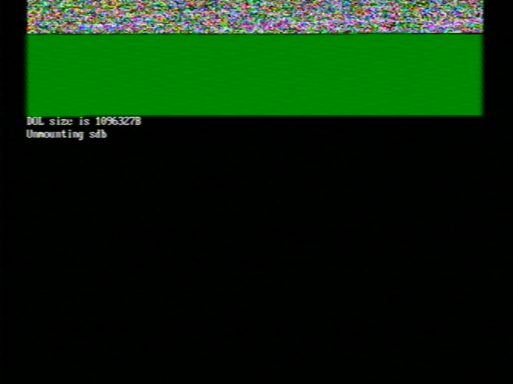

toxic9, do you see something like this when it fails to boot?
Do give r5.2 a try, I've tested it on my Qoob Pro this time and it works.

Post by toxic9 » Sat Jun 16, 2018 2:09 pm
Hi friend!
Yes, that's something like that!
r5.2 is perfect now. Pro and SX versions are OK.
