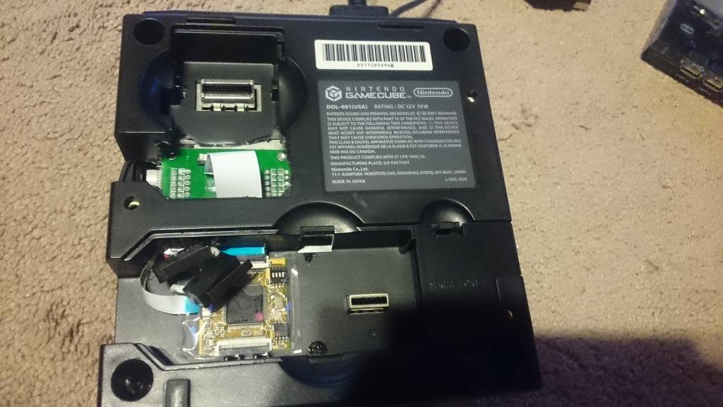

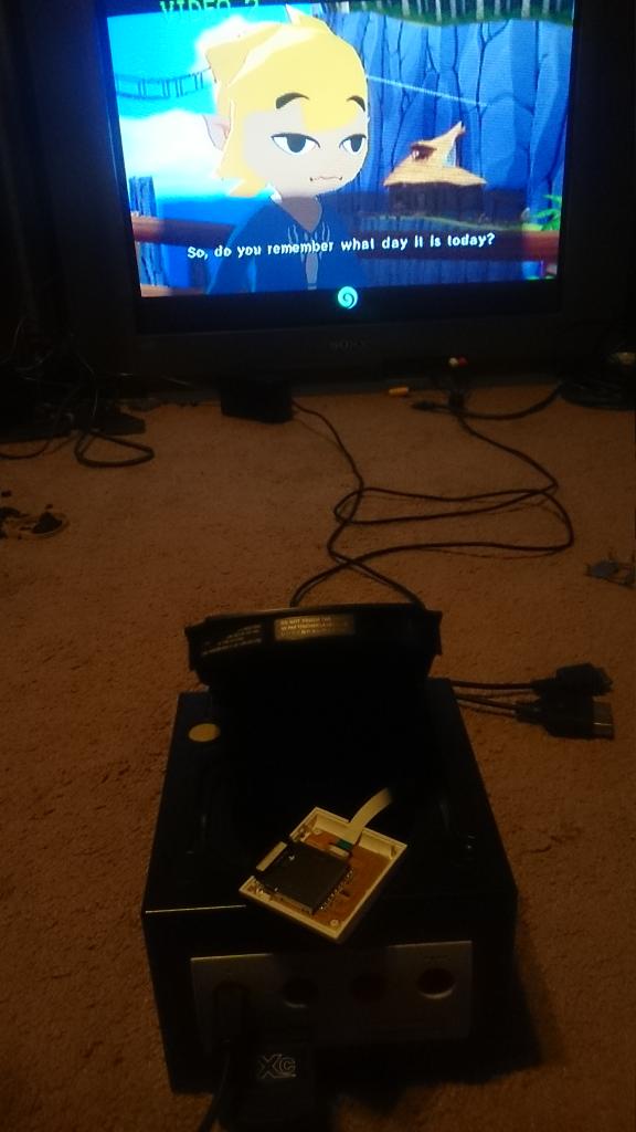

First attempt at a disc-less gamecube.
Re: First attempt at a disc-less gamecube.
Last couple pics
the switches and their placement. Not pretty but it works. And a pic of windwaker running.
you might want to consider putting a fold on the SD FFC cable at the chip...
ive seen a rounded bend (as shown in the pic) cause a pressure to lift the cable contacts preventing proper connection...
just something to think about if you run into issues later...
