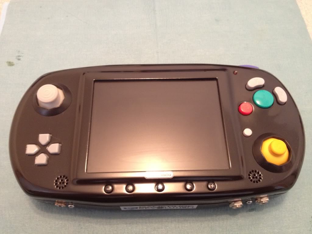

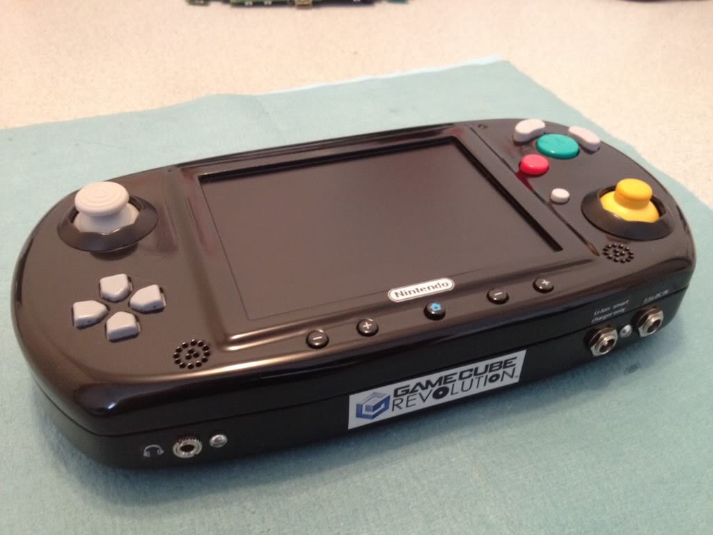

The guy that bought the Revolution from me wasn't a big fan of the 3DS sliders. Changed things up on his request:
Turned out pretty well considering it was done after the fact. :D
(75.35 KiB) Not downloaded yet
(73.91 KiB) Not downloaded yet

Post by megalomaniac » Sun Jun 24, 2012 8:38 pm
I thought the sliders were epoxied to the case...
If so, was it hell to get em off and smooth out the bottom side surface to fit the traditional controls??
Also, were you able to salvage the sliders?
Re: Gamecube Revolution [Complete!!]
Post by Ashen » Sun Jun 24, 2012 10:03 pm
tenypoo wrote:Do you another one for sale?
Nope, sorry.
megalomaniac wrote:I thought the sliders were epoxied to the case...
They were, with a little bit of added heat the epoxy I normally use becomes pliable/workable again so It wasn't too bad to get them out and clean things up for the modified installation. Both sliders came out in one piece, so I'll be able to reuse them. :D :D
