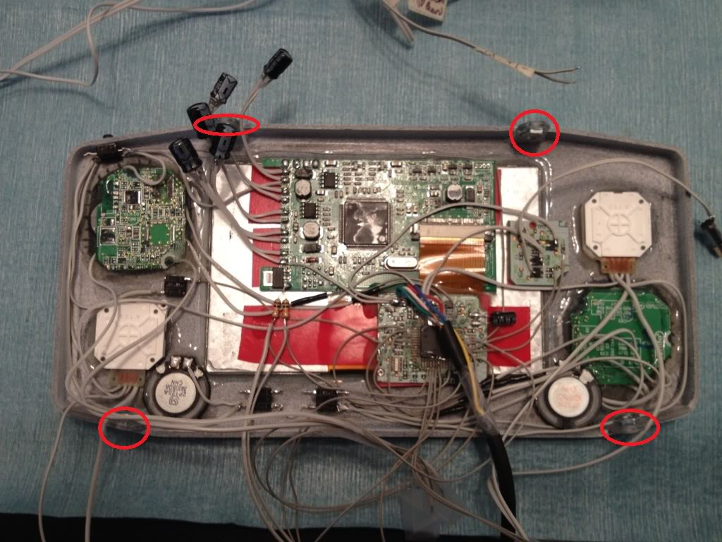

megalomaniac wrote:looks good...
how do you screw the case together?
Its kind of hard to see in the pics unless you're really looking
you can see the posts with bolts mounted to them though and if you look at the other pics you can see where the screws will go on the outside of the case.

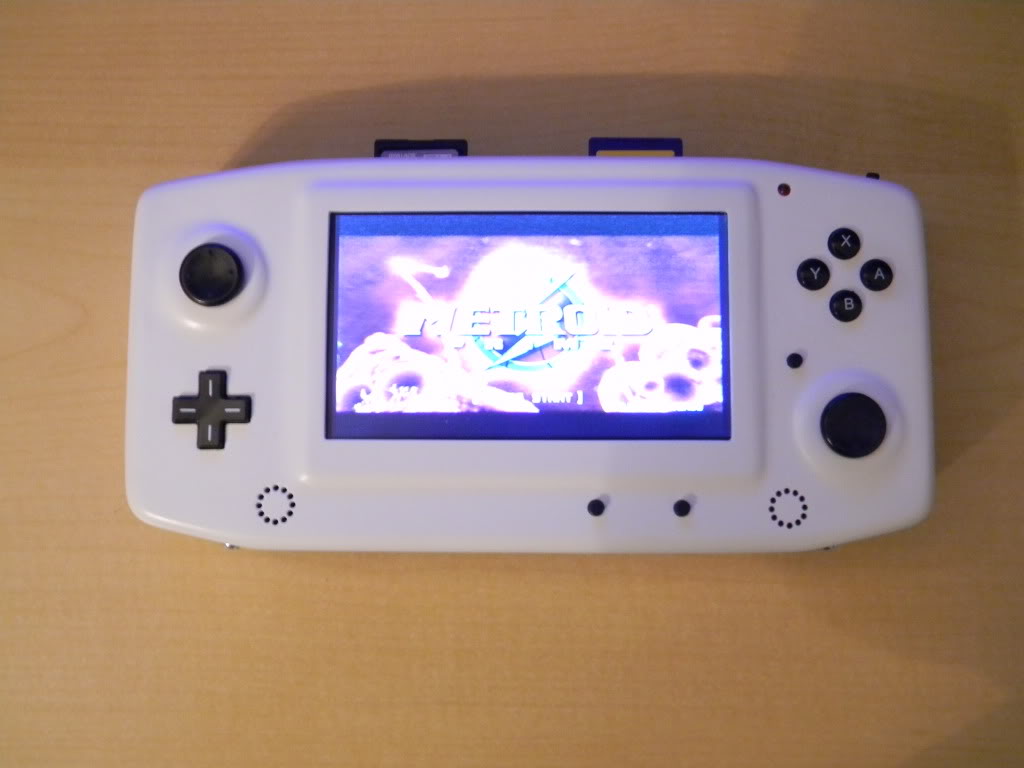

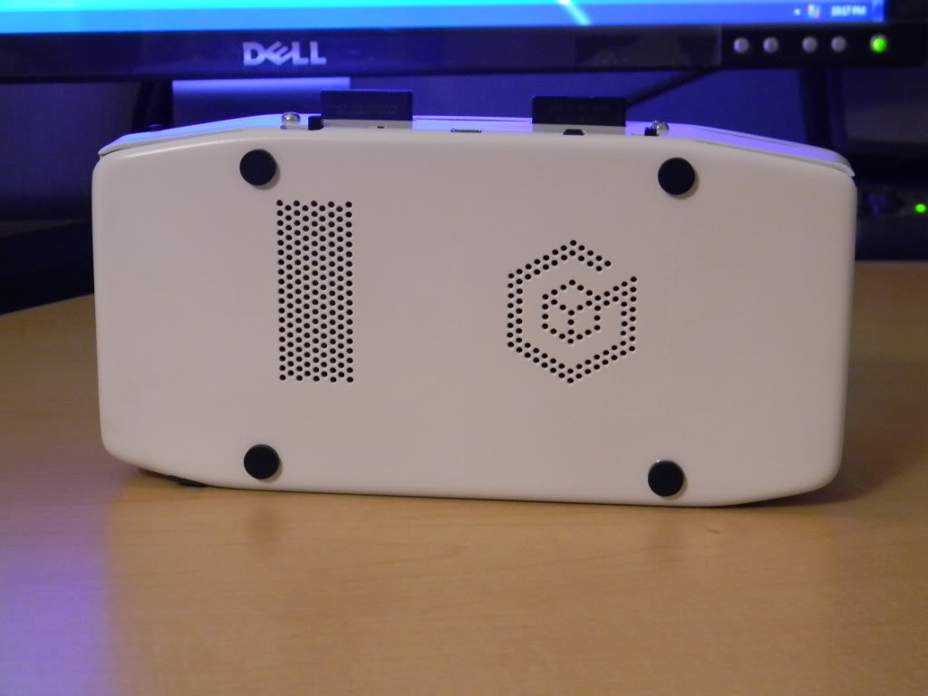

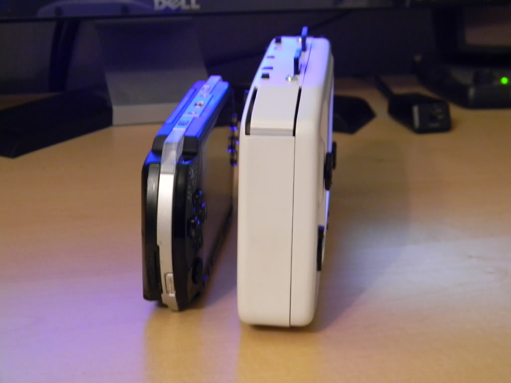

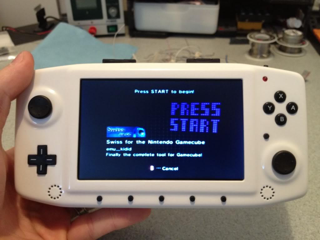

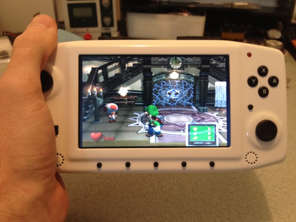

Yar, another one done from 'ol Ashen. Been being lazy/busy playing this thing lately and haven't made up any video yet. Figured I'd post the pics I took though. I'll likely make up a little video sometime in the near/distant future.
Specs/Features!:
Custom Vacuum formed case, slightly frankencased.
Dimensions: 95 mm (h) 192 mm (w) 30mm (d). - Comparatively the PSVita is: 84 mm (h) 182 mm (w) 19mm (d).
Weight: 1.55 lbs
4.3" DX "backup monitor" Screen
OMGWTF/AlmostWTF hybrid cut GameCube motherboard (onboard audio pre-amp retained) + IBM Laptop heatsink/fan
Wiikey Fusion!
4x 2600mah Lithium-Ion Batterys (7.4v 5200mah total) = Roughly 2 hours playtime.
Zenloc's custom regulator: CPU/GPU=1.7v, 3.35v and 5v for maximum battery life.
Official GameCube controller with rumble relocation, iPhone 3Gs rumble motor, 3DS analog "sliders", DSlite buttons (hotswappable a/b buttons) and d-pad and fully functional L/R "triggers" via the dual tact mod.
Internal 128mb Memory card on slot "A", Internal SD Gecko on slot "B". Save game transfer possible via external adapter.
iPod/iPhone audio amp with DSLite speakers + switching headphone jack.
Mario's low battery indicator circuit. Active @ ~20 minutes left.
Pics!:
Hope you guys like! Enjoy.

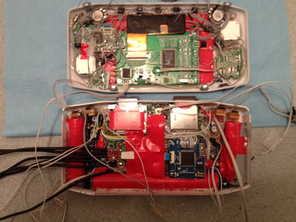

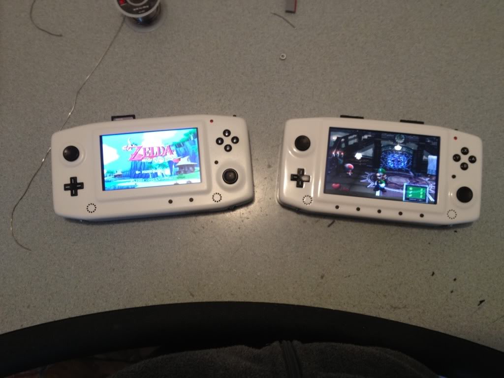

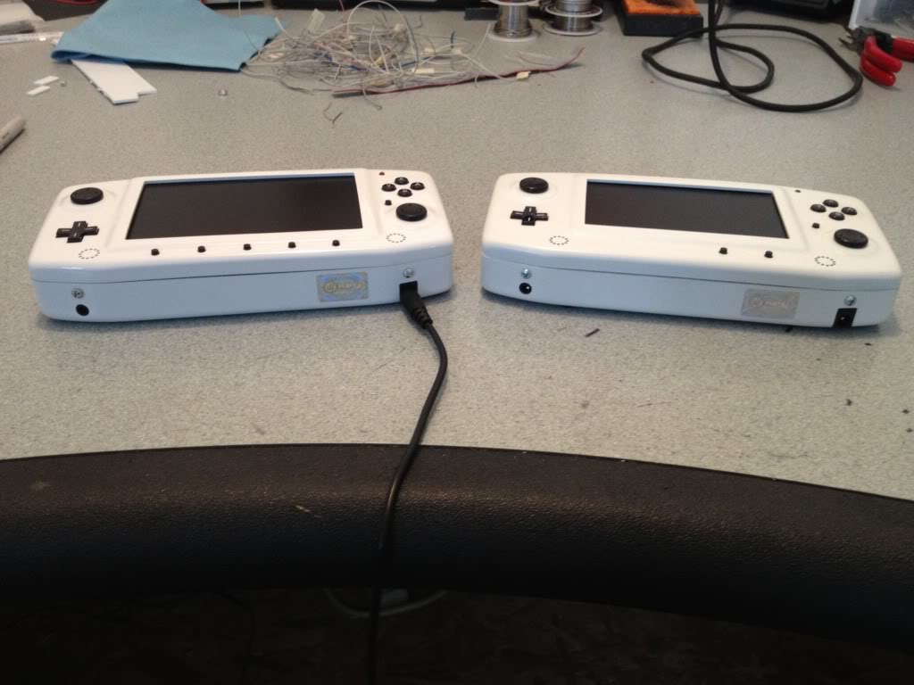

Post by Ashen » Fri May 11, 2012 4:56 pm
5" Screen model is done! :D :D

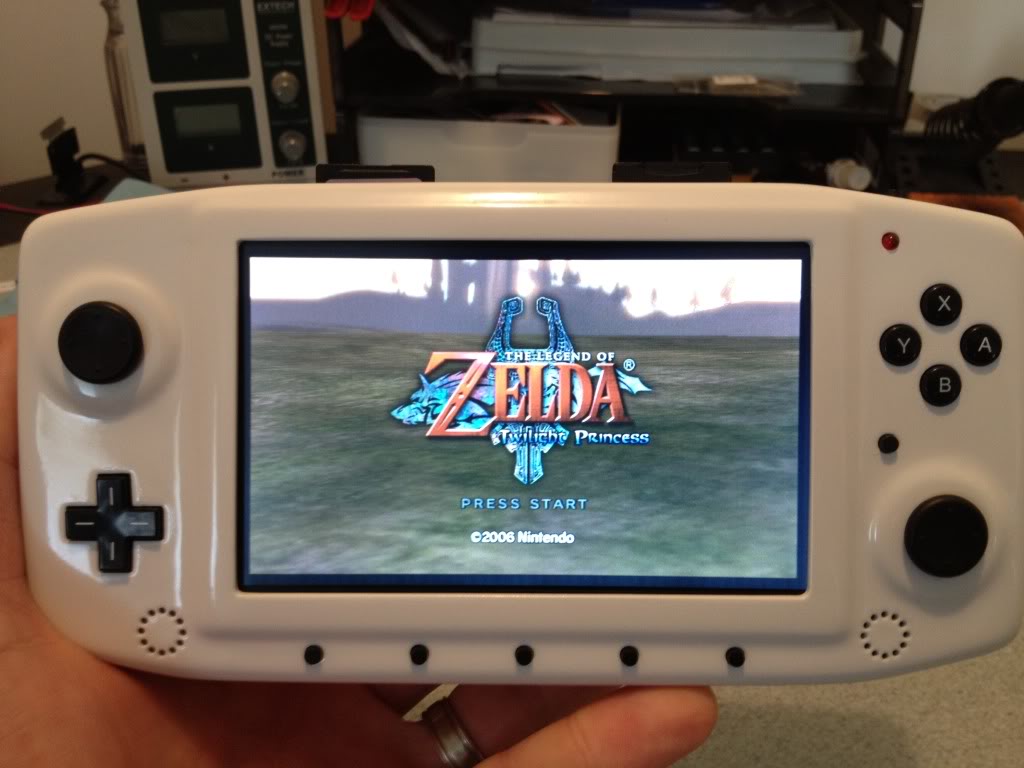

It pretty much an exact replica of the first with the obvious larger screen. Only other differences are that in this one I regulated the CPU and GPU seperately, so I should get better batter life. Also this one has the component cable chip installed for crystal clear 480p VGA display in all of the GameCubes glory. With Swiss flashed to the Wiikey, I can easily force ALL GameCube games from all regions to display in 480p and the newest SVN version of Swiss even supports forcing games to a "non stretched" 16:9 aspect ratio (see Zelda SS below), So even Beta can't bitch about the screen. ;)
Internals FTW:
This one was a real challenge to get closed on account of the larger screen and all the sheiled wires I had to Run to it for VGA in. Plus the other stuff I mentioned I crammed into this one that wasn't in the first. At any rate, I managed to keep it exactly the same thickness of the 1st one:
I swear to god I'm going to finish all the other projects I've got started now. No more GC's for a while. ;)
First unit with the 4.3" screen is for sale if anyone is interested. PM me and we can haggle, serious inquiries only, first come, first served.
