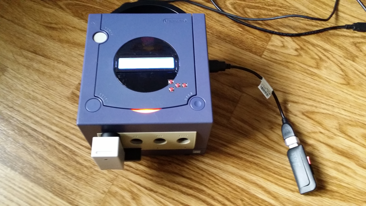

Post by pyroholic » Thu Aug 06, 2015 7:29 pm
I have gotten around to doing some more work, not so much development but now the FPGA is nicely installed inside the GameCube with the USB-port, network connector and all neat stuff available from the side. Image
I have soldered some internal wires to memory card slotA so the plan is to add memory card support some time in the future.
So far i have added support for the buttons so i can select game using them, currently very simple. I kind of regret putting a crappy character LCD in there but i have some more cases to modify so i will probably put in a more fun display in the end. I have actually played a lot also and so far no issues so that's nice.
(1.77 MiB) Not downloaded yet
