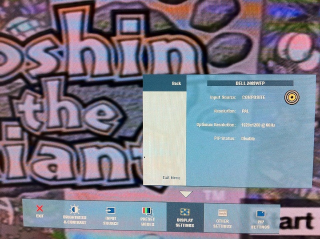

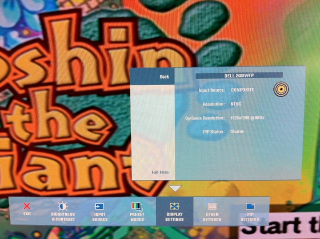

ok...your test results match up...kel01 wrote:I've tried a PAL disc on my NTSC cube with WODE and a Xeno installed now and the video mode worked correctly (576i 50hz).
I also wrote a bit about the video mode issue with imports at the bottom of this post when I had a PAL motherboard with the WODE:
viewtopic.php?p=10815&sid=901e2408a3a86 ... 446#p10815
Not sure if this matches with your results mega. What do you think?
i think...
this is what might be going on and this is why i think your info matches:
1. when you did that test, you first used eternal darkness backup...
wode requires a xeno to play backups with a GC drive...
2. when you got the original, you still had a xeno connected...
3. as i wrote in my test results:
for me:Xeno drive code breaks Wode ability to force import PAL title to NTSC display....
Eternal Darkness ( NTSC ) displays as NTSC with xeno
Doshin the Giant ( PAL ) displays as PAL with a xeno
Doshin the Giant ( PAL ) displays as NTSC with no xeno

so these results results match because Wode seems to ask the host console for its native region to allow forcing video of the title to the consoles region...
Xeno seems to affect Wode's ability to force video display...it seems to confuse Wode on which video mode to display and therefore it will default to the titles video mode...

i dont know if this is a new discovery but it wasnt in the WKF instruction manual...
(if one exists)...
it appears WKF has video region forcing....( i have no DVD drive connected right now )
1. select an out of region title from the WKF WBFS MENU
2. when the GC reboots, hold either X or Y till title starts and video if forced
3. if video is not forced, try the other button
4. if everything works, test the title to confirm forced compatibility
5. test another title
...currently my WKF has default settings: ON ON ON ON ON
...ill test other configurations later after the epoxy dries
here is my PAL title on NTSC console, both results are the same for composite and component
no 480p / 576p since the title itself does not support it...
DEFAULT PAL VIDEO:
FORCED NTSC VIDEO:
Edit:
Just had a thought: Luigi Mansion (PAL) on NTSC GC....better late than never??
(if one exists)...
DEFAULT PAL VIDEO:
FORCED NTSC VIDEO:
Edit:

Tried this today with my test setup. No go on video forcing in luigis mansion. I then tried doshin the giant. With doshin, my setup boots directly into 60hz mode, i'm assuming this because colors are displayed correctly. The image is still cropped though on ntsc tv. Holding buttons in during boot made no difference. Setting my switches to all on results in disc cannot be read after the gc reboots. :/
grrrr...
maybe differences in WKF firmware version???
ill run some more tests...
Maybe, my Wiikey was on 1.5, but I can test others also. I had limited time to test this morning. I'll get back with more results if anything changes.
