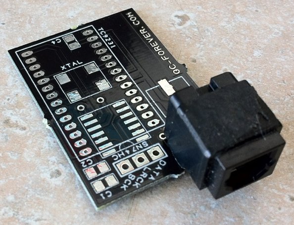

i wanted to post this before i forget again....
the pinout for the fiber optic connector is a direct pin match to the PCB..
so you can directly solder the connector to the board or run extension wires and header pins for quick disconnect...
more pics will be posted later of an actual installation...

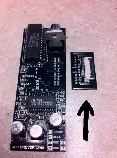

Re: Gamecube component cable
i have not received confirmation if the official component cables can be purchased...
the possibility of purchasing an external MEGA3 was dependent on if the official cable could be purchased ...
as of right now, it looks like the only possibility for an external MEGA3 is if it is purchased as "external ready"
meaning the FFC adapter board shown in the pic is not soldered onto the MEGA3...and the buyer can solder their own digital port connector instead or send me their own component cable and i will remove the digital port connector from the official cable and solder it onto the MEGA3.. (better off keeping the official cable and just buying a MEGAudio board)
if purchased as "external ready" and cannot acquire a digital port connector, simply solder the adapter board to the MEGA3 and install as internal mod..keep in mind, for an internal setup, 2 FFC adapter boards are required.
1 on the MEGA3 and 1 on the GC mobo...
or just direct kynar wire the MEGA3 to the bottom pins of the digital port
if any of these methods seem out of soldering/modding abilities, maybe it is best to rethink about purchasing
