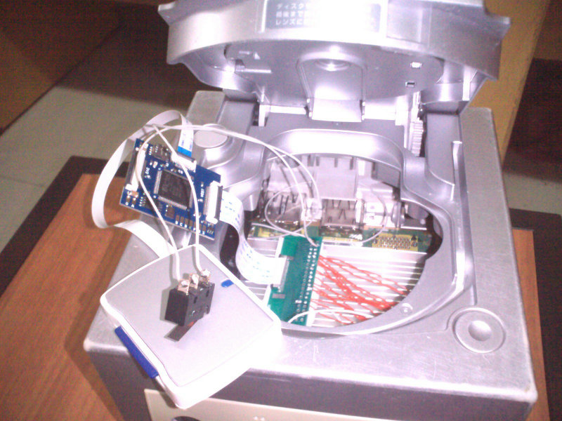

Post by bearteam » Mon Mar 21, 2011 9:14 am
Yeah, Wiikey Fusion finally works on my silver NTSC-J Gamecube with IPL 1.1. Here comes the pic.
It seems that Wiikey Fusion is incompatible to IPL 1.0. :(
(132.87 KiB) Not downloaded yet
Re: Wii DVD & Wiikey Fusion + GC Portable Discussion
Post by emu_kidid » Mon Mar 21, 2011 11:27 am
wow it looks like that GC has been put upside down on cement and scraped or had a bad encounter with some sandpaper!
bearteam
Posts: 152
Post by bearteam » Mon Mar 21, 2011 11:30 am
hehe, the silver one is hard to keep its shape.
Post by Ashen » Mon Mar 21, 2011 1:28 pm
Awesome bearteam! I'm glad its working for you finally :D Hopefully NTSC IPL1.0 is the only one we'll find incompatible.
justNer wrote:getting a bit confused by this IPL 1.0 - IPL 1.1, are all PAL GC's IPL 1.0?
or is it just DOL- 001 - REV - A?
It seems it doesn't matter for PAL cubes anyway. IPL v1.0 PAL is working.

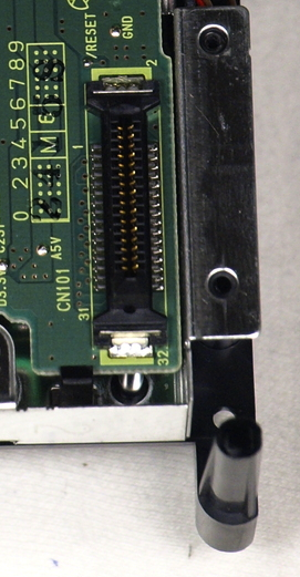

epoch
Posts: 54
Post by epoch » Wed Mar 23, 2011 4:38 am
Ashen wrote:The part that is the issue is the male connector for the GC DVD drive. If someone could find that connector with the pins attached I could easily solder up 100+ of them to an adapter board in a day or two.
Alas, the dvd connector is nowhere to be found. Therefor no solderless adapters.
The one labeled CN101 on the bottom of the optical drive assembly board? in the corner?
(296.9 KiB) Not downloaded yet
Post by emu_kidid » Wed Mar 23, 2011 4:41 am
yessir
Post by liquitt » Wed Mar 23, 2011 6:58 am
as i said, we should start collecting dead drives :)
