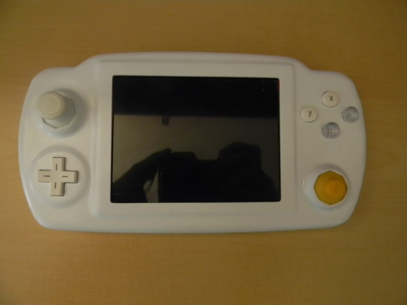

Little Teaser of roughly what the final product will look like. The Case's will be painted in the end of course. Right now everything is just taped in there, still A LOT of work to do.
I have to say that I kind of underestimated the amount of work that goes into case making. Cutting up the electronics and rewiring things is the easy part XD
On a side note, After I get the cases all done and painted I will be looking for someone to do some graphics for around the screen and possibly some other parts of the case. If anyone is pretty good with graphical work or has any cool idea's and would like to volunteer, please PM me. It will be GREATLY appreciated.

Post by liquitt » Wed Mar 30, 2011 1:31 pm
do you really want to paint this? white looks nice - and also just some really sleek graphics to go with that white would look amazing!
Post by Ashen » Wed Mar 30, 2011 2:39 pm
Well, You cant see it well in the pic but my vacuum former works almost too good. The suction on my vac table is so good that the wood grains in the mold that I used actually show through a bit on the outter part of the case. So it needs to be sanded smooth a bit. I could always pain it white (and for my unit I may), but Emu has already told me that he wants his indigo ;)

Post by Ashen » Wed Mar 30, 2011 4:31 pm
liquitt wrote:didnt even know you were building them for other people? :)
PM me a price :P
Well, at this point I hate to say my work will be comparable to a seasoned modder like Zenloc's but that is the plan anyway. I will be sticking close to his pricing strategy: http://forums.modretro.com/viewtopic.php?f=5&t=1667 While to some it may seem way overpriced. You have to consider that probably close to half that cost is build cost and the other half is the blood, sweat and tears poured into the production. In the end Zen's prices are very reasonable. I dare say though that before I take any more commissions I should ensure I can pull this off first. Provided I can, I will be open to build for anyone who wants one :D
If you haven't seen Zen's latest masterpiece I highly recommend checking it out: http://www.youtube.com/watch?v=HP74Cdufx6s
Dragoon wrote:Ashen, maybe you could help me with my portable? I have sucking dust in my room, but I want to get this baby to work :p
Btw... how the *insert any swearing here* did you get those coolers attached? They are smaller then the chips :shock:.
And how would you like to save? :p
I'm glad to help any way I can. The heatsinks are attached via arctic silver thermal epoxy. I'm not sure I understand the rest of what your asking XD
