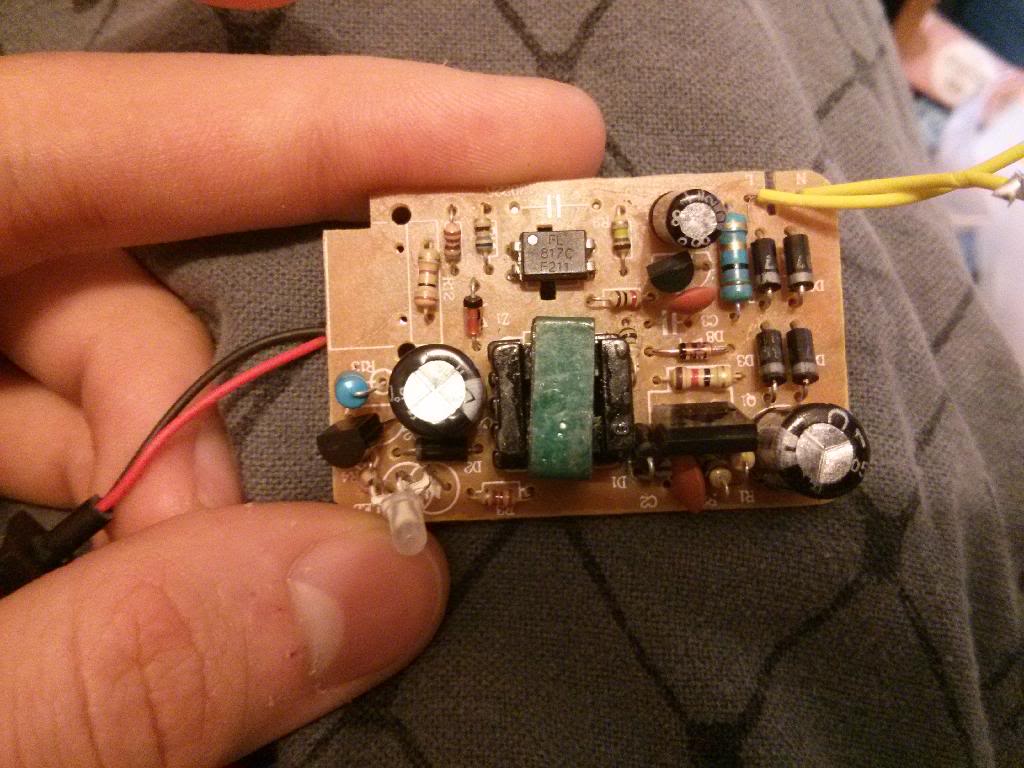

Also the plug that I got to charge the batteries was EU, so I went and changed the ends to US. This worked for a while until I tried moving the plug in to fit the casing better (it was plugged in at the time), this was stupid of me and the 120v prong touched the board inside the plug and 120v went were only 12v shouldve went and it sparked and now there is no green light that comes on when it is plugged in and it doesnt charge. My guess is this wall plug its definitely dead. The batteries and the cube how ever still function great. Here is a picture of the small board that was in the EU plug that came with the batteries.
My question is, does this only regulate voltage or does it have something to do with charging the batteries? I cant seem to find any small board or anything next to the batteries and am worried finding another charger of 12v with 500mA would over charge them.

If I were you I'd replace the fuse before assuming it's dead.
Also, check this out for the regulator : http://forums.modretro.com/viewtopic.php?f=36&t=2844

There is little protection circuits on your batteries to stop overcharging (cuts em off about 4.2-4.25v). You will want to take these off so you just have the positive and negative tabs exposed.
then do a search on ebay for a charging PCB. Check your terminals with a multimeter to assure correct polarity. The charging pcbs regulate the current and your stock nintendo 12v dc should charge em fine

Post by L10N37 » Sat Apr 05, 2014 9:09 am
http://m.ebay.com.au/itm/170653626822?nav=SEARCH cant tell by your photo.. my lipos had the little boards. You dont need em if thats what they are. The boards do this.
