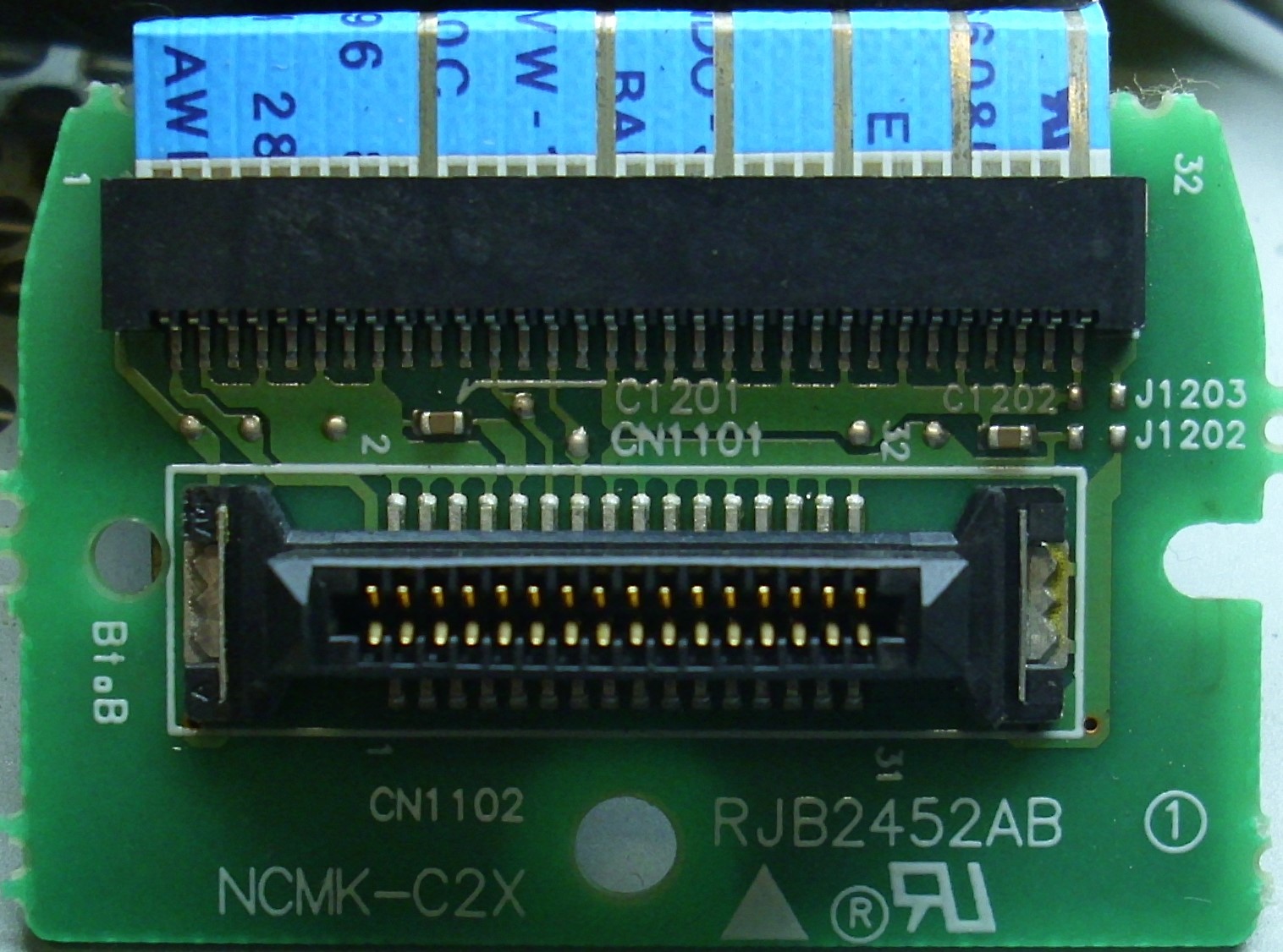

Put a microsd card slot if you need to save space (a smaller pcb is less expensive) and maybe a few test point with the microsd signals easy accessible if someone wants to solder wires to relocate the sd card slot.
I would personally appreciate the opportunity to have the dvd drive still usable (because I own a lot of original disks). The Panasonic Q uses a drive different from the one of the stock gamecube: the electronic is different and I think that the drive firmware is swapped when you switch from DVD mode to Gamecube mode. From what I remember the Q has a tray able to accomodate normal sized DVD but in gamecube mode cannot access them in the area normally located outside the size of a small DVD.
That said... the Gamecube mainboard inside the Q (that is almost standard) is connected to the drive with an adapter and an FFC cable so, if it's possible to have a pass thru to keep the original drive it could be possibile even to have a drop-in solderless version for the Q :-)

Re: DVD Drive Emulator Question
Post by novenary » Fri Aug 17, 2018 7:45 pm
The Q uses a small board similar to the megadrive v3, with an FFC that goes to the drive. The best way to support it would be to have an extra set of FFC connectors to connect to it + pass through to the DVD drive.
