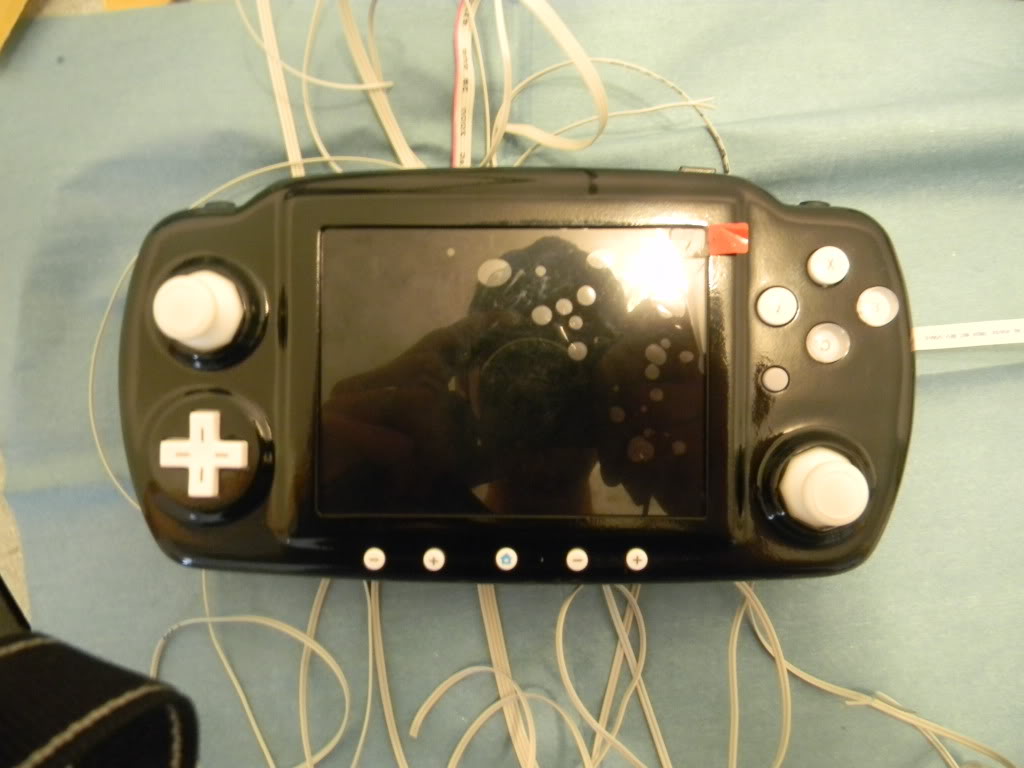

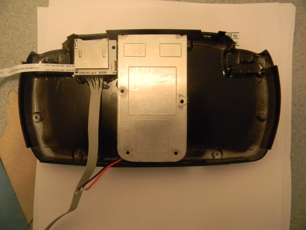

Little update on what I've been doing the past week or so. Not a whole lot you guys haven't seen from the last one, but I wanted to show I'm making progress.
Got pretty much everything mounted into the front half of the case of the 2nd GameCube Fusion. Controller is 90% wired up, tested and working after a full day of fighting with it. After ripping the first controller board out of the portable and wiring up a 2nd I discovered it wasn't working proper because of a wire I had forgotten to bridge.... The back half of the case looks rather empty at the moment but I figured I'd show it this way so you can see all the wasted space on both sides of the heatsink since I decided not to include batterys :/.
I had to repaint a set of L/R buttons black because I didn't like the way the first set turned out, So that'll be the only holdup of finishing this by monday. All thats left is pretty much just mounting the MB to the heatsink and finishing wiring things together.
