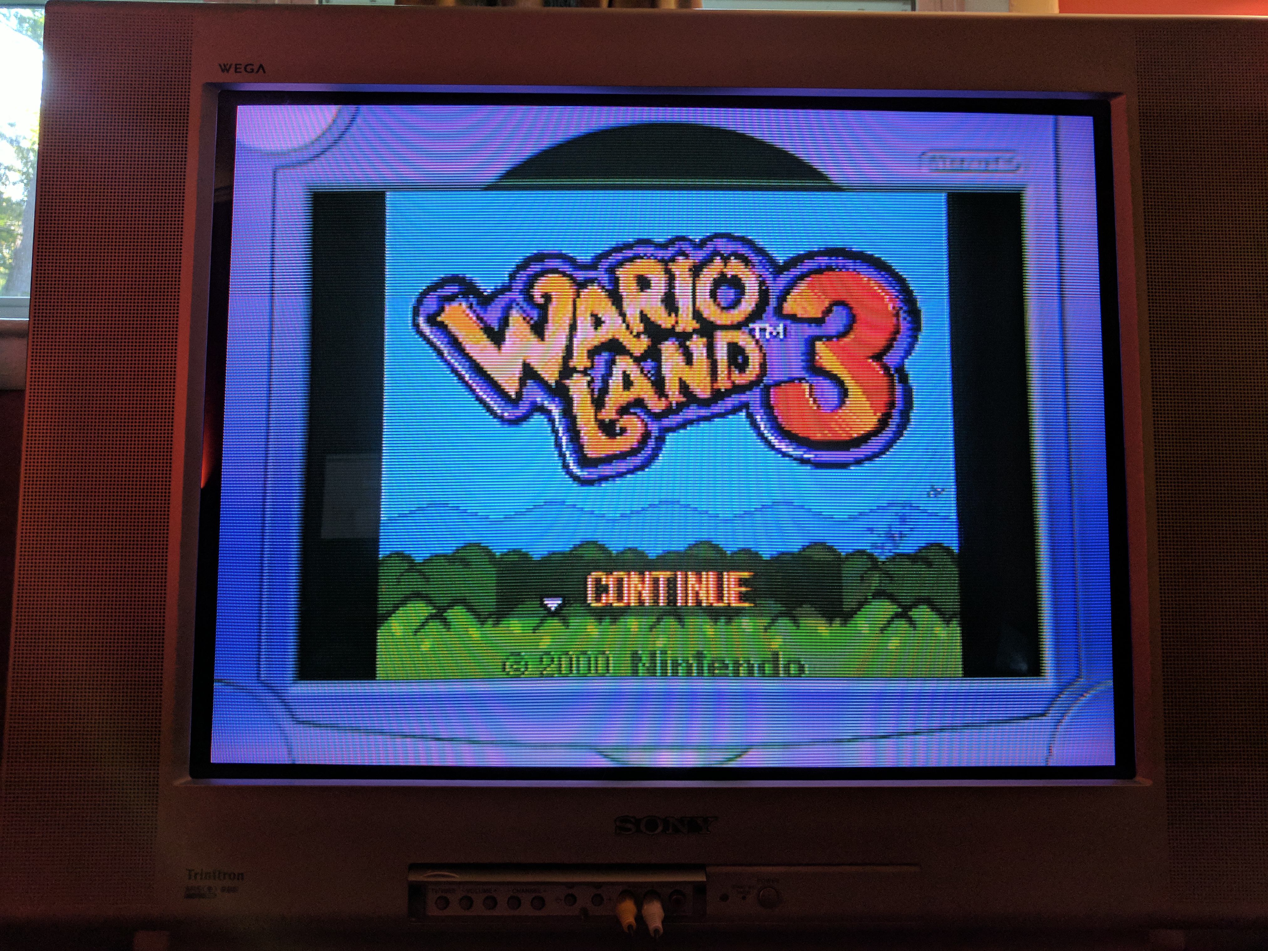

by pargordius
Extrems wrote:
  • Fixed one random kernel crash.
This actually fixed the crash I was getting! :D
For anyone interested, here is an .ISO suited for CRT TVs with a zoom level 2.375:
homebrew_disc_20170909_zoom.iso.zip
(1.33 MiB) Downloaded 941 times
It has these options:
--zoom=1.1875
--scaler=oversample
--scan-mode=interlace
--overlay=frame-srgb-x2.375-zoom.tpl.gz
I've also modified the frame-srgb.tpl to fit the zoom level (basically I scaled them all down). Add this to the GBI folder on your SD card alongside the normal frame-srgb.tpl.gz:
(239.05 KiB) Downloaded 899 times
I didn't specify an --overlay-id, so it defaults to the GC one, but I scaled all of them down.
Picture of the thing in action, using S-Video:
(2.91 MiB) Not downloaded yet
