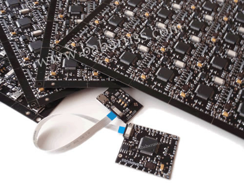

I have a doubt, I got a modchip that "babaruss" is for wii and xbox 360 to program the internal memory of the device and fix some appliances "bricks" that will be adapted like use it here in the gamecube (because next month I'll mount my hdd for dis-use here in the appliance, gamecube dol 001)
the chip would have any use for the gamecube if something changes?

No use at all, the gamecube doesn't have a nand or any kind of writable flash memory. A Qoob Pro is essentially the same except it lets you replace the whole IPL.
thanks emu_kididemu_kidid wrote:No use at all, the gamecube doesn't have a nand or any kind of writable flash memory. A Qoob Pro is essentially the same except it lets you replace the whole IPL.
but even if something adapter?
if I did something like Qoob Pro
because the chip is no use standing here

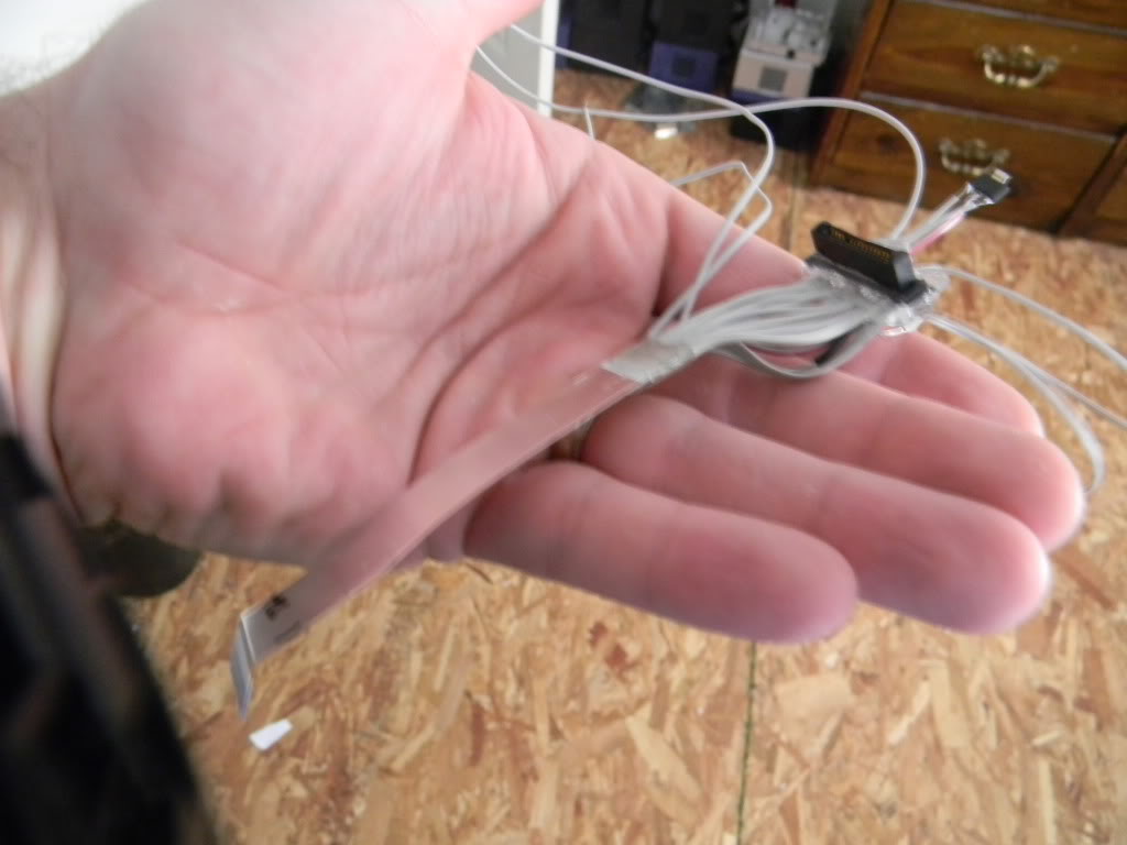

Glad it wasn't you adapters. Good to know about the firmware update. Gonna check mine when I have some time. Any pics of your adapters?? I'm curious to see how you made them. As I have around 10 connectors myself which I am also going to make adapter with. I plan on using a 5v to 3.3v step down just as you did to make it completly plug and play. As well as add an eject button.

They need cleaned up a bit, bit thats pretty much it in a nutshell. You can see the little step down regulator I used sticking out still in that pic. I've covered them all in epoxy and folded them back since.

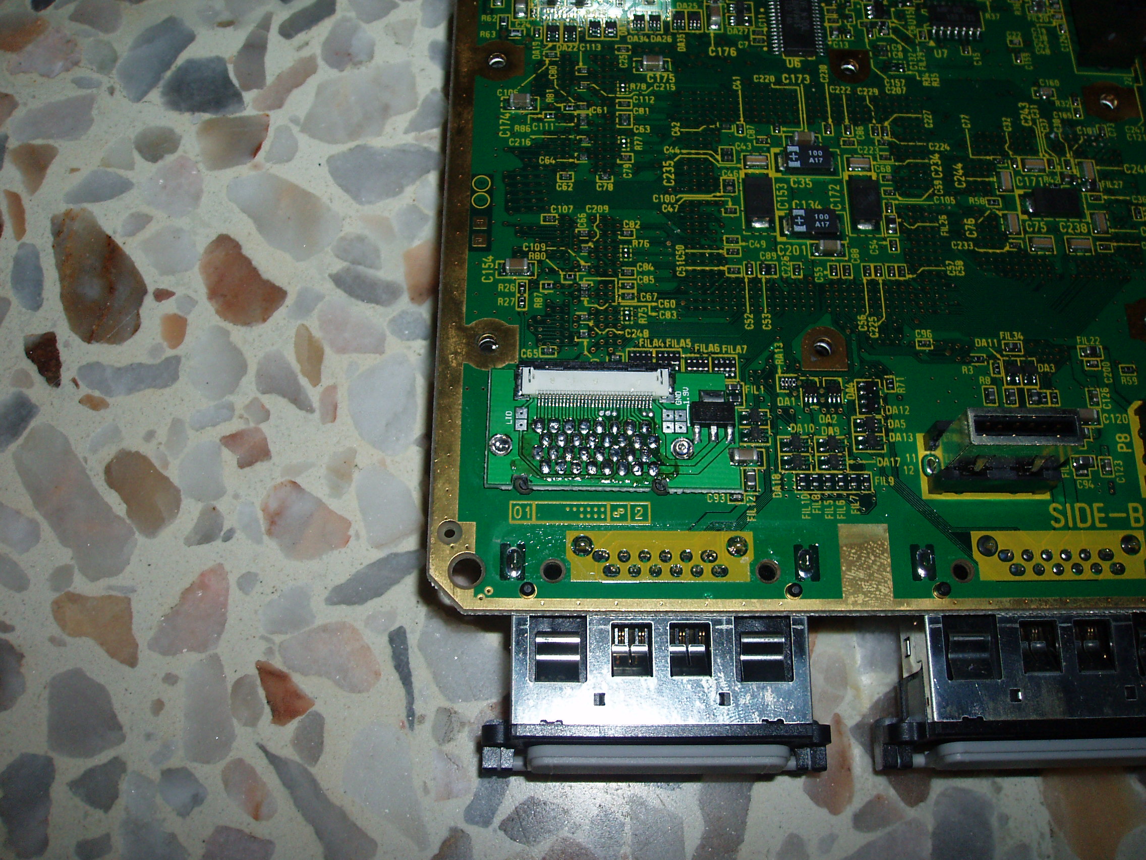

Adapter looks good. Some nice length there so people can play about with their placement. Good to see that it still works flawless with it being that long too.
With Ashen info I finally came out with this. compact and neat design. I plan to install to install WODE. Will try make it up n install it to test.
