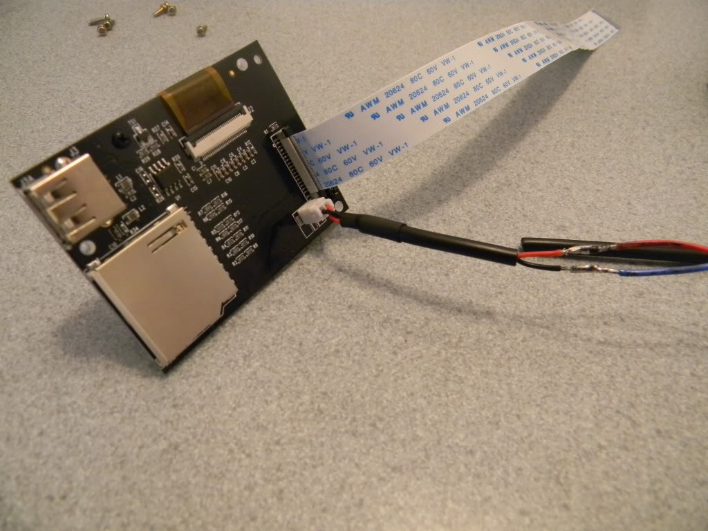

Planing to. but i need to test it to make sure it works. actualy this solder board was same as XENOGC soldering. now im thinking a way to supply the WODE board. A lot of test i wanna do like, keeping the existing mini DVD optical drive parallel with the WODE, and use Wii DVD drives out of the WODE mainboard. haha....if you guys have tested it, please tell me. hehe

I mean the power supply. the WODE needed 12v, 5v, 3.3v, and gnd for supply. im thinking a good way to connect the supply to the WODE.

Host Power SH connector. 12 way. 12v,12v,gnd,gnd,5v,5v,gnd,gnd,3v3,3v3,gnd,gnd.
Post by Ashen » Thu Jun 30, 2011 1:30 pm
For the WODE. The only power you need is 3.3v and 5v. 12v is not used at all. It may be possible to draw both the 3.3v and 5v from the Gamecubes DVD drive connector, I did not have time to do extensive testing on the maximum amp draw through the GC DVD connector port though. Which is why I made these connections separate for my adapter.
This is the connector that supply's the WODE with 3.3v/GND (its the regular Wii DVD drive power connector):
And here is where the WODE needs 5v/GND input on the back of the slaveboard to power the USB hard drives:
Hope this helps.

Nice work on the adapter board. I admit that I looked at the pictures before and didn't understand the fuss. Then I looked at them again and saw the adapter board in the lower left corner. It really does blend in.
