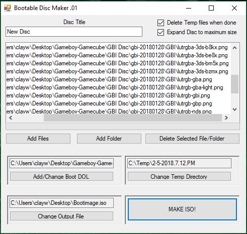

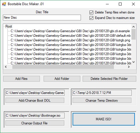

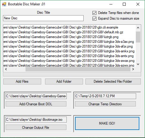

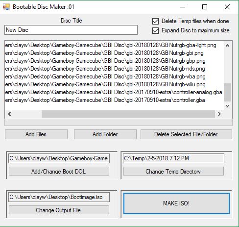

Could someone please tell me what I'm doing wrong here? I'm trying to build an ISO of the regular GBI in GC Bootable Disc GUI. Everytime I make the ISO, I load it in Dolphin and the window freezes, never loads and stays black. When I burn it to a disc for my Gamecube, it freezes also just moment after recognizing the disc. I'm selecting GBI.DOL as the bootup, and inserting everything else into the root. On this attempt, I didn't include GBI.CLI, GBI.DCP, or GBI.GCI. I have made bootable GBI discs with previous versions of GBI that worked perfectly. It is just this new version that Extrems recently released that I cannot get to work for some reason I don't understand. Thanks for the help!

It's the GC-Linux apploader panicking. You need to append 1024 null bytes to the DOL.
