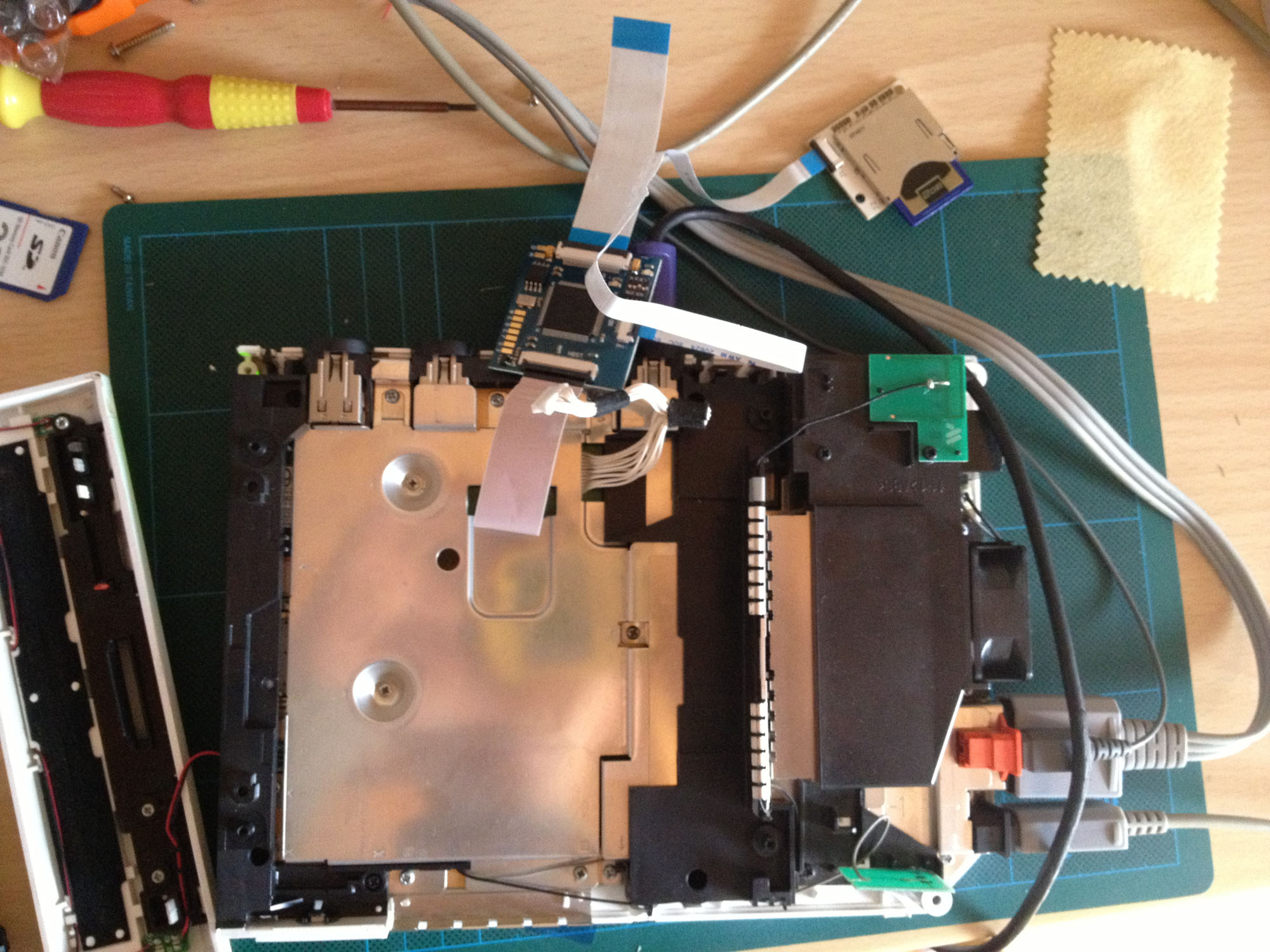

Last week. I bought WiiKeyFusion (WKF) (Clone Version)
I want put it on GameCube.
But I don't know the IPL of my GameCube.
So I found a old WII.
I put the WKF on my old WII .(Not Link the WKF and DVD of WII .because My WII have another IC.I'm not sure WII )
After finish Build .
When I go to the GameCube channle .The WII is Crash.
I'm no idea what can I do now.
(PS:I photo a picture and Record a Video)
Video link:http://www.tudou.com/programs/view/tlAgCUOcf4c/
What's wrong of my WKF
- (426.51 KiB) Not downloaded yet
Re: What's wrong of my WKF
Be sure to install an official MIOS, cMIOS/DIOS-MIOS will cause problems with the WKF. If I remember correctly MIOSv8 worked best for me.
