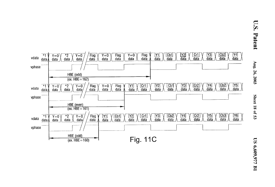

Re: Gamecube Digital Audio Interface board - Using DIT4096
i dont remember where i found this
you might want to double check the patent number to make sure its correct...
