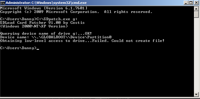

When I run SDpatch.dol ..It's the Action Replay without the Card
Went to the screen..then went to my Laptop to drag SDLOADER.BIN on the Card, Still getting a Blank Screen
This what I got
(14.38 KiB) Not downloaded yet
Posts: 4948
Re: SD Loader Action Replay
Post by emu_kidid » Mon Nov 11, 2013 9:24 pm
If you enable compatibility as Windows XP on the thing what does it do?

You need to run SD Patch.exe because it will install a small piece of PowerPC code in the reserved area of the card (where the FAT table/etc lies).
Without it you have no way of going from the 29 line code to SDLoader.bin because the code that SDPatch.exe inserts isn't there. If you have another GameCube or Wii that can run GC code, run SDPatch.dol instead to set up the card.
