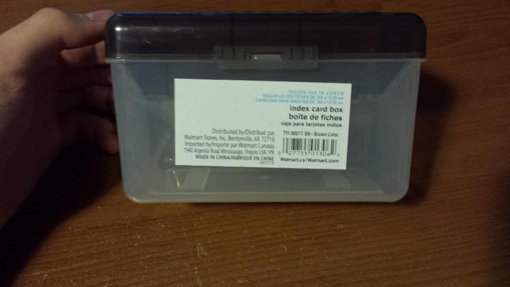

I found theese index card boxes at walmart and thought they could make a good case. So, I bought a few.
General placement of the bottom half of the case:

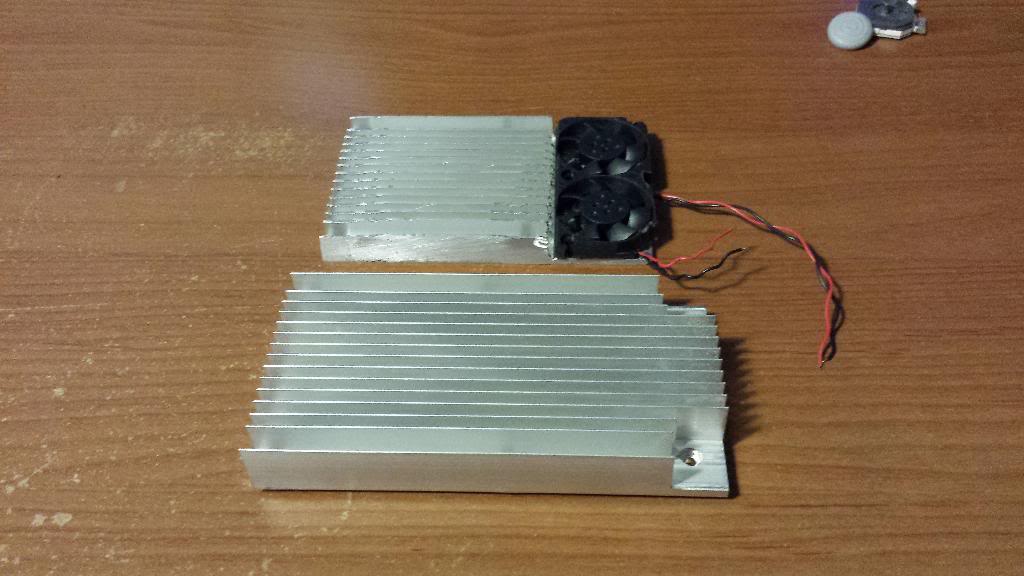

Heatsink:
Comparison:

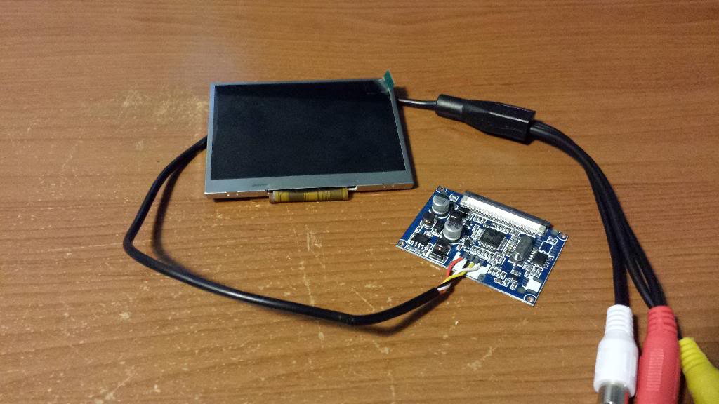

Screen:

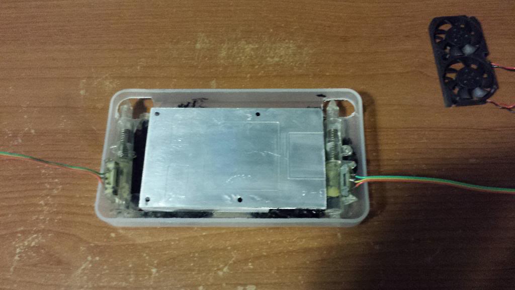

Motherboard:
Triggers: http://kyorune.com/modding/article.php?id=51

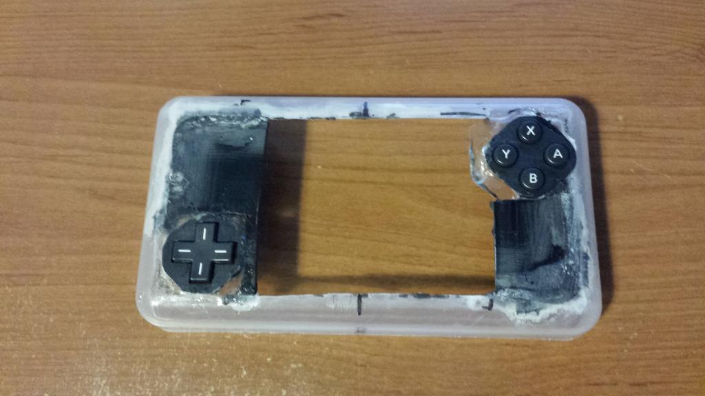

Slight progress:
Board cut to size:
Back filled and sanded:

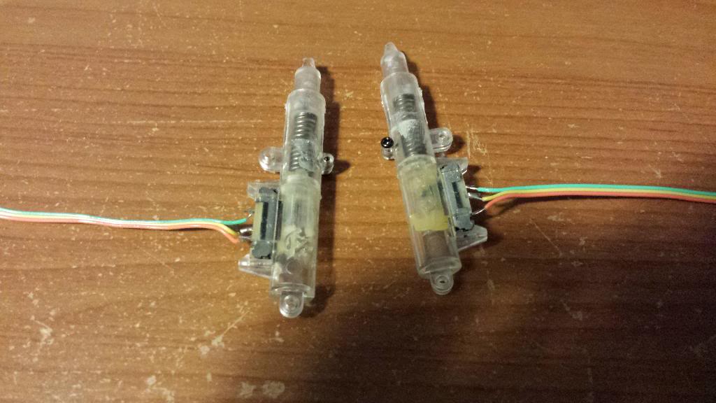

Where did you get those triggers - they look like they can provide partial trigger functionality.. I may not be able to fit the controllers gizmo that handles that job in my case.. would love a set of them.
Cheers
Oaisus
Posts: 16
Joined: Fri Jul 05, 2013 9:24 pm
Re: Worklog: unnamed GameCube portable
Post by Oaisus » Thu Mar 27, 2014 5:52 pm
L10N37
Posts: 60
Joined: Sat Jan 04, 2014 4:24 am
Post by L10N37 » Fri Mar 28, 2014 6:59 am
Thanks heaps, I owned dreamcast a few years back. Went through some boxes and found 3 aftermarket controllers - 2 were brand new :D First one I opened had the exact same sliders! Far better feeling joystick too!

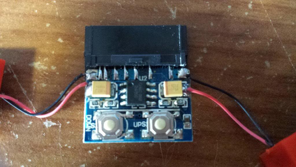

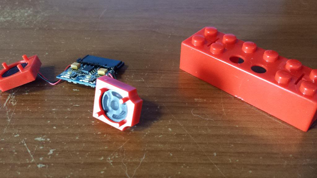

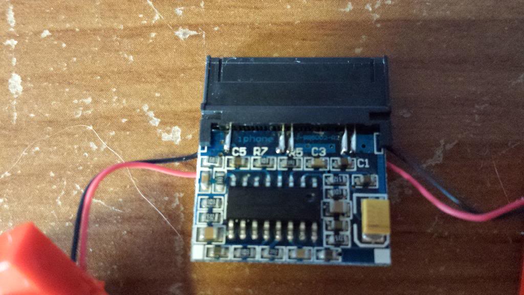

I just got my audio amp in the mail and I cant figure out how to wire it up. Can anyone help?

Post by iamdablasta » Sun Mar 30, 2014 1:03 am
Since nothing is soldered there, I am assume it is correct.
Edit: sorry guy below (not going back to check name cant bother), didnt see the component. My vision isnt the best. I though there were two empty solder points, but i was very wrong.

Post by Oaisus » Sun Mar 30, 2014 1:29 am
I'm having a hard time figuring out what you're trying to say...
There is a component in the red circle.
Post by megalomaniac » Sun Mar 30, 2014 2:31 am
that amp gets the LR audio, GND, and PWR from the iphone connector...
check the pinout for the iphone model of that audio amp

OK. I've gotten as far as making sound. But, it's really quiet. How do I fix it?
Diminuendo
Posts: 305
Post by Diminuendo » Sun Mar 30, 2014 10:28 am
are try upping the volatge to 5v, then 7.2 and 12 if your feeling gutsy

Post by L10N37 » Wed Apr 02, 2014 10:30 pm
No way above 5v will probably fry the IC.
If you have 5v, ground, and left and right audio wired cofrectly the amp should do the rest and volume control should work

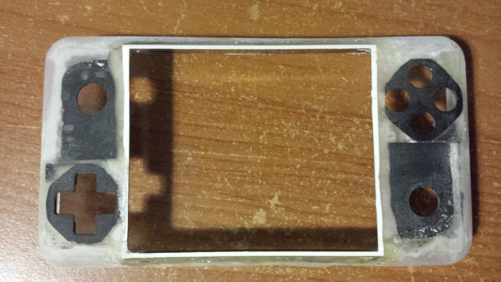

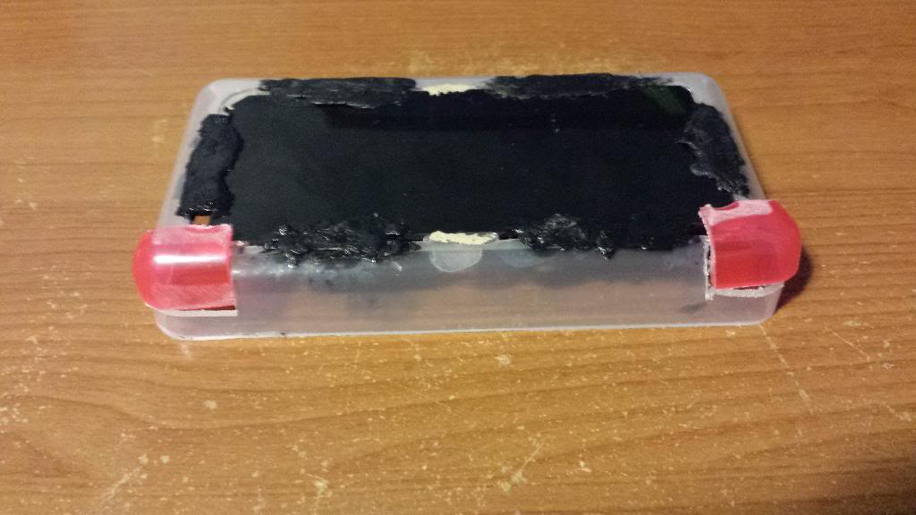

Anyway, here's some super sexy case work:
From this
To this
More later, I can't be bothered to dig things up right now.
