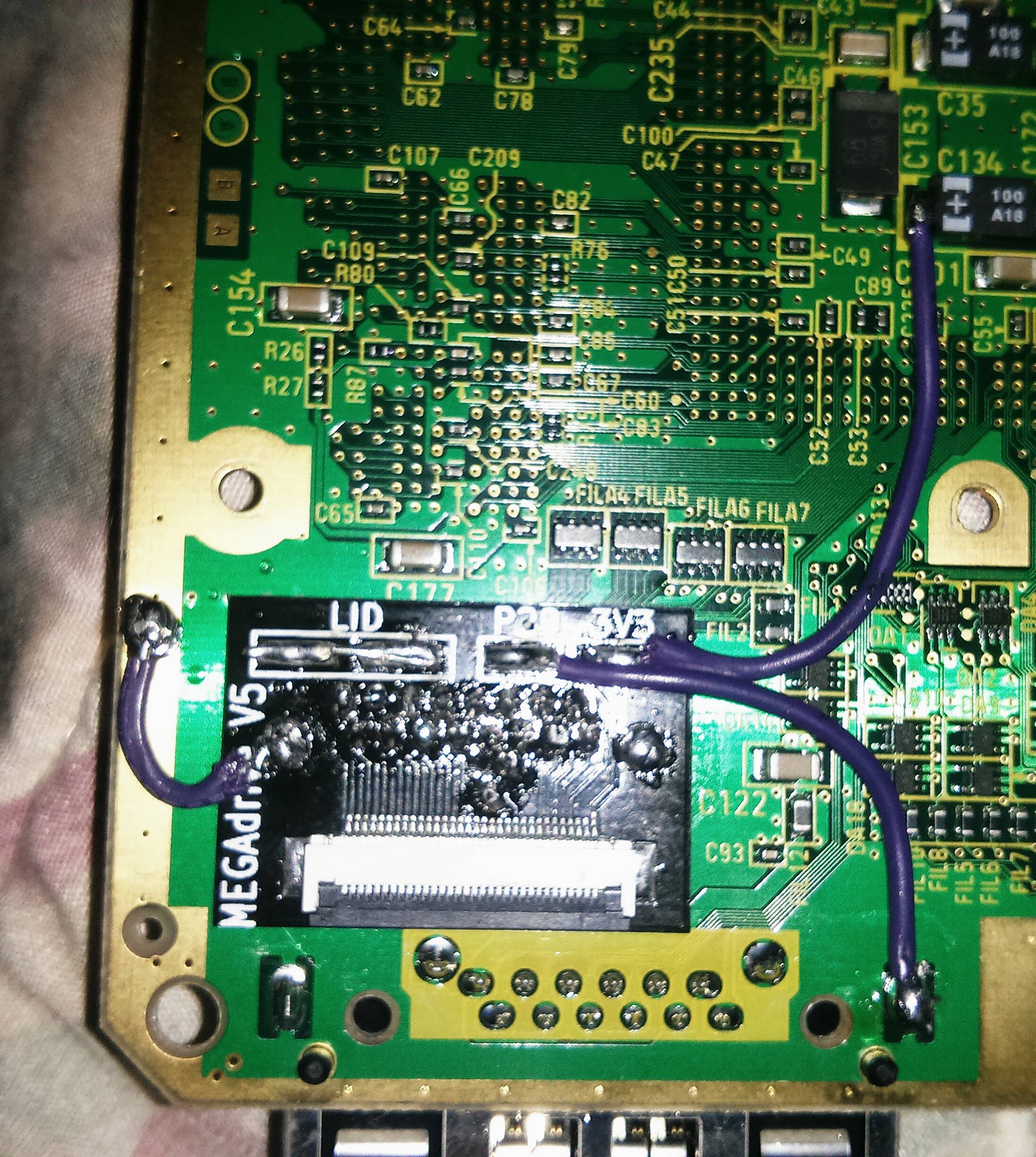

Before I start let me say that this device saved me a lot of time and a headache. So how easy is it to install as easy as installing a xeno GC which is very easy but if you have an dol-cpu-60/70 you will run into problems with the megadrive hitting the c177 resistor and the pads won't line up. This could be solved by cutting a slot on the megadrive itself but since I waited 3 weeks for it to come I didn't want to damage it. I just grabbed one of my older gamecubes and installed it. Also I needed to use pins to connect the megadrive to the pads on the mobo but not a big deal. Then getting everything back together was tricky because of the wasp being on the bottom of the mobo cutting the lower shield had to be done. After all that I turned on the gamecube just to find a error on the screen I found out the 32 pin FFC cable was defective when I bent it to one angle it works the other way it doesn't so I ordered 2 more from badassconsoles.com and now I'm using the FFC from my Wii but everything works fine. Great product and for 18 dollars there should be no reason not to buy one. I would wish that mega would have made it so you could install on top or the bottom. I'm quoting streetwalker here his idea was to buy two megadrive v5's and put one on top and one on the bottom now after installing one that would be hard for one reason you must turn the top megadrive so the pins will line up if you do the ffc connecter would be butting up with the heatsink. My idea to keep both dvd drive and WASP was to keep the dvd connecter on the mobo and sand down the bottom of the dvd connecter so the megadrive could be installed but that did not work since i had to use pins but even if all went well with my idea power would still have to be figured out I was looking at xeno fusion P.O.C but I will just keep it as it is for now thank you mega! I will post some pics later.
Posted some pics if your wondering why there is an extra wire is because after much soldering I have learned that you can never have to much ground
