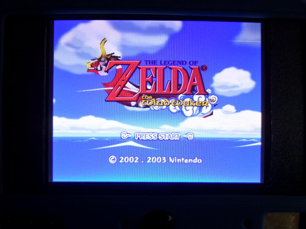

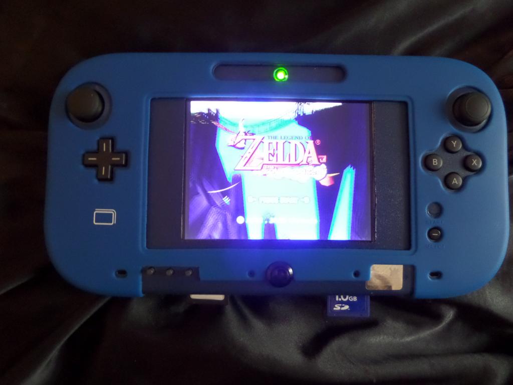

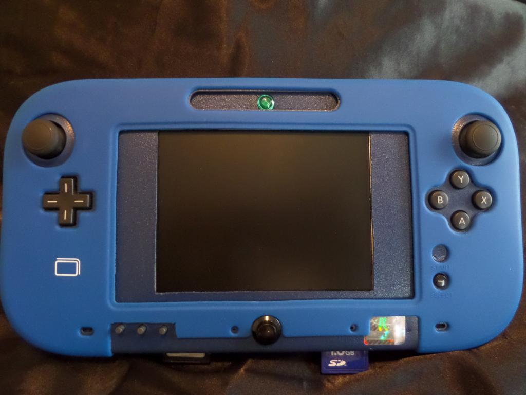

Hello everyone. I wanted to show you all the new portable that I made, appropriately named the CubePad Advance. The reason for the name is because I actually used a broken Wii U Gamepad that I acquired from a friend, I gutted it and used the controls and shell as the base for this portable. I believe I am the first person to use an actual gamepad for a portable mod. I also included the MX chip from a Gamecube component cable paired with a 5" Dalian Good Display for the best picture quality I have ever seen produced by a Gamecube.

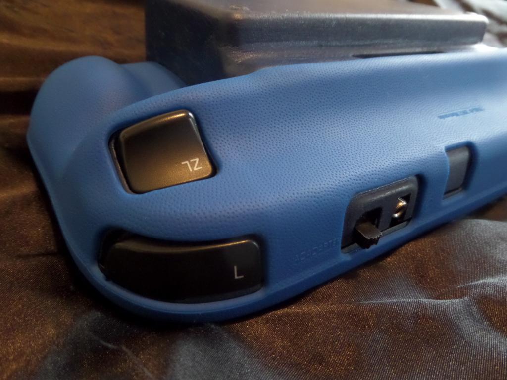

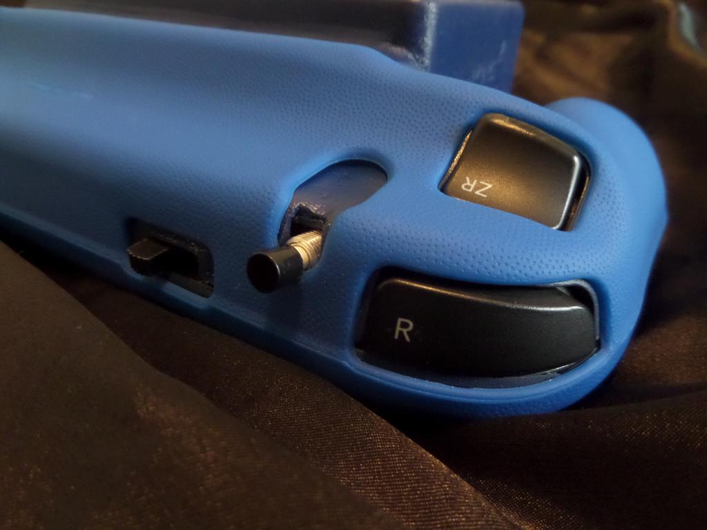

-Official Nintendo Wii U Gamepad Shell, Thumb Sticks and Buttons
-Official Gamecube Controller board cut to Ashen's specifications (Props to Ashen for this)
-L and R buttons modded using single tact method (Props to Zenloc for this)

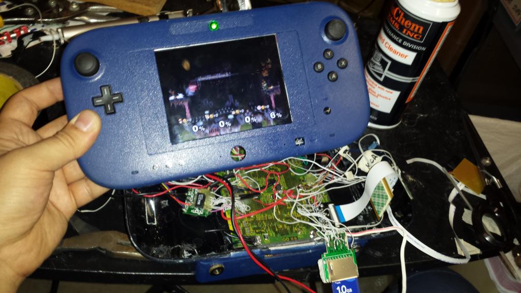

How is it with the cover off? Looks like you've put a layer of plastic over it?

It's an official Nintendo Silicone cover and I have it on just because it feels nice to me LOL. I have this picture of it from when I was building it that shows more or less what it looks like without the cover.
