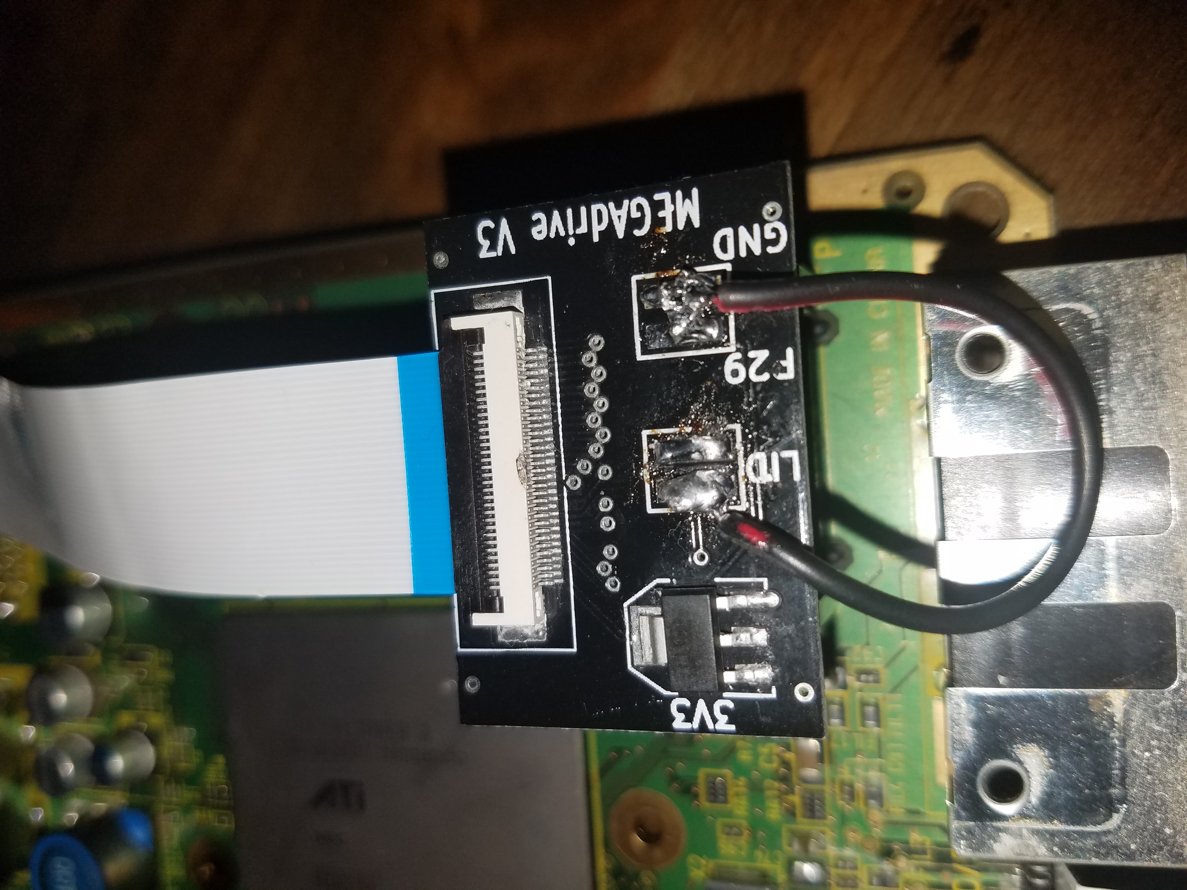

Hi guys this is my first post, so I'm sorry if something is not correct in my post, but I need help with something. My wasp is wired up with a megadrive v3 I have the right side lid pin and the p29 wired to the ground for auto boot, before I wIredell anything it just said to enter a disk and there was a light blue flashing lights on the wasp and would sometimes blink reading disc. Now that it's wired when I turn it on swiss doesn't load but it also doesn't show the gamecube logo it just boots to a blank screen weather an sd card is in or not I have a 64gb microsd with an adapter what do I need to do to get swiss to load and how do I getc the SD card to have games be read.

Only way to really help is to post some really clear pics of the wiring.

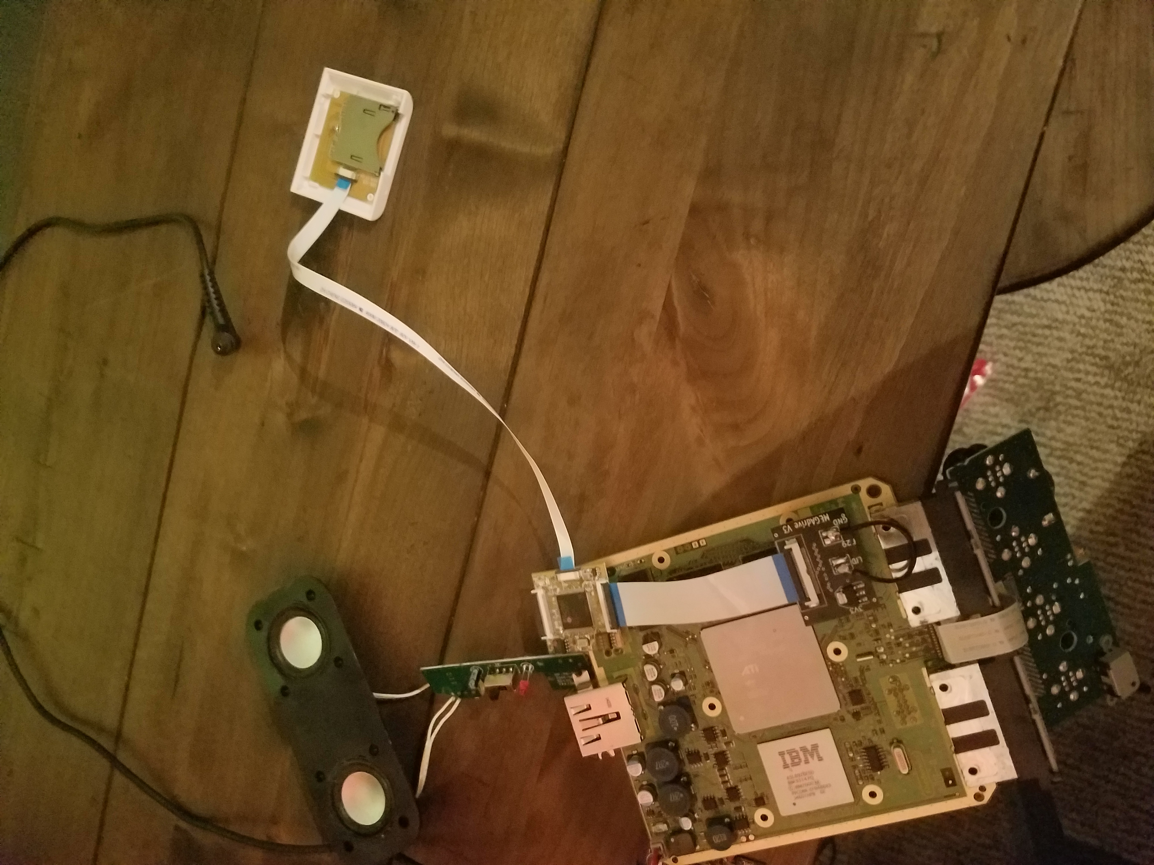

Post by Ires2953 » Mon Oct 17, 2016 12:13 am
Here are the wiring pictures
(3.27 MiB) Not downloaded yet
Wiring pictures

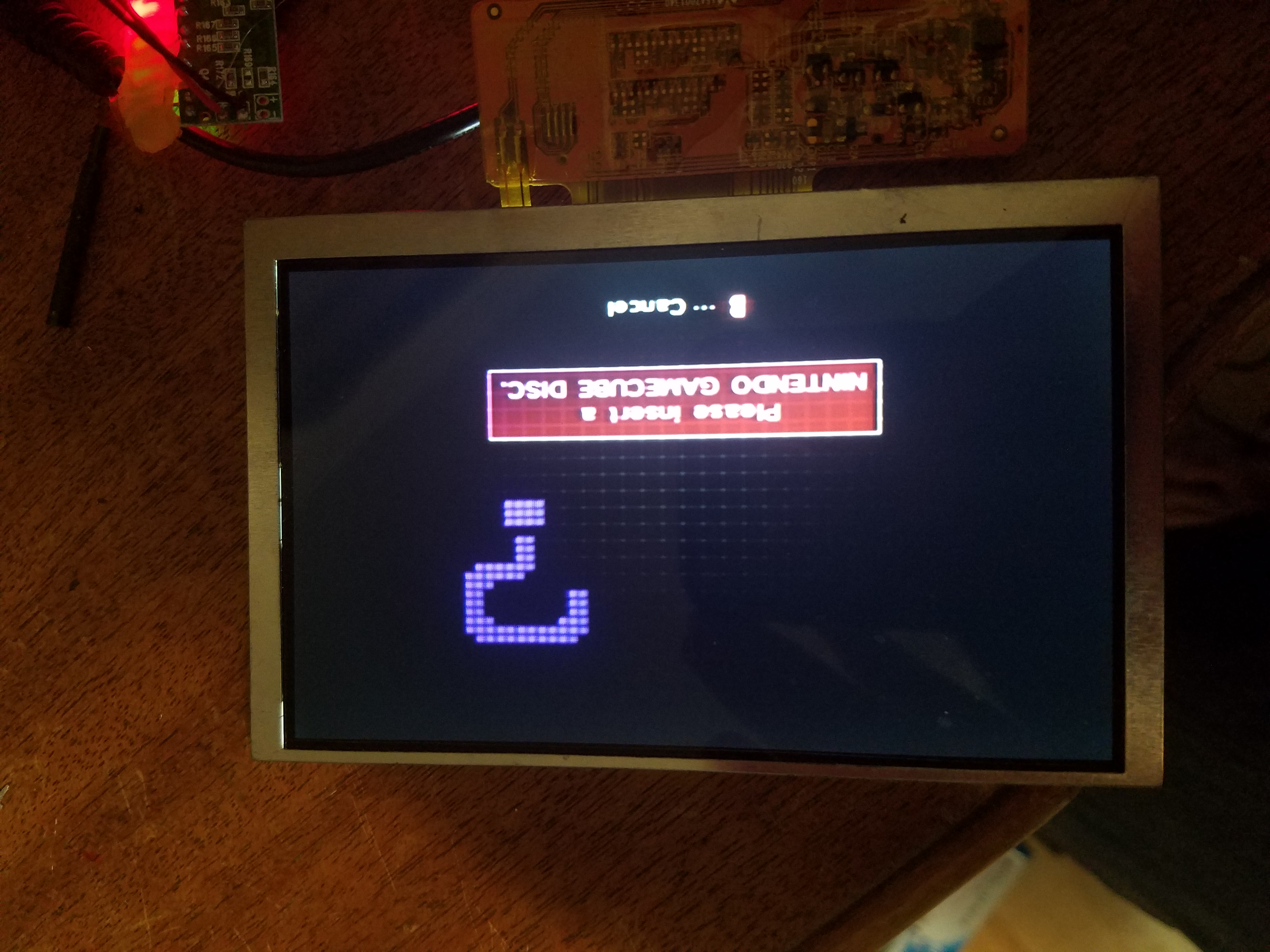

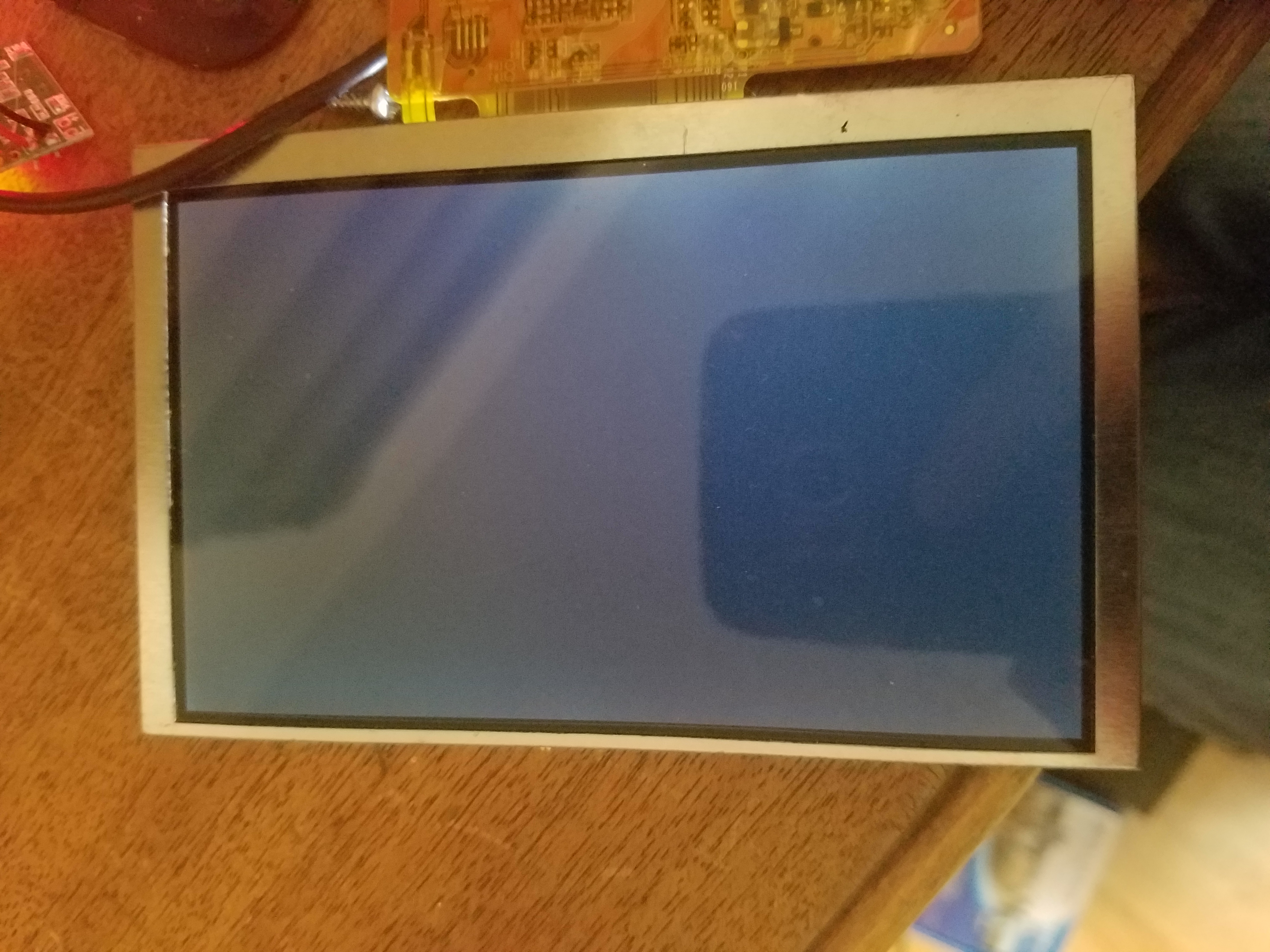

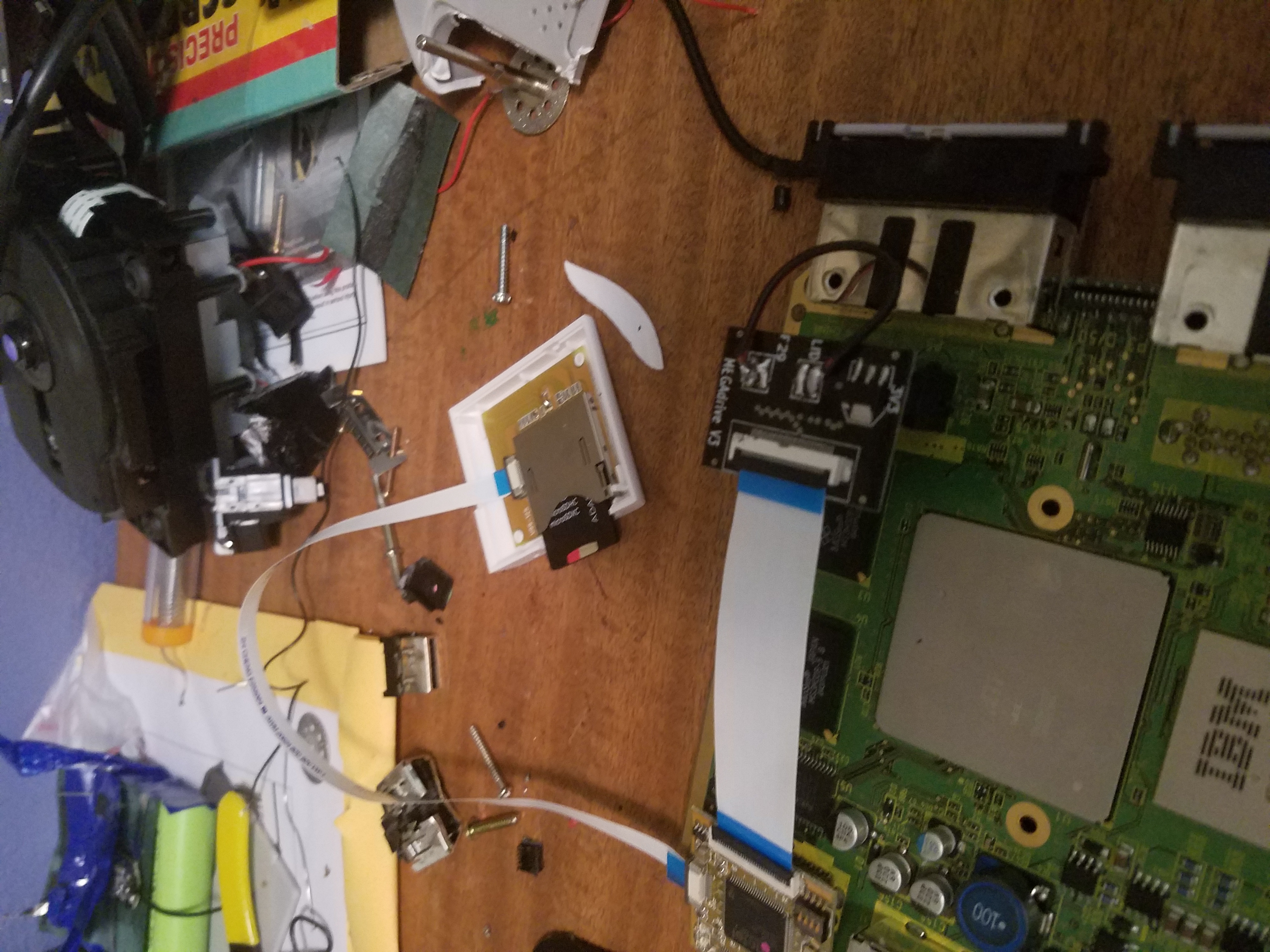

Ok so I formatted my sd as a fate32 and put it in still with the same result when it's all wired up blank screen but when the wire is desoldered it shows Insert disk/reading disk in correspondence with a blinking blue light on the wasp which seems to be normal, it blinks blue as well when wired but no display what can I do? There is nothing on the SD card by the way.
