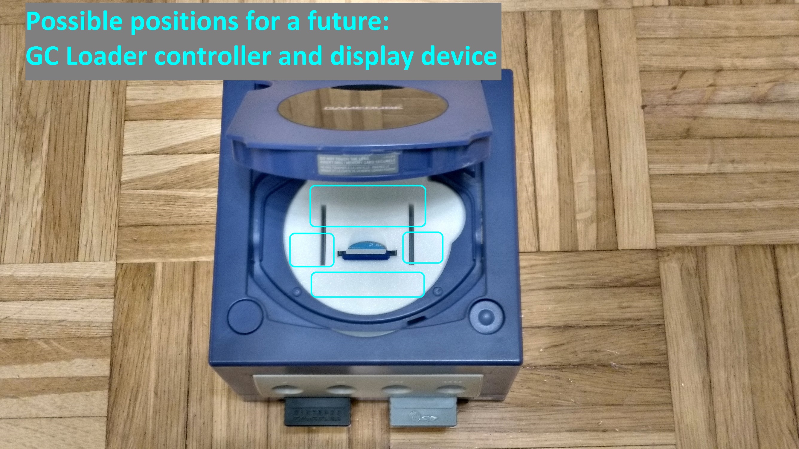

Please, could you (meneerbeer or someone else who is possible to do that) develop and provide an additional small device - with a (multiline) alpha numeric LCD display and some buttons.
A device hat can use the JTAG or the SPI connection to tell GC Loader which GameCube DVD image should be loaded / used.
Scrolling up/down of detected GameCube DVD image files on the GC Loader's SDCard should be possible with the additional small device.
The connection should be realized with the help of a Flat Flex Film Foil Cable / Flexible Flat Cable, so that the user can decide where to put the GC Loader controller device to.(left, right, behind, below the GameCube) - without keeping any GameCube door lid opened (because of the Flexible Flat Cable)
Like the WODE Jukebox is/was able to do.
Or like other current drive emulators are already able to do so, like the HxC floppy drive emulator: google (image search) hxc floppy lcd flat cable
The GC loader setting (currently loaded/used GameCube DVD image, is emulated GameCube Door Lid open or closed, GC Loader identification values/strings, ...) should be stored in a .txt / .ini file on GC Loader's SD Card then.
A solution with:
  • placeholder for the GC Loader controller device and display
would also be great:
(969.57 KiB) Not downloaded yet
I will definetly buy such a GC Loader controller device extension.
Thank you very much.
