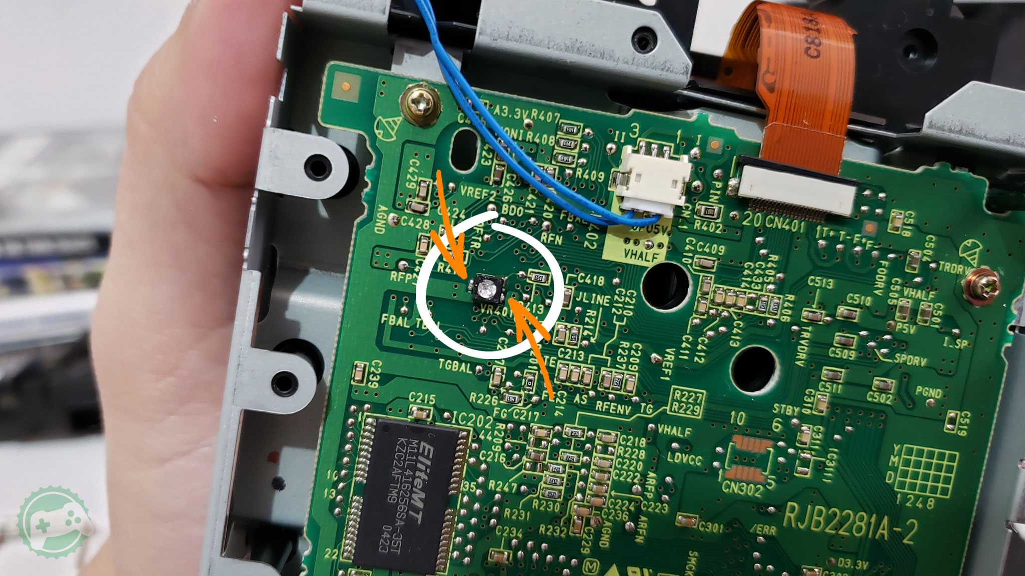

Well, if your original games are getting on without a hitch, that means you have to lower the Ohms rate on the gamecube's potentiometer.
this will solve your problem.
if your cube is a 001, it will probably be at 400 to 450, drop to 250 Ohms.
if it's a Dol 101, it should be 250, down to 150.
in reality, the ideal is to lower it every 50 ohms, until you get the Datel Disk works.
I believe you have a 001.
open the Game Cube, and do the work of turning it counterclockwise.
I think it will make Datel catch on.
see the potentiometer in the photo below.
adjust laser
(465.64 KiB) Not downloaded yet

Booting off a Datel disc proved to be hasardous, on the long-term.
Time to set up a game exploit, and save the pot tweak for later (and don't risk the lens to totally die faster, this way), no need to touch this risky part as long as you can boot original discs just fine.
You can at least try to dust off the lens with a very soft and clean paintbrush.

Post by emu_kidid » Wed Mar 17, 2021 4:29 am
It's not your lens failing (I mean they all are really to a different degree), the Datel/CodeJunkies discs are known to be notoriously hard to read even on lasers with low mileage.
The suggestions Papy.G made are worth looking into if you have an original disc of an exploitable game and a spare memory card.

If you can already open the GameCube, changing the lens is quite easy.
If you modify the value of the potentiometer, you will have enough time to purchase an ODE.
I think you need a good reason to keep going to war with the laser.

Changing the lens has proved to be a systematic fail, even the most talented ones didn't find any way to precisely adjust it.
Changing the whole optical drive assy is not a solution, as without a source for brand new ones, or refurbished, it needs a donnor that would be useless in the end.
