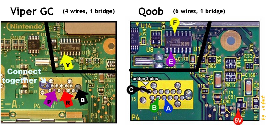

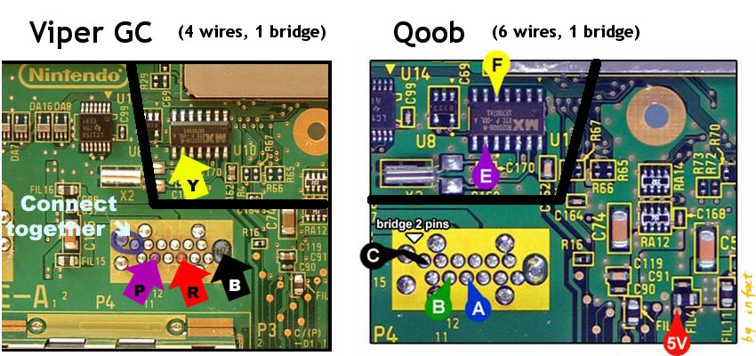

Is it hard to replace an already installed ViperGC with a Qoob Pro? Also how many do you have of each?

@Burbruee: Well, not difficult at all, you have to desolder the old wires and solder the new ones though.
See attached jpg.

speaking of that, is there an alternative for the 5V soldering point nearby? that one's a bi*** ;)

You can get 5v anywhere you want... ;-) When not sure, use the pin from the power board (see Ashen's pictures in this thread).
more info about the qoob 5v soldering point:
seen here: http://wiki.nintendo-scene.com/Qoob_Pro
When soldering the 5v wire for the Qoob Pro the gold soldering point might not accept solder without cleaning it first. First put some solder on the end of your iron then try to stick it to the point, but if after 2 seconds it wont stick remove the iron. Next clean the point using some sandpaper or a SOS pad (virgin pad w/o chemicals). Use a small brush or Q-Tip and apply some alcohol to the point. Next apply some flux to the point and then apply the solder. Make sure to only leave the iron on the point for no more then 3 seconds otherwise you risk heating up the board to the point where the resistor above the 5v pad will come off.

i was thinking about using that one. question is, if the original cable is long enough, thats why i was asking for an alternative nearby...but i could still extend it....
