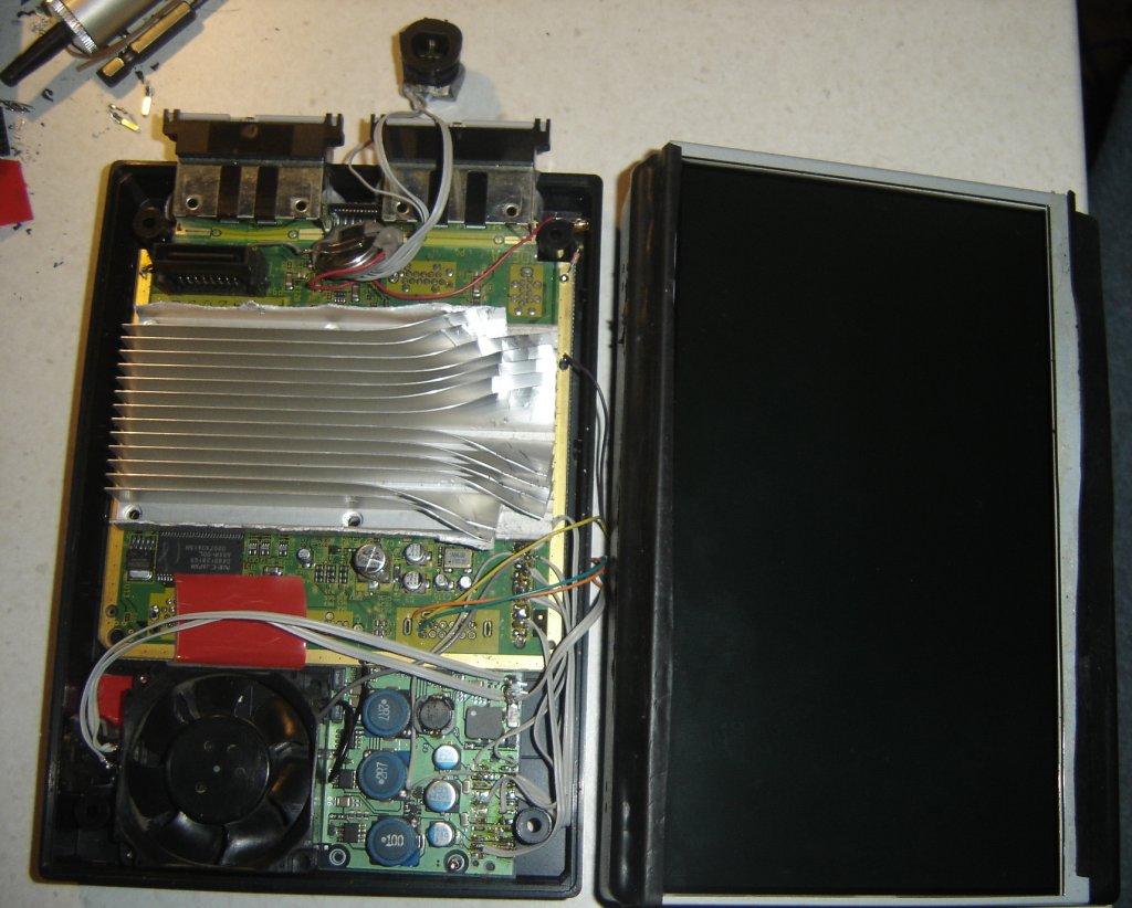

I've managed to get it working so far to the point that the bios will boot up and I can navigate around and use the memory cards/etc. It's quite rough in its current state and very work-in-progress. I've mangled a standard heatsink and have the stock fan for case ventilation but I will replace the stock heatsink with a trimmed 1cm heatsink (thanks Ashen!) + EeePc fan (2 fans, I know :p). At the moment it'll heat up too much to play it for more than 5 mins, so I'm waiting for the new fan and heat sink to arrive :)

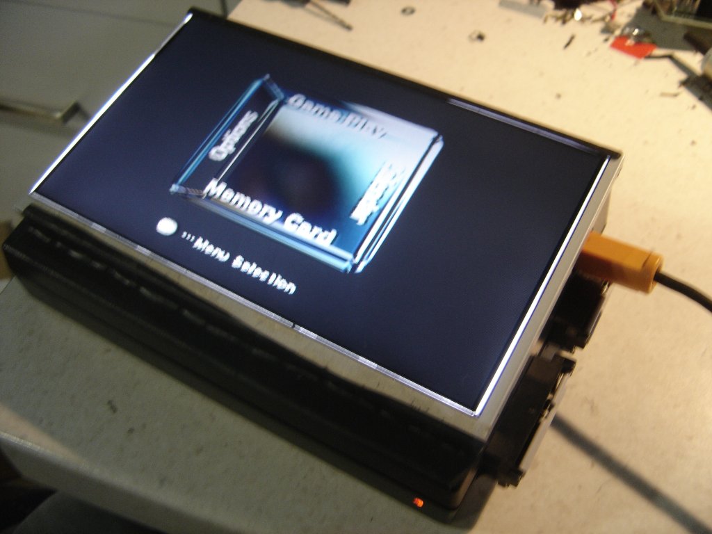

Up and running:

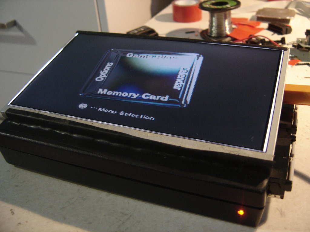

Power LED:

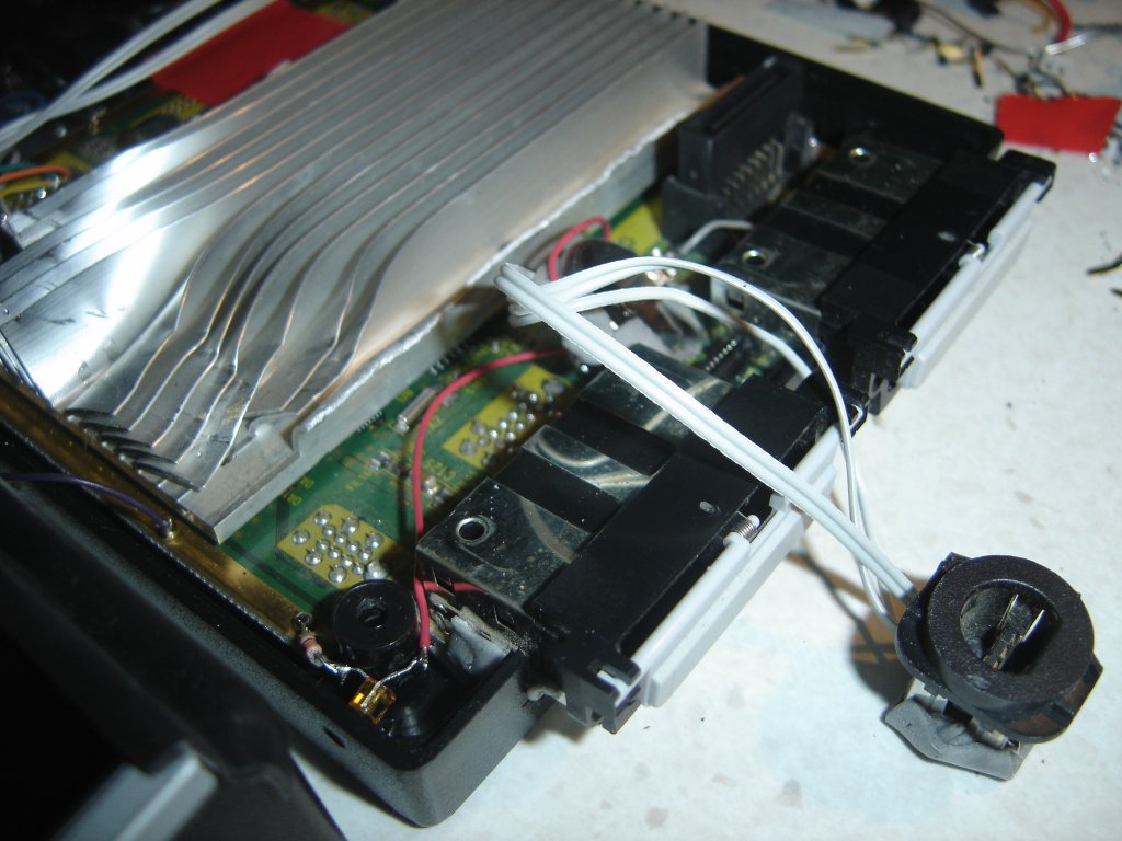

Controller port and memory card ports:

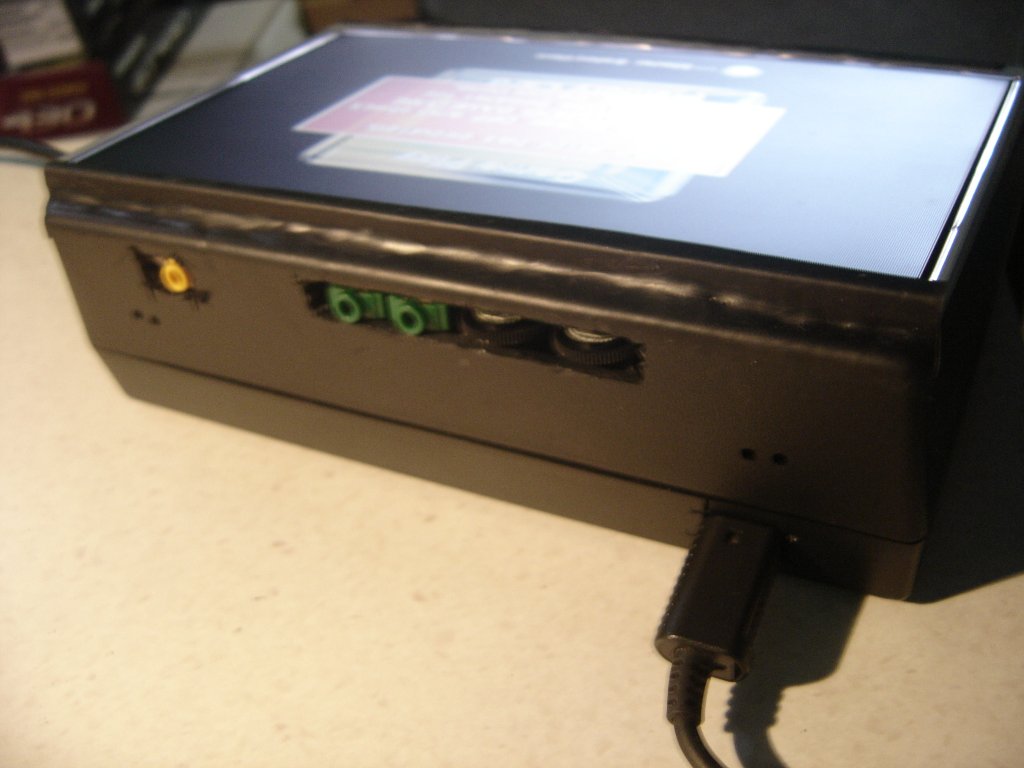

Video out, dual head phone out, volume and brightness as well as the power connector:

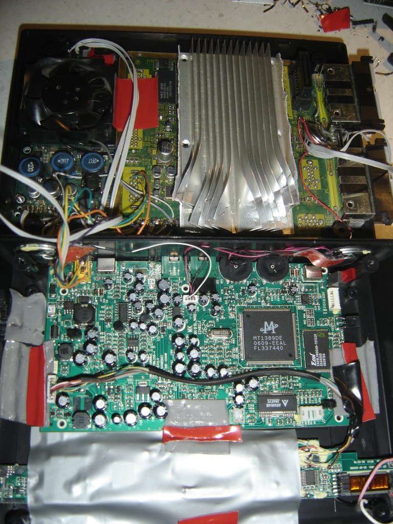

Inside (screen on the right)
Controller port, LED and (temporary) heatsink:

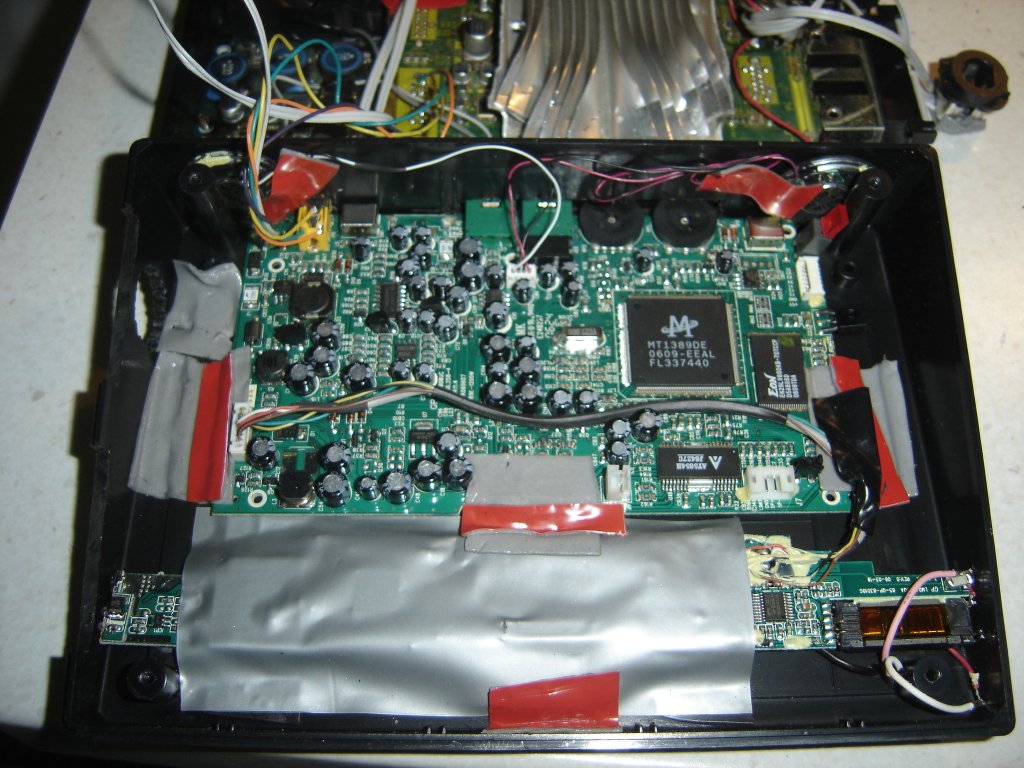

Screen PCB:

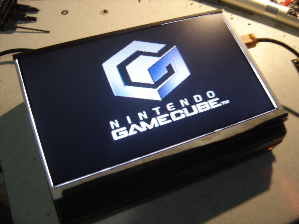

All in one shot:

It appears to be skipping even fields.
Not sure what's up with the scaling.

cheap screen, that's what :P

emu_kidid wrote:cheap screen, that's what :P
Screen looks decent enough to me, not sure what you guys are talking about.

Post by Extrems » Sat Jul 02, 2011 4:10 pm

I'm still not sure I see what you're talking about or what you mean by "skipping even fields" . Do you just mean interlacing?

that looks totally acceptable. what do you expect? 3D HDMI 1080p eyeporn? :D

Extrems, I tried the screen before on various games, I found it acceptable so I've used it :)

Things I noticed.. the unit definitely needs some more cooling or better sense of airflow. I've also not put any form of DVD replacement yet so it's a little pointless as I've removed one of the main features of a gamecube :P (but then again, I have so many - not that much harm done)
