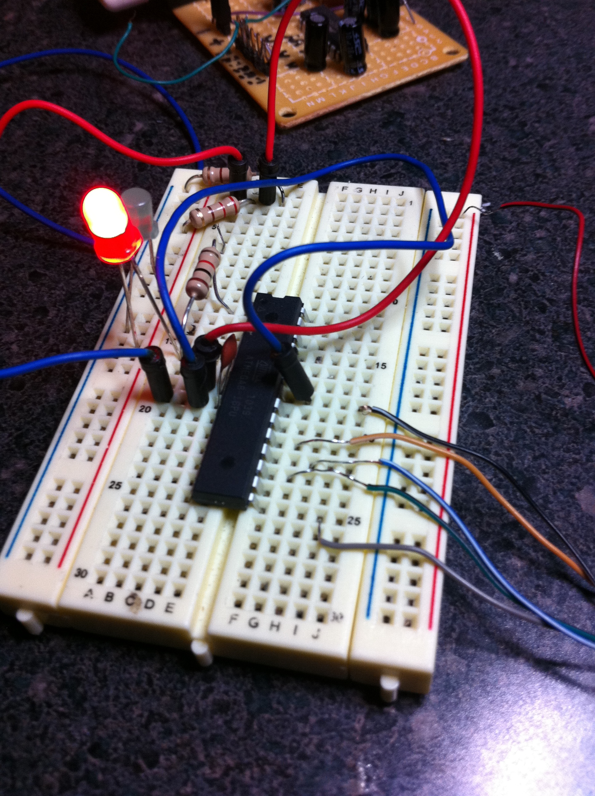

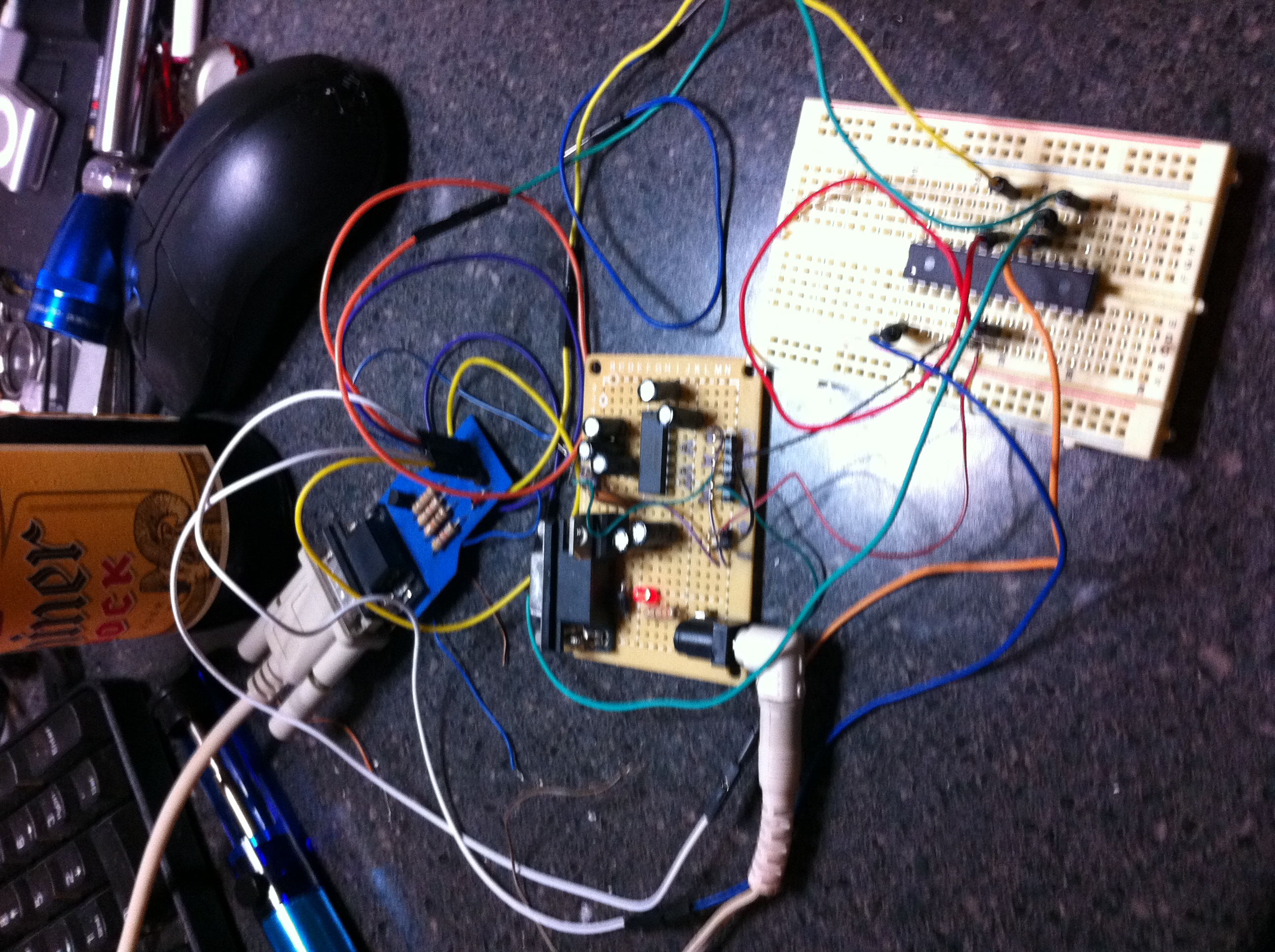

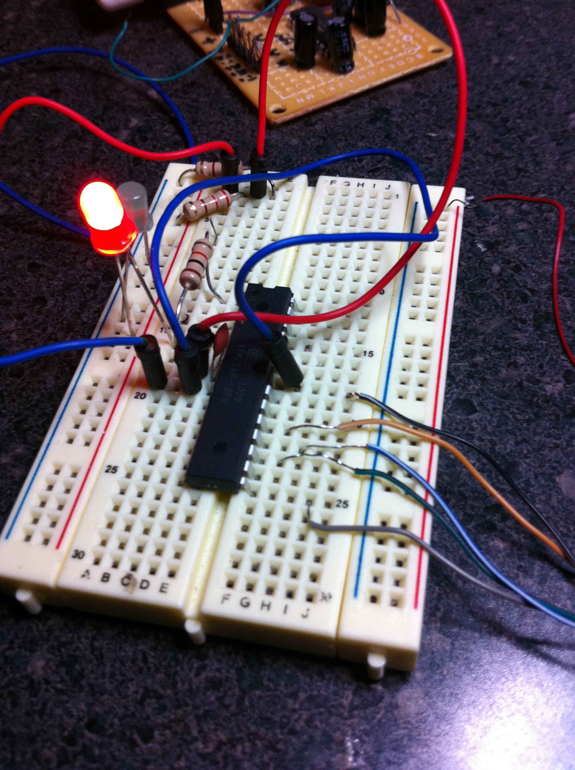

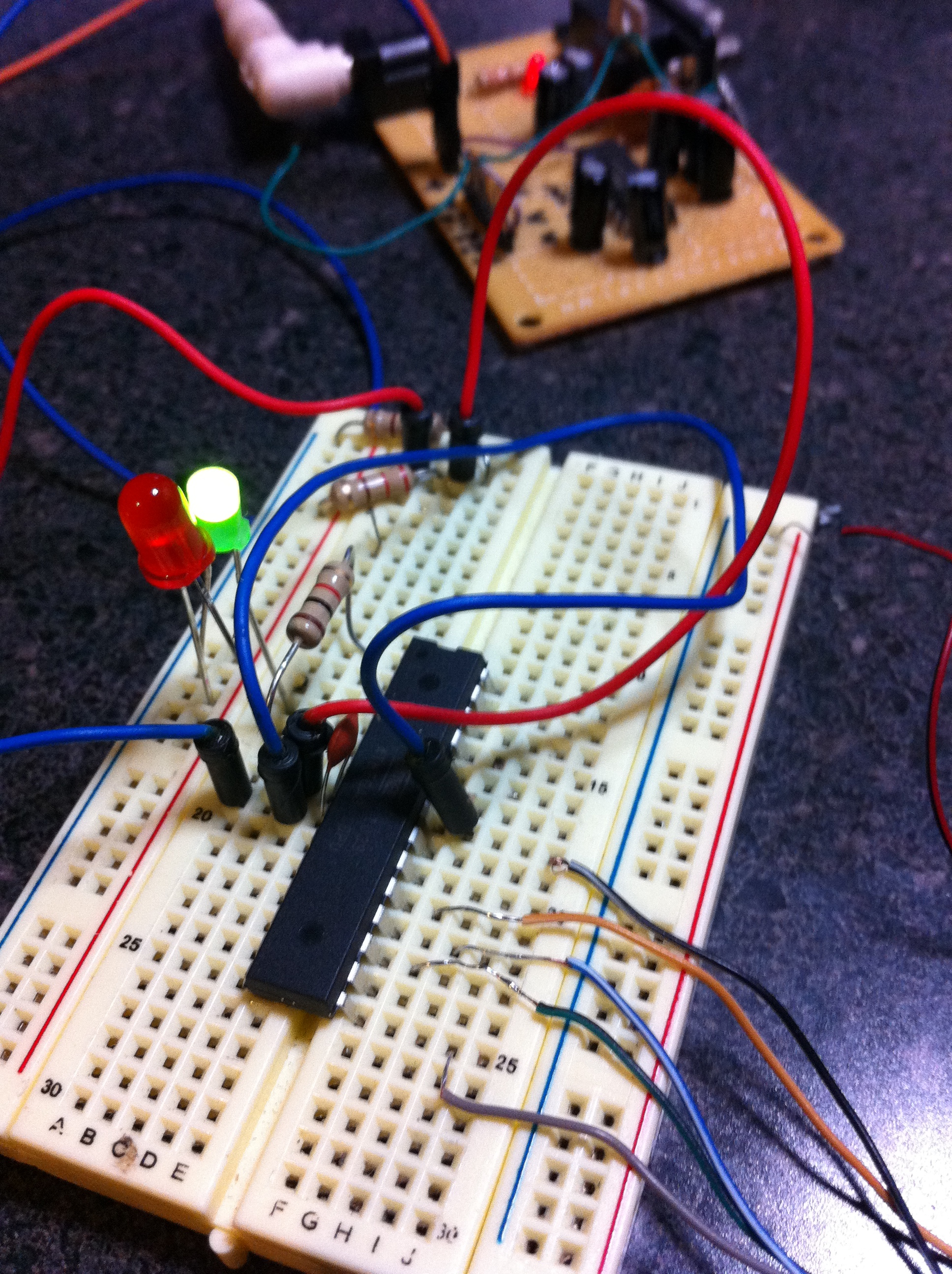

when i stated minimal components, i mean it. the programmer is simple but also needs a powersupply. ill have to test conditions to avoid burning out a GC when flashing but from past experience, it looks easy as pie and will work.
i have attached a horrid photo of my flashing kit i have used which can be built by anyone...
also attached is the AVRdude printout of the current programming progress. Next step, wait for my GC's to arrive to begin some real testing...

programmer w/separate 5v power supply

i had an atmega8 laying around so i decided to try flashing it to start the process of verifying minimal requirements to program/reprogram the chip. i am currently awaiting the arrival of some atmega8L's, until they get here i can always pull 5v from somewhere else (once my cubes arrive also.)
as for the Arduino, its a very nice device to have but its also a bit of overkill for this project considering the chip can be flashed using a simple handmade programmer/power supply consisting of only 5 resistors, 3 diodes, 2 caps, 1 7805, 1 BC547, 1 LED, 1 DB9, 1 power connector.
a programmer consisting of only 15 components total which can be bought for about 5$ -7$ or built practically free if the components are pulled from scrap boards laying around.
I question if the programmer will require on board power supply since the chip can receive power from the GC. This would require flashing the chip with the GC powered on...this might be unsafe (unlikely) but thats why i ordered more than one GC...just in case. Maybe add 2 extra diodes along the data line to isolate the programmer lines from the GC. This would be a simple addition but i would like to keep everything minimal.
Hopefully the power supply will not be necessary, this will reduce the total programmer requirements to only about 8 to 10 simple components.

Atmel AVR ATmega8 is found.
Fuse Low Byte      = 0xc4
Fuse High Byte     = 0xd9
Fuse Extended Byte = 0xff
Calibration Byte   = 0x9f  --  Read Only
Lock Bits          = 0xff
    BLB12 -> 1
    BLB11 -> 1
    BLB02 -> 1
    BLB01 -> 1
      LB2 -> 1
      LB1 -> 1
sumas

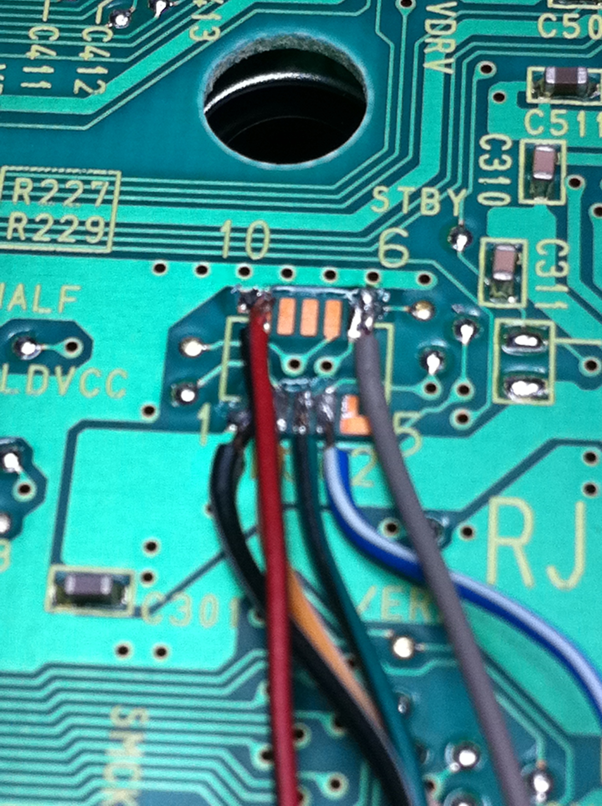

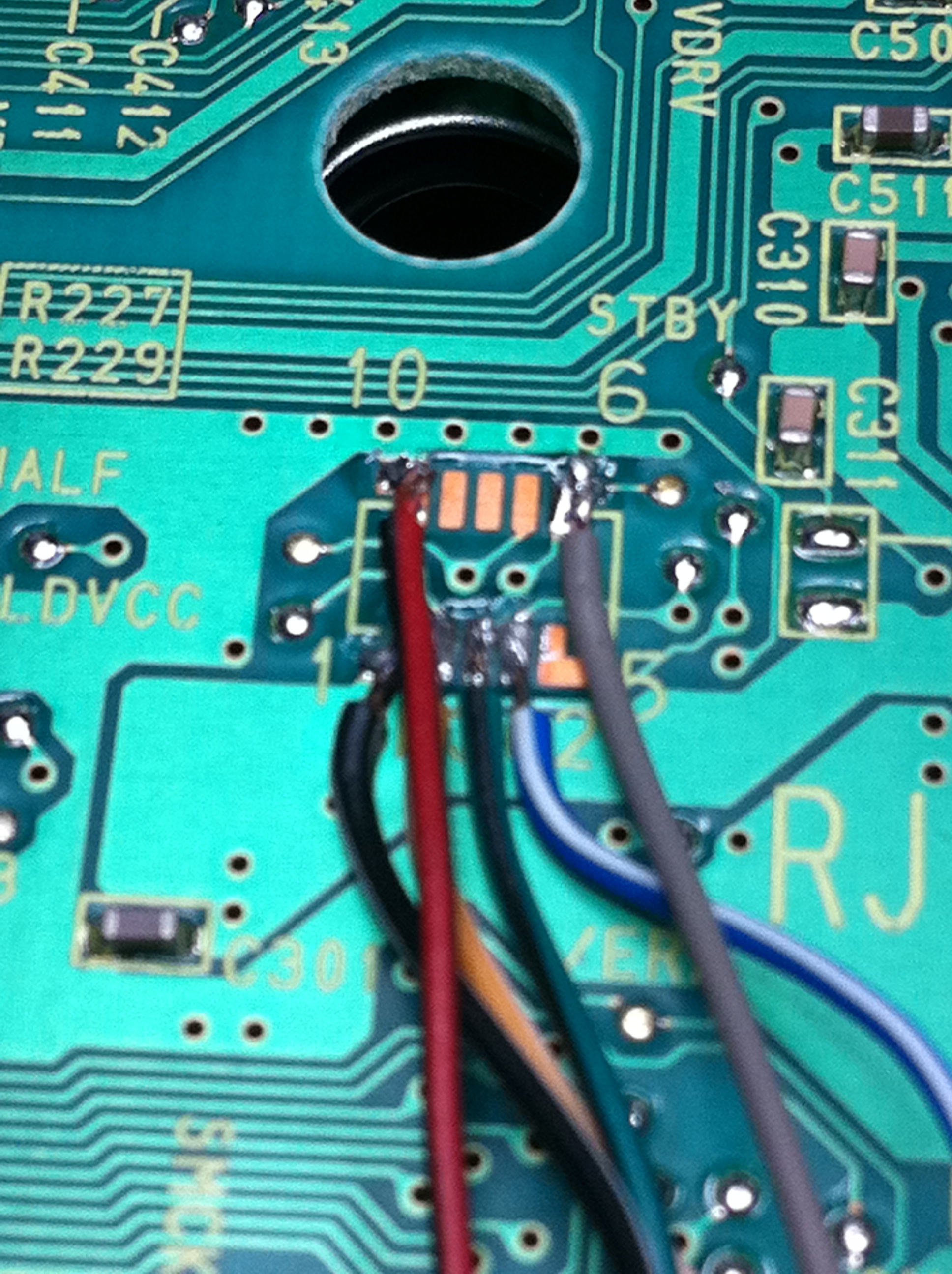

i finally put my hands on a GC today for the first time in about 5yrs.....There was a break in at my other home and they stole my original 1st day release GC. After such a loss with such a great companion, i just couldnt bring myself to get another GC...It just didnt feel right to have fun with some other strange GC.
Even the Wii didnt satisfy my needs. My relationship with the Wii was a mistake which was over almost as soon as it began.
So...since i have no emotional attachment to this GC i received today, i tore it apart for inspection. She was very dirty and in need of a proper douching to clean her out good. With all the dust dirt and grime removed i powered her on to see if she still worked after i fondled her insides for a while. There was still life in her and she appeared wanting and ready to receive the first of many surgical implant enhancements..
After the procedure, i put my hands all over her and started playing with her improvements to my delight. The surgery was a success with no side effects or complications. Its been a great first night. She is a fun and dirty little slut that likes to be treated bad...
...This might be the start of something special
here's the pics of our first night together...and i also made a low budget sex tape of us in action
....Quiet!! Surgical procedure in progress...
(1.25 MiB) Not downloaded yet
Inspecting the enhancements
(1.84 MiB) Not downloaded yet
She is ready for some hot action
(2.01 MiB) Not downloaded yet
the_tape.mkv.zip
Caught on film, lower speaker volume
(2.85 MiB) Downloaded 702 times
