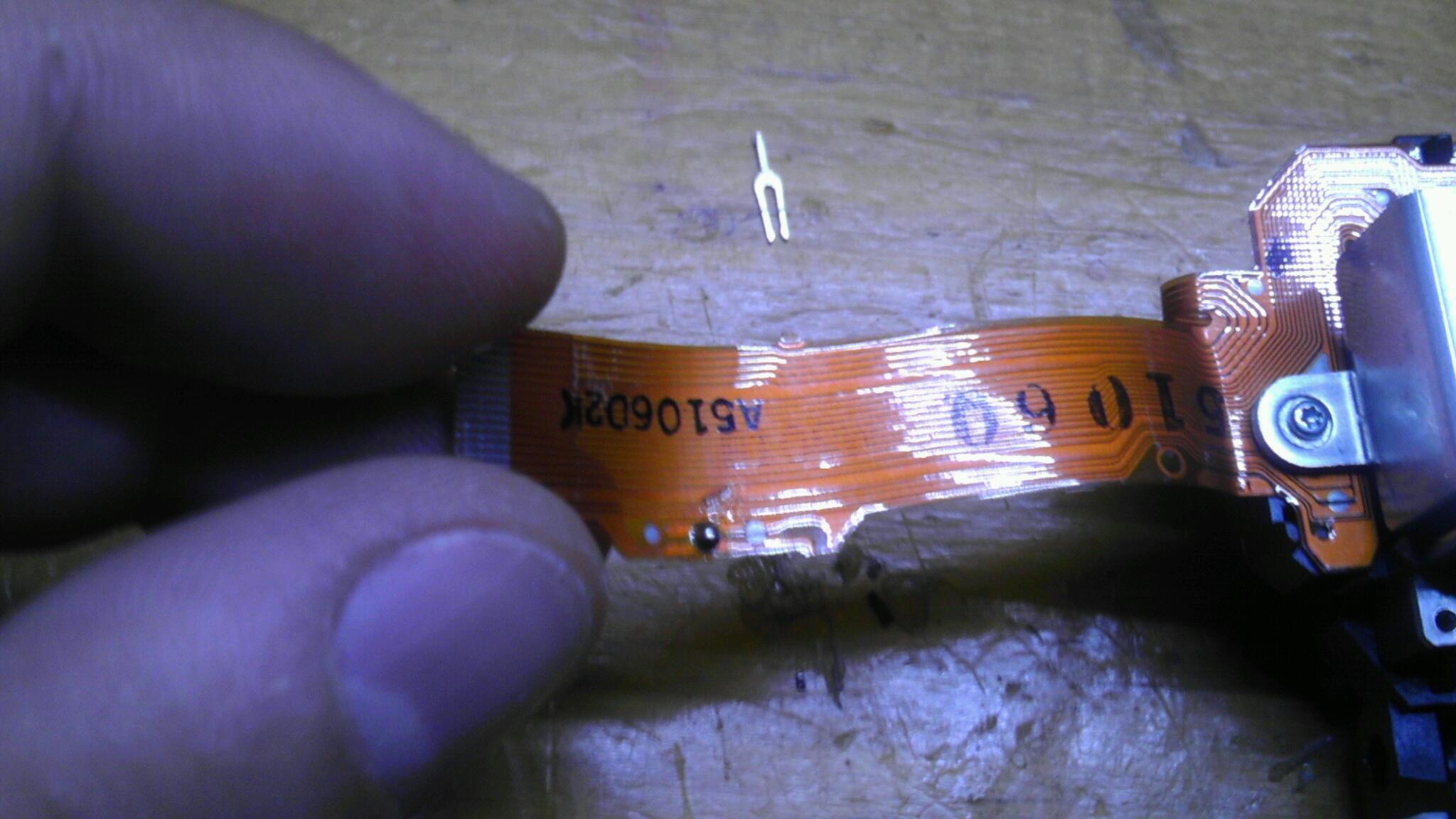

Hi, I recently bought a Gamecube replacement laser and I tried to install it. I'm no noob in these kind of things, I've changed lasers in numerous Xbox and Xbox 360 drives.
Upon first inspection I did not saw any antic-static points soldered on the unit. I could be mistaken because when I try to boot up the GC, the laser emits no beam at all...
I'm asking if usually there are anti-static points soldered on a replacement laser. If yes, where are they located. I checked on the end of the FPC cable near the actual lens (where there are numerous SMD resistors and capacitors) but I did not notice any soldered points that would need desoldering.
Thanks
Need advice on replacing a laser.

Re: Need advice on replacing a laser.
Yes they definitly have an anti-static solder blob. It's toward the other end of the FPC cable about 3/4 of the way down, near the end that plugs into the DVD Drive board.
Thank you I saw it! I took a picture that clearly shows the solder blob to remove. I imagine maybe it could be added in the wiki for future reference. Anyway do what you want with it
- GC Laser Antic-Static point location
- (185.82 KiB) Not downloaded yet
So what is the purpose of the anti-static blob? Is it to prevent harm to the laser from static electricity?
psyko_chewbacca
- Posts: 40
- Joined: Fri Aug 12, 2011 2:36 pm
My guess is that it's for protecting the laser controller chip. By bridging the +V and the GND signal together if a static discharge occur, there wont be any difference of voltage potential on the chip so the static discharge cannot fry the chip.
I culd be mistaken, maybe it's only a way of reassuring the buyer that the laser is new and tested... A little blob of solder was added by a technician, I feel safe!
