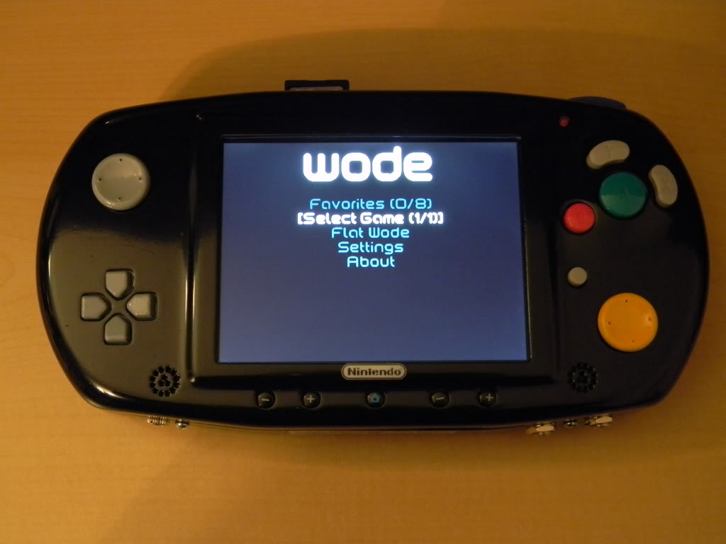

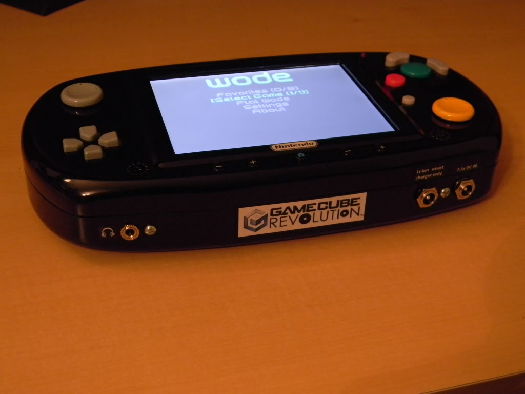

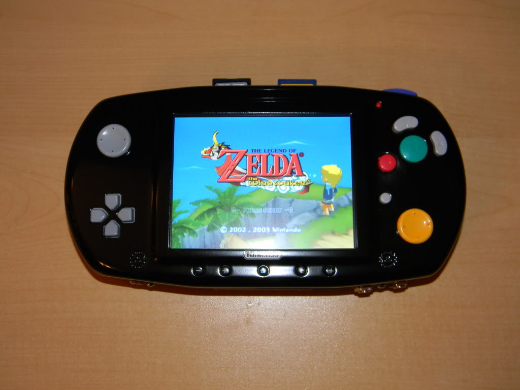

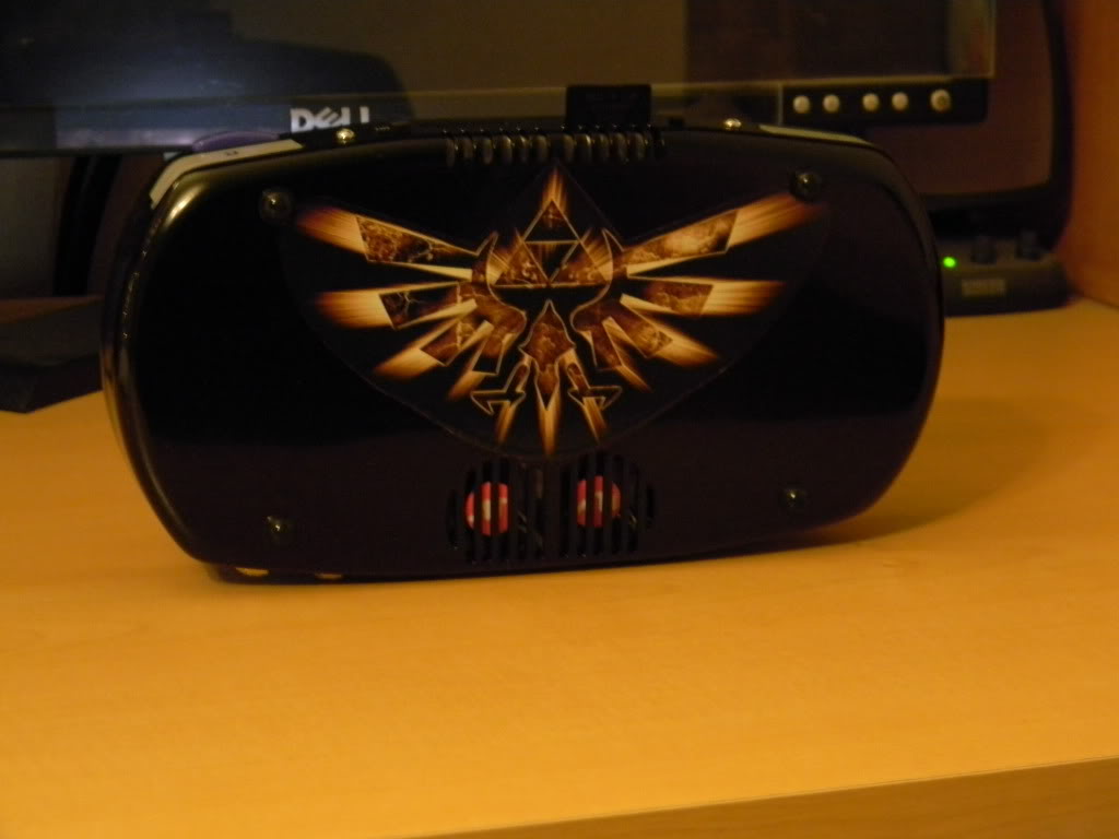

I found it impossible to get a decent pic of this decal, the pic makes it look meh, but it really turned out very nice.

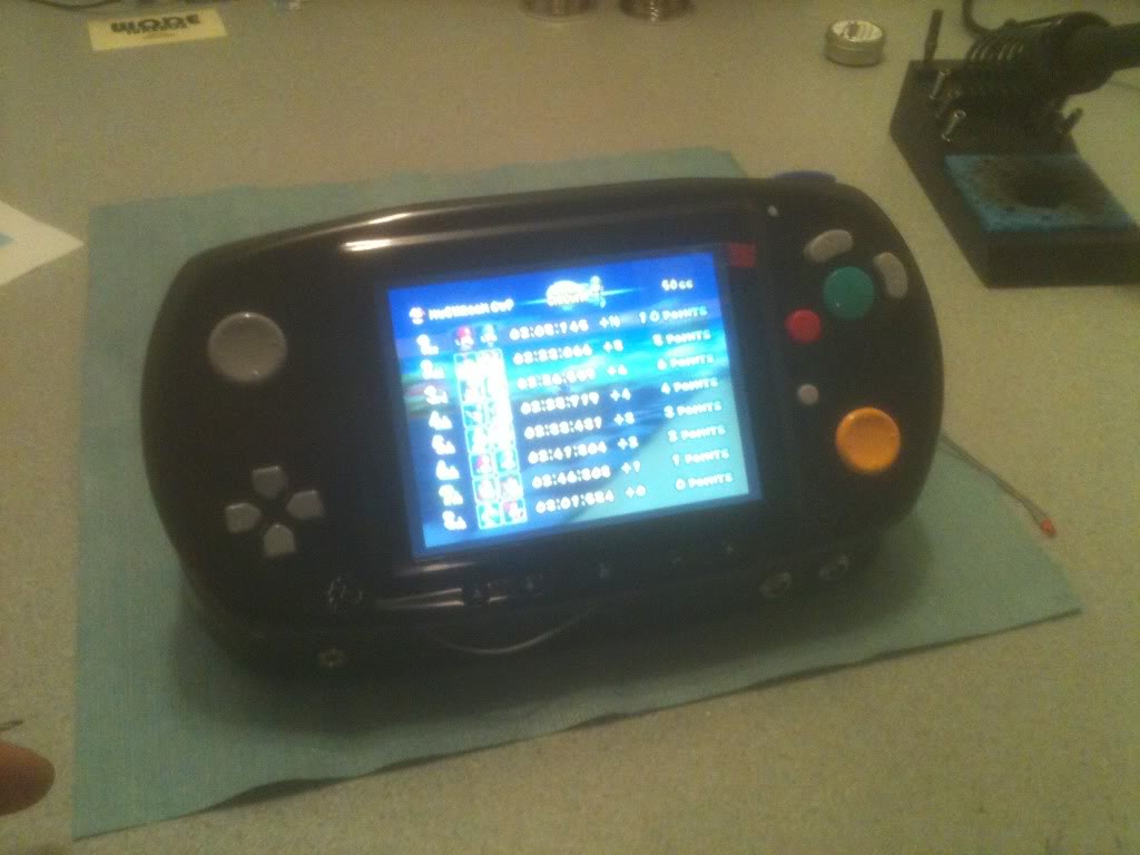

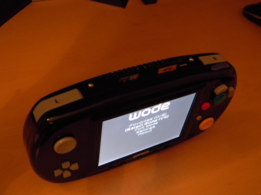

Tried to get a good picture of the image quality on the screen, this one does it semi justice.

Custom Vacuum formed case, slightly frankencased.
Dimensions: L: 9 3/16" H: 4 5/8" W: 1 1/2"
Weight: 1.955 lbs
5" Dalian "Good Screen"
GameCube component cable modded to output VGA (RGBHV) for the best image quality possible on the GameCube (480p)
AlmostWTF cut GameCube motherboard (onboard audio pre-amp retained) + Trimmed official GC heatsink with Lenovo Laptop dual fan @ 3.3v
WODE (severely stripped down) SD Loading only
6x 2600mah Lithium-Ion Batterys (7.4v 7800mah total) = Roughly 3.5 hours playtime. System is wired to "play and charge".
Zenloc's custom regulator: CPU=1.48v GPU=1.69v and 3.35v all regulated separately for maximum battery life.
Official GameCube controller with rumble relocation, Dual iPhone 3GS rumble motors, 3DS analog "sliders", Playstation D-Pad and fully functional L/R "triggers" via the dual tact mod.
Internal 128mb Memory card on slot "A", Internal SD Gecko on slot "B". Save game transfer possible via external adapter.
iPod/iPhone audio amp with DSLite speakers + switching headphone jack.
Mario's low battery indicator circuit. Active @ ~20 minutes left.
100% full of Ashen's blood sweat and tears.
Multi-disc game support via Emu_kid's Swiss: Coming soon

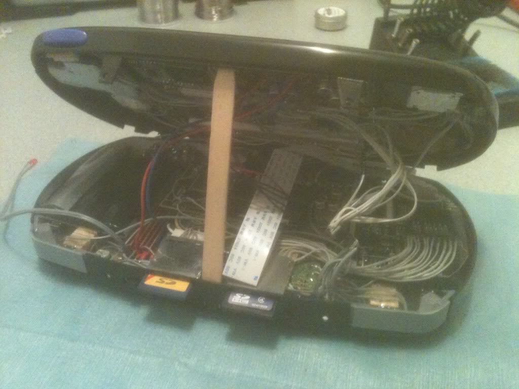

Re: Gamecube Revolution
Post by Ashen » Sun Dec 04, 2011 6:45 am
Crappy quality picture teaser...
Post by megalomaniac » Sun Dec 04, 2011 8:07 am
Haha
Just noticed your L/R shims.
low tech creativity at it's finest.
