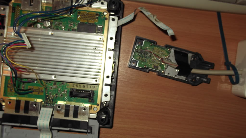

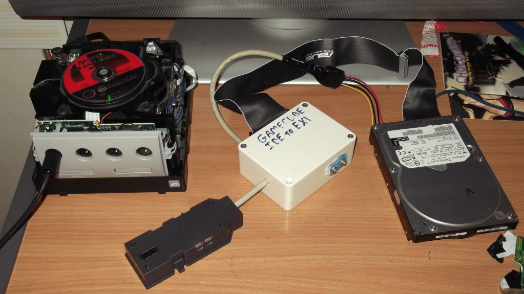

Following the recent arival of my Tri-wing screwdriver I set about working on this project..
To turn my working Memory Card style IDE-EXI into Serial Port 1(BBA) style IDE-EXI
So far I have:-

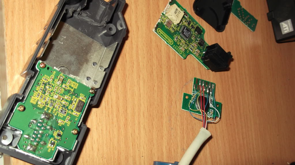

-Snapped off the curcuit of the Modem Adapter leaving enough to hold the connector in place with the original 4 screws
-Dremmeled out some plastic where my wire exits the adapter

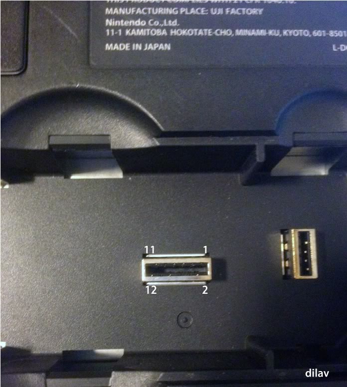

But in relation to my Modem adapter's Circuit, looking down on it in above picture which would be pin 1?
Also I have noticed in memorycard we bridge EXTIN and EXTOUT however in BBA there is no EXTout so this means it will work with no bridge or any other circuitry kept in the Modem side?

my next step is to desolder from my memorycard adapter and switch to these pins in the above YAGCD quote.

For detecting pin 1: Just check which pin goes to GND ;-)

Bridging 1 and 12 on the memory card tells the GC that a memory card is in. Have no clue about the BBA.

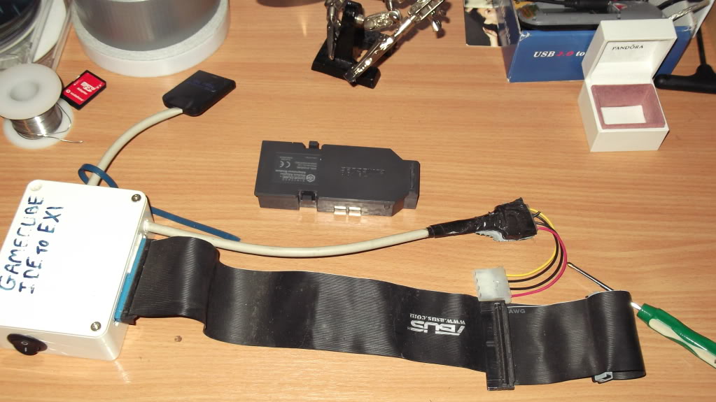

I have soldered the EXI wires up (excluding HDD power lines)

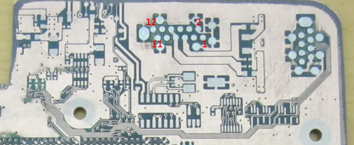

Next, in order to achieve HDD 5v I need to replace a pin trace. Any unused pin is fine baring in mind I also have Qoob Pro Installed here. I plan to replace pin 7(currently unused 3.3v) with 5v.. whats the best way? megalomaniac suggested I cut the trace, can anybody guide me specifically? maybe a pic of a sanded down board could indicate the spot to cut...
After that, adding 5v from a suitable point should be easy, just a wire from GC power pins.
Can anybody confirm on the sense pin EXTIN and suggest what would be a sensible thing to try in order to trick GC into thinking BBA is present?
other than these minor issues, I'm ready to test BBA_IDE-EXI with swiss!

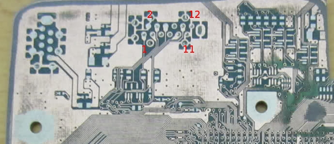

Post by megalomaniac » Thu Mar 08, 2012 11:43 pm
Looking from the top view, pin 7 and 8 are connected together...
it looks like you could cut the trace to pin 8 and be fine soldering a 5v wire to it...
or you might be able to use one of the GND pins 2, 11, 12...

ok!.. all solder'd up and ready!.. or is it?
It looks the part and now my 5v mod seems to have worked as it now powers my Qoob too, as the original fidly job came loose, however I am unsure if I have properly cut the trace between pins 7 & 8.. I can't seem find my multimeter :s
powering the cube with the adapter plugged in shorts the cube out. now how to solve tricking the sense?

Post by megalomaniac » Fri Mar 09, 2012 2:19 am
the qoob should have about a 20k or 30k resistor inline with 5v lead for protection
how to know if your trace cut is successful??
maybe disconnect the 5v lead for now and test the trace cut pin for power using an LED...
...hmmm...then figure out what to do about sense....
