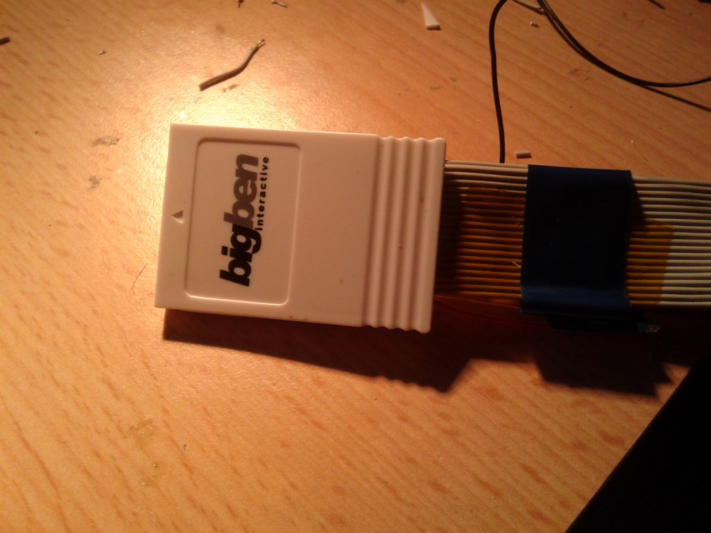

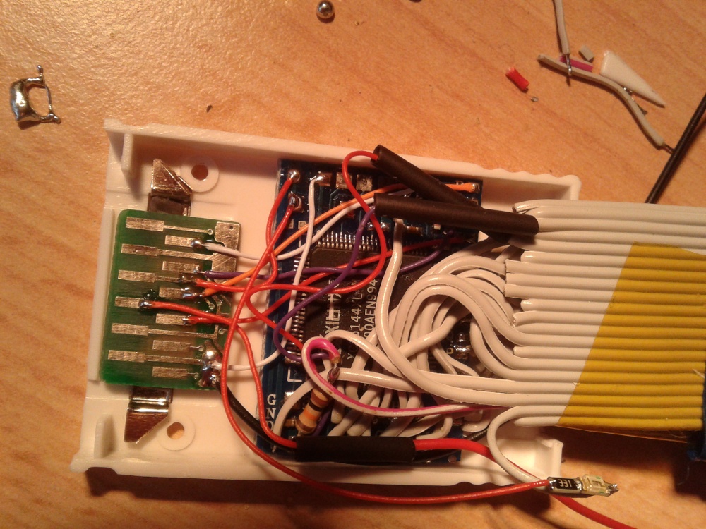

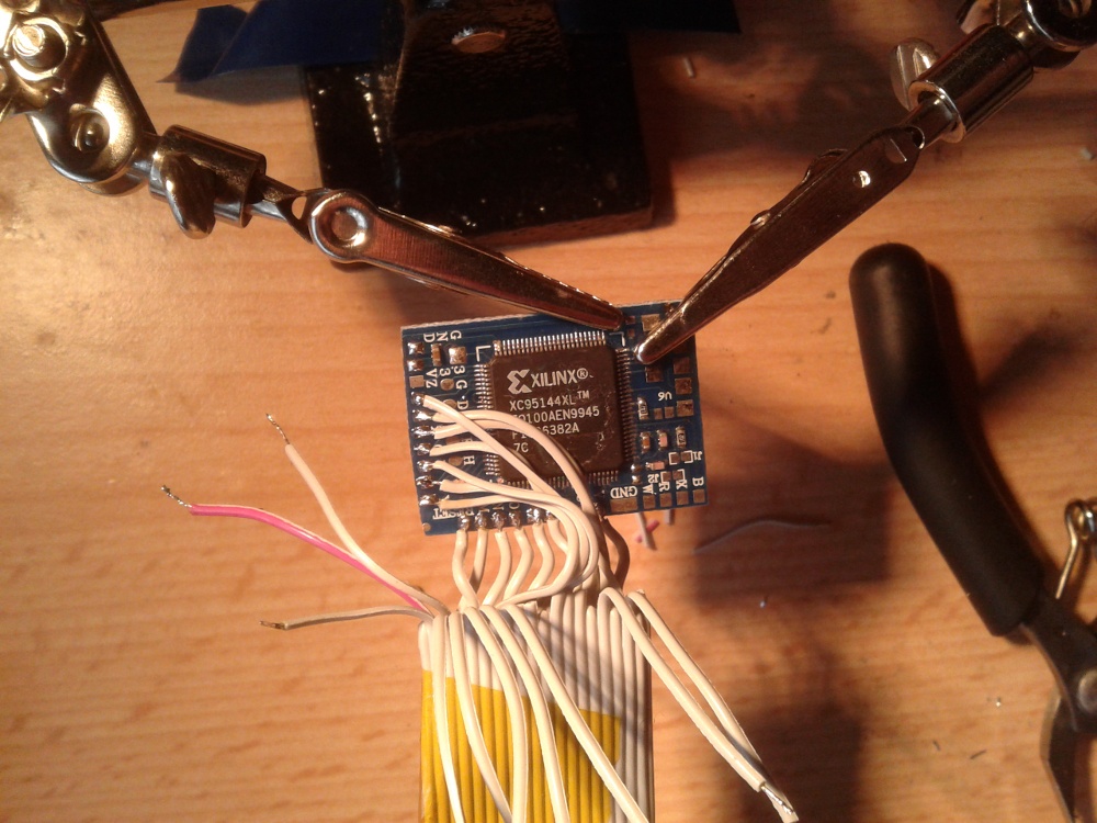

my bluechip arrived today, so i could build my ide-exi today..
I patched it with the Bluechip Firmware from yamaharacer.
Everything seems to be fine at first, swiss shows iso's, patches them and starts them.
The problem is, that after the swiss screen disappears, the hdd isn't in read anymore and the screen stays green...
Tested on PSO 1&2 and Mario Kart DD..
Btw.: How much current can i get from of the EXI 5V line? Atm. I'm using it to power my 2,5" HDD wich takes up to 0.6A..
And here some pics:
Thanks :)

I would say your cables are too long. that could be why the games arent loading. by the way on your bluechip are still parts that have to be desoldered.

_Nold_, you didn't build latest Swiss did you? That might be broken for IDE-EXI v1.

yamaharacer wrote:I would say your cables are too long. that could be why the games arent loading. by the way on your bluechip are still parts that have to be desoldered.
The cable is about 30cm..
Also I checked the parts, seems to be ok, the ones that were connected to the importent lines where removed.
emu_kidid wrote:_Nold_, you didn't build latest Swiss did you? That might be broken for IDE-EXI v1.
I tested it with an older build (with old GUI, about r6X) and 0.2 r94...
Could it maybe be because i've just connected one GND line to the gc's ground? As you can see in the pics i just cut all others, because they are connected in the HDD anyway...
